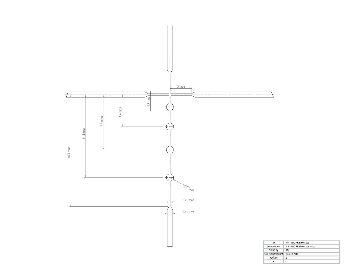

Got a response back from Bushnell just now.
I specifically asked about the 223BDC but the document doesn't seem to specify 223 or 308 - strange.
EDIT: Bushnell have confirmed that these are indeed the 223BDC - .308 is "slightly different".
Bushnell AR Optics 4.5-18x40 223BDC reticle.JPG (45.48 KiB) Viewed 14166 times

Gwion wrote:Probably the same scope with a different badge so that it can be 'matched' to the rifle. IE: marketing ploy.
Edit: strange spacing a on the subtensions, though!
It's a Bullet Drop Compensating reticle so the subtensions get larger with range.
It's pretty close to what I had calculated them to be.
100yd -zero
200yd –1.56MoA (actual 1.7MoA)
300yd –4.11MoA (actual 4.4MoA)
400yd –7.43MoA (actual 7.6MoA)
500yd –11.7MoA (actual 11.4MoA)
600yd –17.17MoA (actual 15.4MoA)

I stick up an A4 (210x297mm) sheet of paper at 100m to get a rough idea of the MoA of the hash marks.
For this particular BDC I used rough BC and velocity figures for NATO ammo which gave me the figures I was using, but I wanted to know exactly what figures Bushnell use for the reticle as I have six of these scopes.
Pretty much all ballistics software uses the same formulas.
This one is pretty simple, but really not set up for metric.
http://www.shooterscalculator.com/ballistic-trajectory-chart.php?t=f630255c
Shoot a load at two distances - I do 50m, 100m, 150m and 200m - and measure the trajectory. It should be pretty close to what the software says, provided the BC and velocity are accurate. If you don't know the velocity and/or BC you can tweak those until you find a curve that matches your test shoot.
https://enoughgun.com/forum/viewtopic.php?f=4&t=6555#p99712

I have the same scope. I mostly leave it set on 10x so I shot a tall target at 10x to find all the subtensions. Here's how they worked out...
