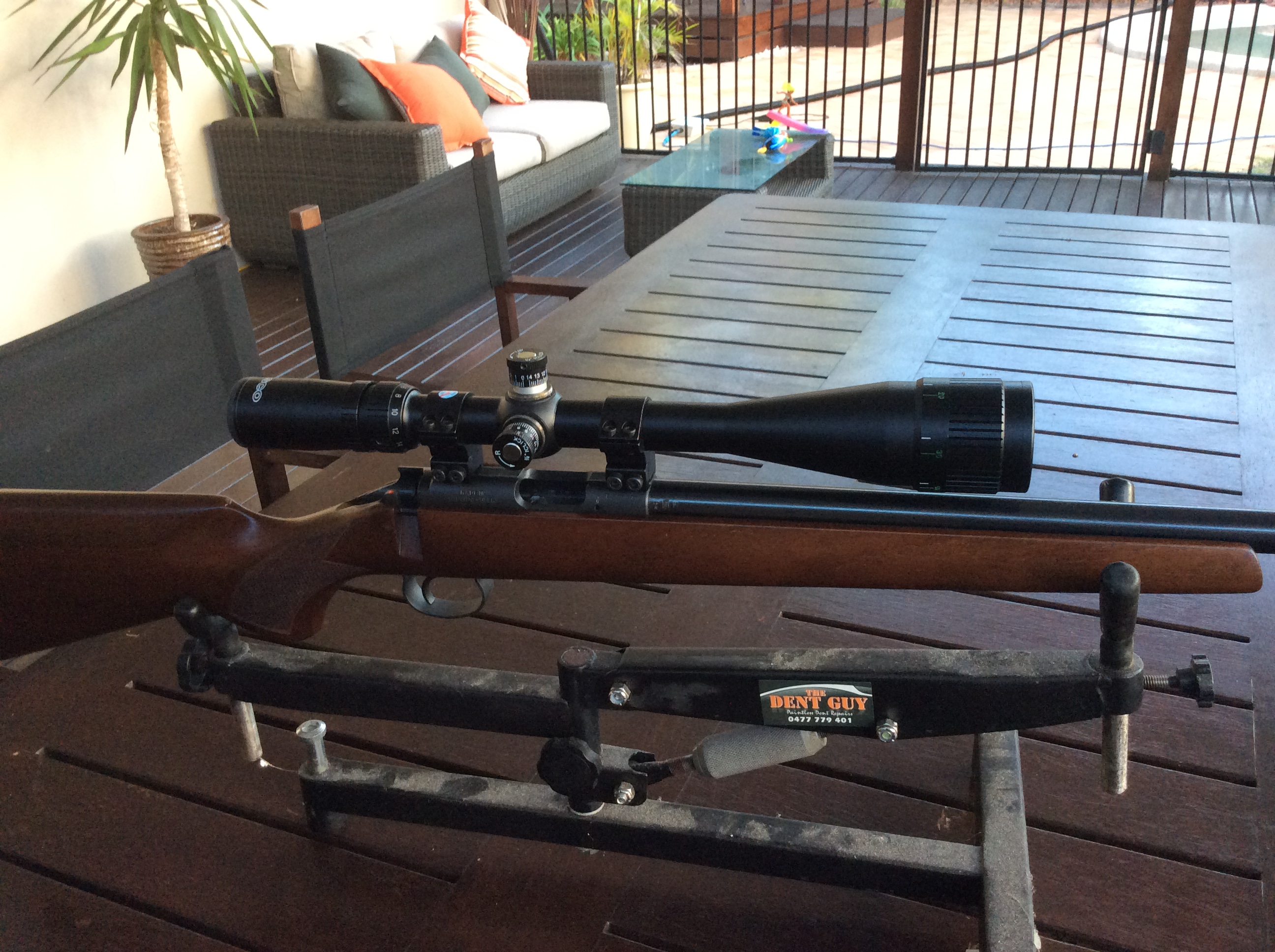

Post by KennyA » 19 Feb 2017, 6:17 am
Update: Scope arrived yesterday afternoon.
My first impressions......s**t it's long
Scope on 6 power
Adjusted rear rectile focus
Adjusted AO to 50 meters
This is super clear and crisp. The crosshairs are nice and fine. I was quite surprised at just how good this scope is.
I then grabbed my CZ which has a Bushnell AR scope mounted. Hmmm no ware near the clarity of the Tasco.
Bushnell AR is now off to eBay.
CZ452 now sporting the new Tasco 6-24x42
.177 &.22 Air rifle, .22lr, 223 Rem, 308 Win, 308 Ackley Imp, 410, 45-70, 12g single, U/O, S/S
KennyA
Posts: 61
