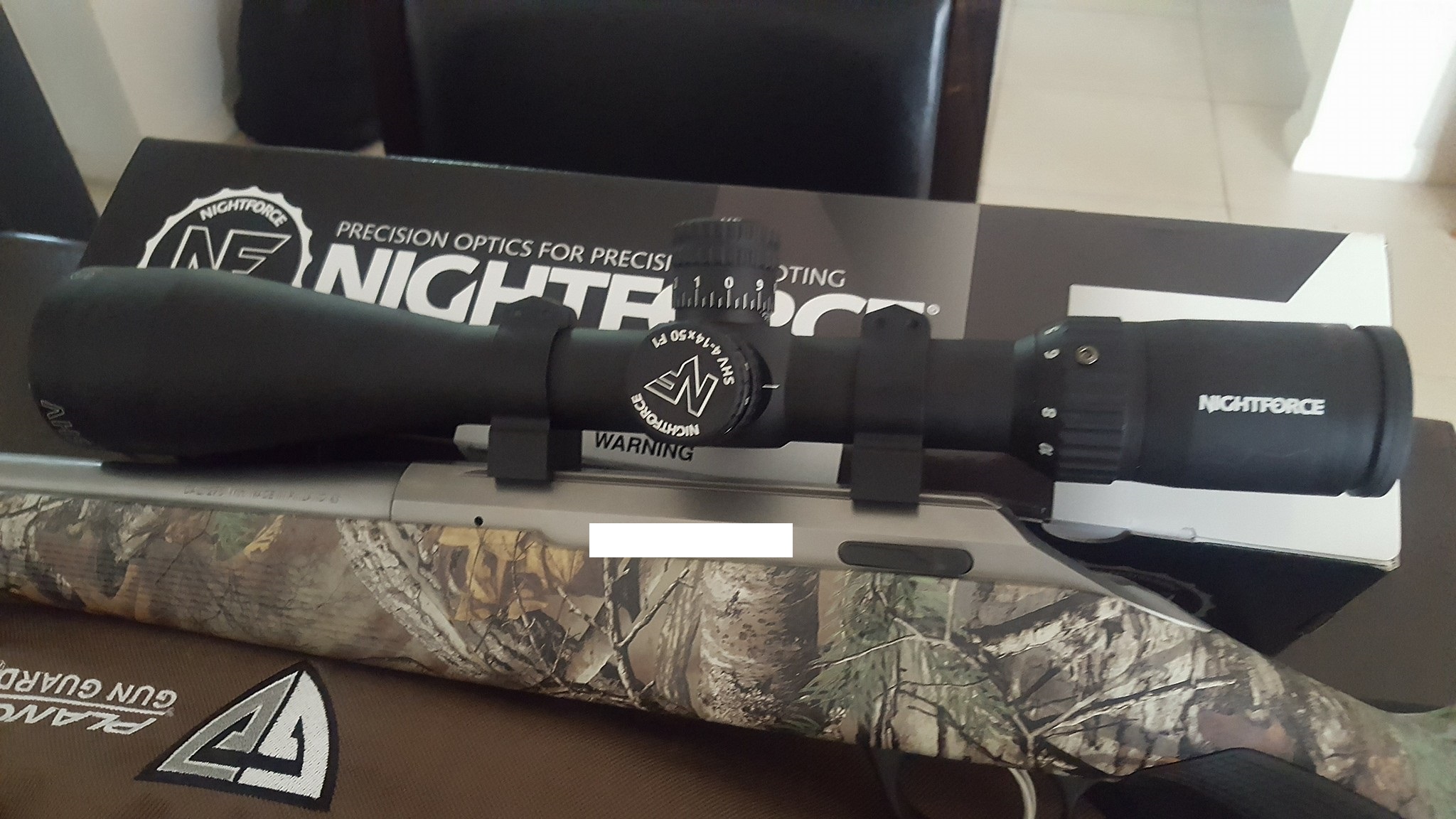

Hey Guys, have a question. I am having trouble getting a good sight picture out of my scope. I have medium rings and no rail on a Tikka .270. The gap between the rifle's barrel would be, at best less than 1/2 a mill.
Would it be best to bring the scope back a little to get it so I am on the money when looking through it. It is a NF SHV 4-12 X 50 FFP scope. My only concern is eye relief and not getting the old scope kiss lol. Or do I attach a 0 MOA rail? Or do I go for the 20MOA rail.
Here is the rifle and scope.

If your problem is that the eye relief is too much, you need to bring the scope back. You'll need higher mounts for that given the lack of clearance you have.
This can be achieved with a rail, but you will need mounts to suit. You only need a 20min rail if you need the extra elevation, i.e. you are at the limit of your adjustment.

Mount the rifle (without scope) in a natural position and have a friend look from the bolt side and put a piece of tape on the stock below where your eye is. look up the scopes eye relief range then measure forward from this mark and that's a rough guide where the ocular lens of the scope should go. usually as you increase the magnification the scope needs to be closer to your eye but you can make small adjustments later on.
also, scope "kiss" from a .270? :lol:
the mounting the rifle without the scope fitted is also a good test for scope height, I see a lot of people mounting their scope as low as possible then struggle to get their head down low enough.

Post by Sam45 » 26 Feb 2017, 5:26 pm
Gamerancher wrote:If your problem is that the eye relief is too much, you need to bring the scope back. You'll need higher mounts for that given the lack of clearance you have.
Yes I read that it was the difference. It has plenty of adjustment.Certainly don't need the extra adjustment for elevation. Thanks for the info.
Chronos wrote:Mount the rifle (without scope) in a natural position and have a friend look from the bolt side and put a piece of tape on the stock below where your eye is. look up the scopes eye relief range then measure forward from this mark and that's a rough guide where the ocular lens of the scope should go. usually as you increase the magnification the scope needs to be closer to your eye but you can make small adjustments later on.
Cheers man. Shall do this and get it sorted ASAP as I'm heading to Dargo in 3 weeks. Will just need to get some different rings and rail.
Thanks guys :thumbsup:

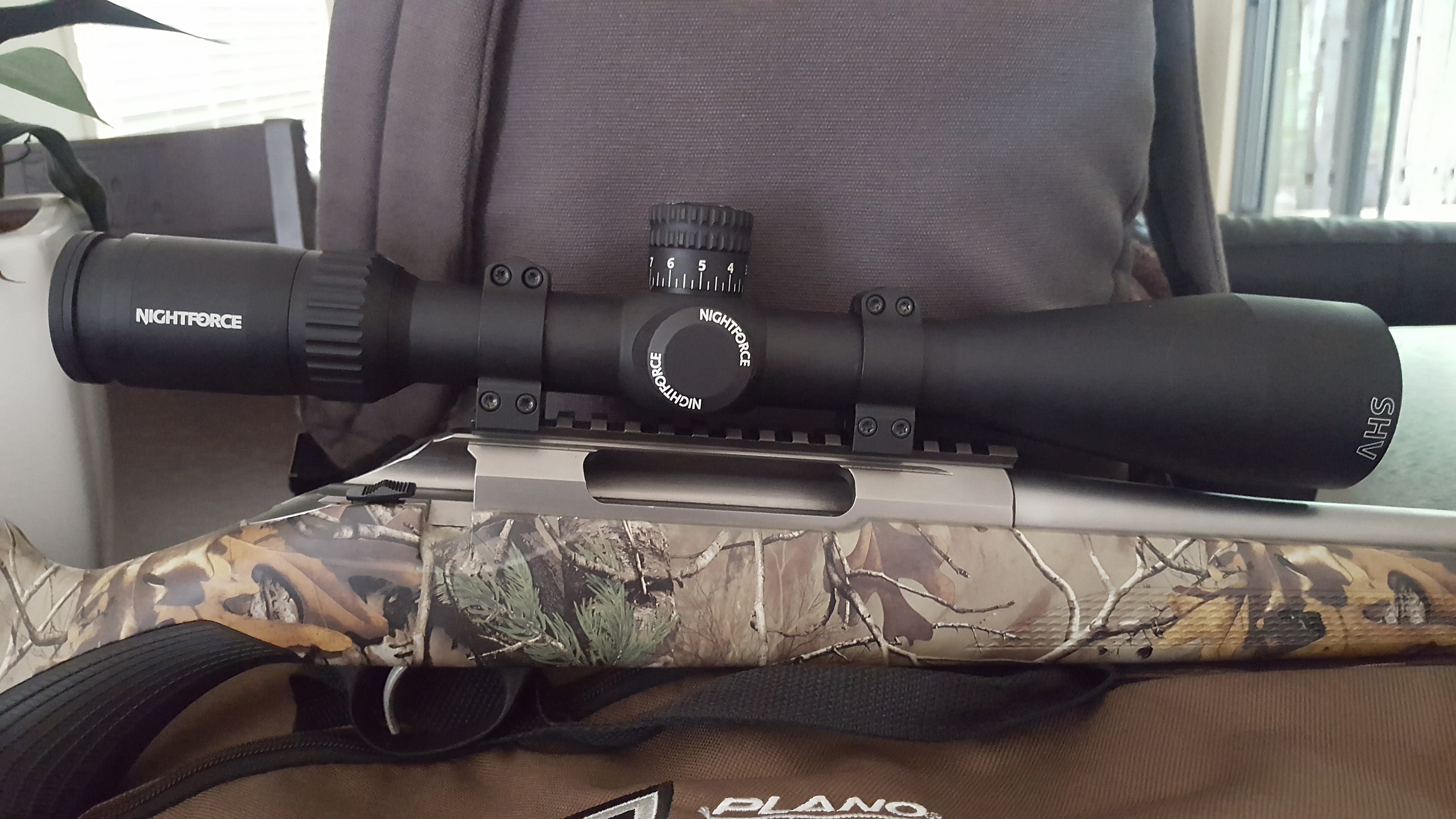

Well boys it's all sorted :clap:
It was eye relief that was the problem. At the LGS tried to move it back, sadly ran out of adjustment. So put on a warne pic rail and warne 30mm low rings. Moved it back and bingo.
Again thanks everyone for the advice and guidance.
Tops effort
Here is the end result.

Post by bigfellascott » 04 Mar 2017, 2:40 pm
Much betterer! :D

Post by Sam45 » 04 Mar 2017, 2:43 pm
bigfellascott wrote:Much betterer! :D
Yep, unreal what a pic rail can do :) Absolutely stoked :thumbsup: Even more excited about hunting Sambar in 2 weeks :drinks:
