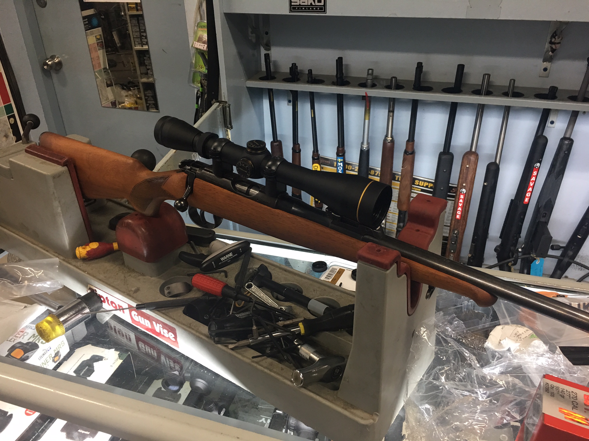

I've just had the scope fitted to my 57 Brno Mod 2 and aim to visit a range in the coming weeks. Is zeroing the scope in at 50m the way to go?
The use of the rifle will be for bunnies/ foxes and some target stuff. Providing the gun likes it the ammunition will be Winchester power-points (40 grain).
See attached pic. Been a 3 month journey getting to this point.

Well I zero for 40m, then I know exactly how many clicks to come up for 60m, 77m and 100m; that's +11,+12,+17 = 40 (using subs). In case you didn't notice that's the rimfire silhouette distances! Does this translate well back into hunting scenarios? yep sure does! I'm very confident to take a head-shot on a bunny anywhere inside 100m provided I'm given a moment to tweak my sights.
But probably the most important point here though is stick to the one ammo type and zero and practice, practice, practice! Then tweaking you sights becomes a no-brainer...
But for purely hunting scenarios IMO a 75 yards zero is better; have a read of this chuckhawks article on the subject matter: http://www.chuckhawks.com/sight_22_75yds.html

That counter in the picture is familiar but the vise is on the wrong side of the shop :) What others haven't mentioned yet is that the 22LR can favour a certain type / brand of ammunition. Buy a few different boxes, test them all and settle on the one with the most consistent sized group before buy in bulk. I'm assuming you'll do some testing at the St Marys range and if that's the case get in touch via PM and I'll come along with my assortment on 22LR ammo you can test with.

My suggestion for sighting was due to the fact that his scope, take a look at the picture of his outfit, does not have target turrets. Using this style of scope, high velocity ammo for the flatter trajectory it offers and not adjusting the scope simplifies the process. There is "target" grade, high velocity ammo available. My reply is based on the K.I.S.S. principle and many a new shooter to silhouette starts with just a basic "hunting" style scope. I have introduced many a new shooter to the sport over the 20+ years that I have been participating in it and this method gets them into it with a standard "rabbit" rifle set-up. Yes, "most" people do "dial-in" for each animal and use sub-sonic target ammo, but then we have scopes that are designed to do so.
