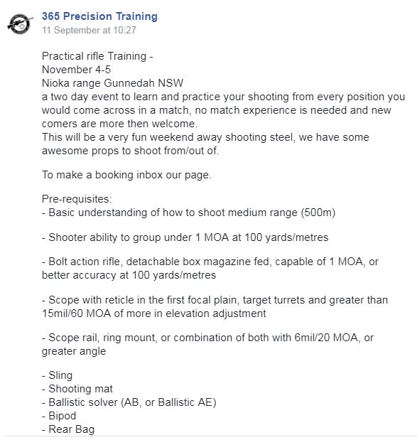

FOU posted a training event for long-range precision shooting, and one of the requirements was a FFP scope. When I asked them why they edited it :-)
Surely nobody looking to shoot long range is going to use an FFP scope?
Mils do have one advantage being simply one-thousandth of the radius, or 100mm at 100m. Makes for easy calculation, but I think MoA is actually simpler and more useful, especially at long-ranges.
Long range FFP.JPG (62.16 KiB) Viewed 8875 times
