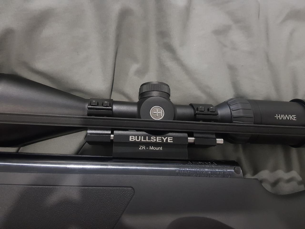

So, for those of you that know me i'm going through my air rifle phase at the moment, went out and bought a new hawke air max scope, taken a few shots to zero at 20m, an air rifle scope should be able to zero at that distance yeah? It's poi is about 5 inchs high and half an inch right and i'm out of adjustment, it was mounted at the local shop by a mate who i trust, on a one peice air rifle specific mount you guys are usually full of awesome suggestions,so any ideas/things to check? I'm going to take it all apart and check but i'm not impressed

Could the dove tail or screw holes on the action be out of whack?

can you load a picture where was the shop roughly bet we can figure this out, west Sydney lol

can you load a picture where was the shop roughly bet we can figure this out, west Sydney lol sounds like the back of the scope is too low

Here we go gents, excuse the crappy photo you know what time it is lol going to take it back to the shop tomorrow and see if they have any suggestions, i'm a little sus on the mount but it seems legit from what i can see, i took it all apart and re installed to a torque so i'll put a few through tomorrow and have a look otherwise a shim at the back?

Hmmm, 5 inches high at 20metres?? I would try putting that mount on the other way around as I think they are a droop compensating mount which is sometimes needed on a break barrel springer. :thumbsup:

T
! when you take the scope off what way does the arrow point

Points to the muzzle, did think about turning it around but then it would change the recoil soaking mechanism the wrong way might try some traditional rings and see it that changes anything

So for anyone interested i went in to the shop, they messed around with it out the back and put some pellets through it, and now all is good, im thinking the poi was high because i was shooting off a wood handrail where i wave it around off hand is where it goes now, i knew springers were hold sensitive but geez!
