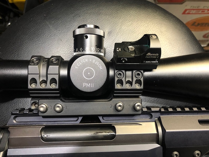

Some pics of my setup on the Hipster...You mainly see this type of setup in the US as it's popular on AR15's used for the 3 gun competitions. Red dot or open sights for the up close targets then switch to scope for the longer range shots. I've got this one zeroed to 25m not that ill actually use it but it's there if needed.

Setting the zero on the red dot was piss easy, Put at 25m, fire a shot then adjust. What I do find it handy for is in locating the target when the main scope is wound up to 50x, saves me having to back off the zoom.
