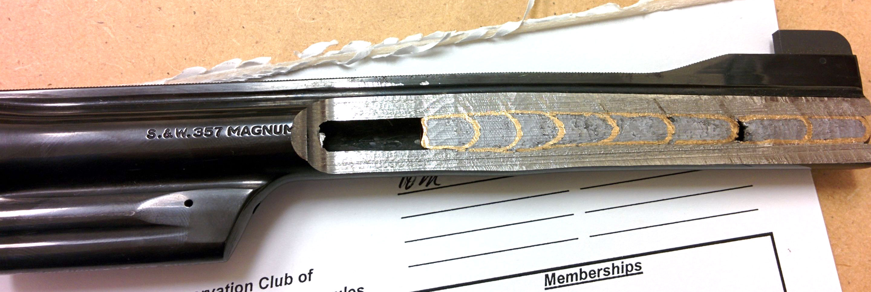

Post by Streamline » 19 Aug 2017, 9:42 am
bladeracer wrote:A double charge will blow a gun, but a no charge or "primer only" can also blow a gun if it sticks a bullet in the bore.
Leading to a bit of this :?

Post by Harper » 29 Aug 2017, 1:14 pm
Has anyone had this happen?
I don't shoot pistols but I just wonder how you could possibly get 8 rounds stuck in a barrel before noticing something's gone awry.

Post by bladeracer » 29 Aug 2017, 1:56 pm
Harper wrote:Has anyone had this happen?
He even reloaded :-)
I would guess very light loads. The first bullet stopped at the muzzle but as the others piled in behind it without bursting the barrel they certainly weren't full-power loads.
Re: Double charging a 9mm pistol round
Post by sungazer » 29 Aug 2017, 2:26 pm
Hes probably lucky still to have hands and a face.
