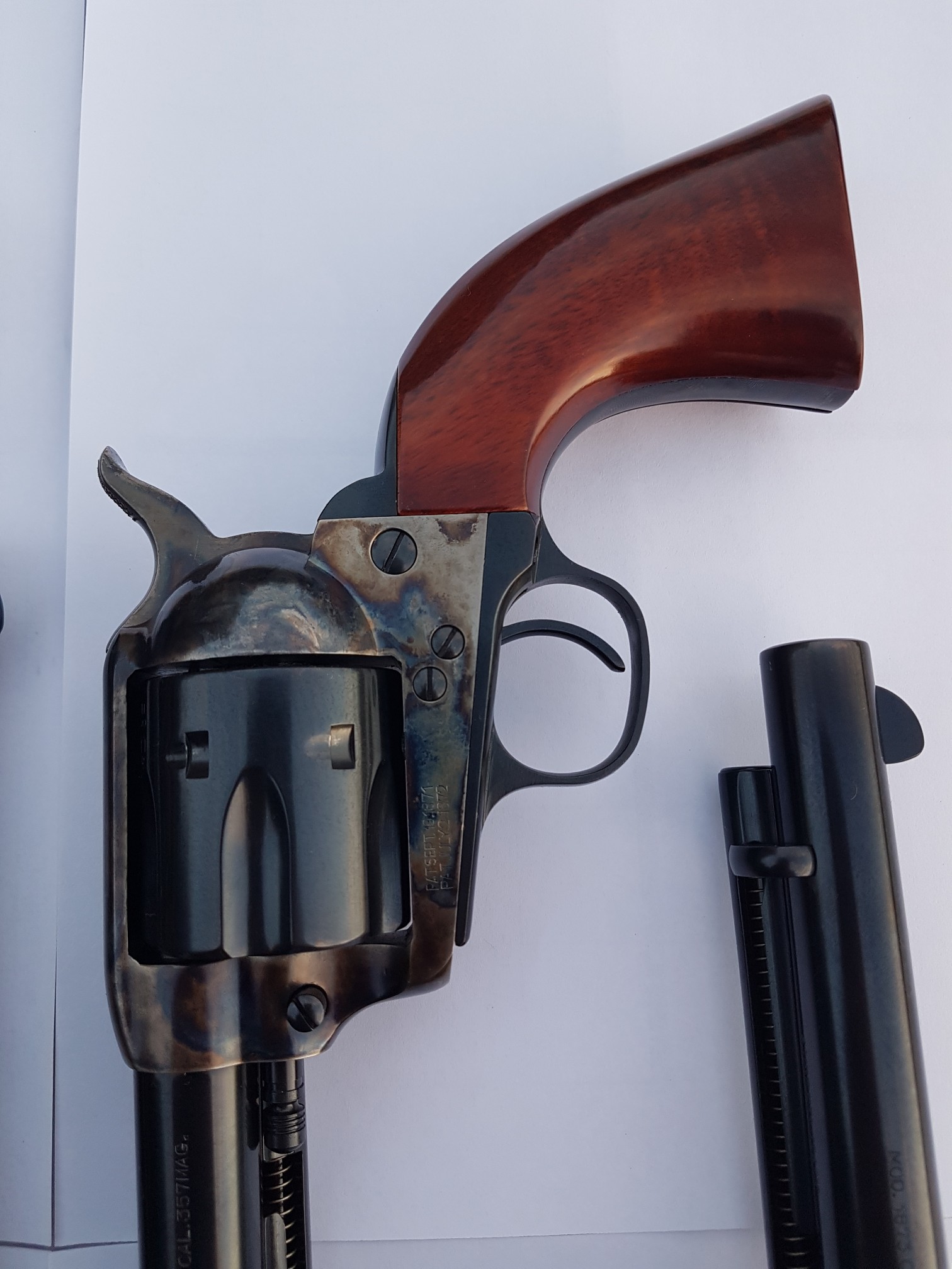

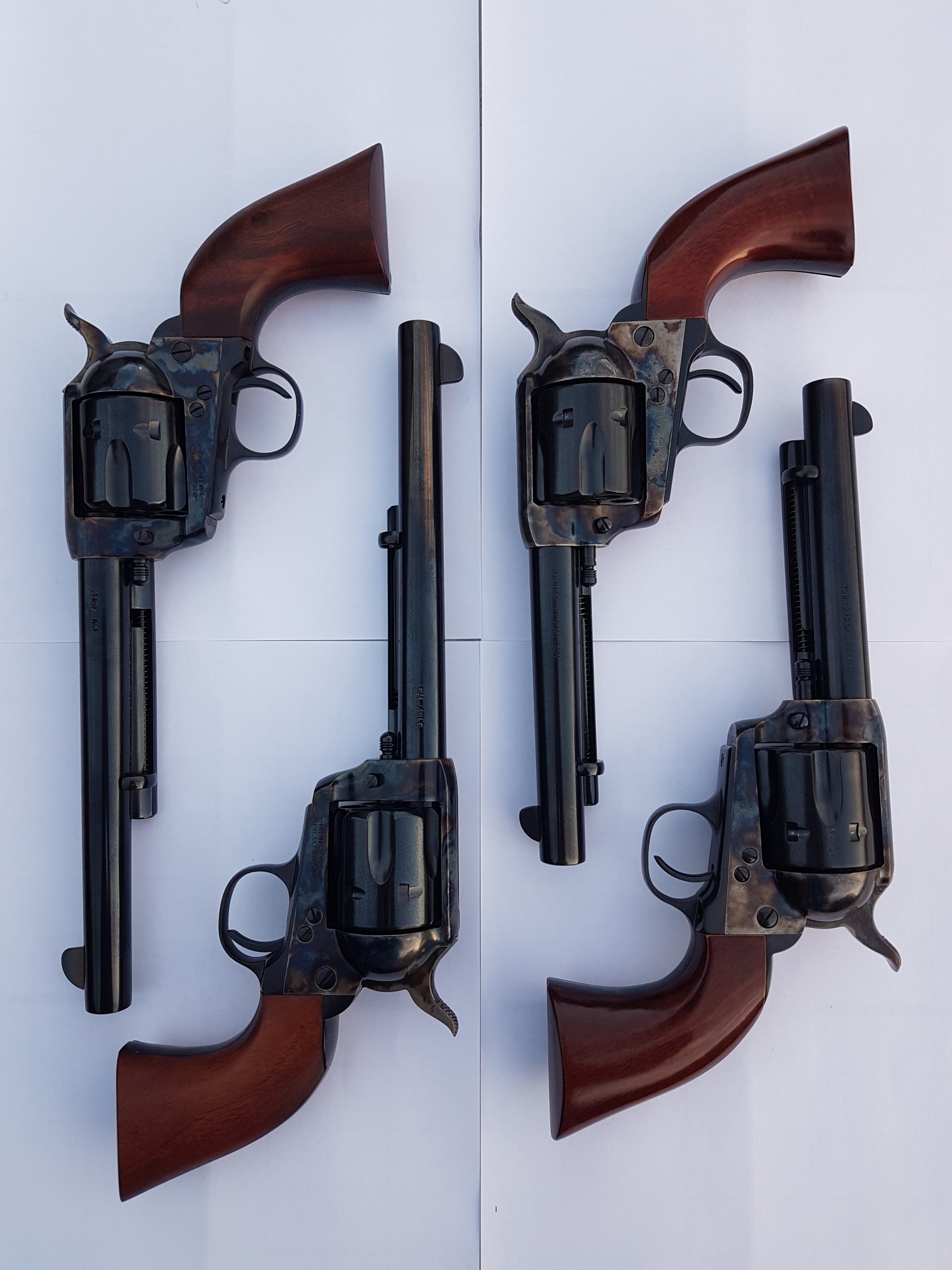

Post by Kelsey Cooter » 01 Aug 2019, 8:02 pm
Hey blokes i bought the pair of piettas. So I thought I'd share a few photos and thoughts on pietta 1873 saa vs uberti cattleman II since I found it so hard to find peoples opinions on pietta when I was seeking info.
When I 1st got my hands on the piettas I thought, oh god I should of bought ubertis, but now I've got to say I'm a big fan. (I think that 1st thought was because of the timber)
The timber on the piettas are not as nice in my opinion. They are oiled instead of varnished, but its not very nice timber so it looks cheap. It feels kind of cheap and nasty to hold compared to uberti, but that could just be because I'm so used to the feel of the uberti timber.
Both piettas are much lighter to cock and the triggers much nicer, but feels kind of tinny (like the parts are made of tin) compared to cocking the ubertis (none of the actions have been worked on). I much prefer the traditional 4 click hammer on the piettas though.
The Pietta ejectors feel way better then the ubertis. I've never liked the ejectors on my ubertis. I went from a ruger blackhawk to the uberti's and have always thought the uberti ejectors feel like they should be on toys.
The base pins that came on the Piettas are the absolute sh#ttest. The are deadset awful to deal with. They don't have a grove all the way around, just a notch that has to be perfectly lined up or they won't say in. I have actually swapped the pins with the uberti pins and have ordered 2 more uberti pins. (I planned on doing this anyway because of the safety notch on the pietta pins)
The ubertis have removable cylinder bushings that feel well made, the piettas do not have removable bushings and the front edge of the bushing is so sharp I can cut my finger on it.
The bluing is pretty much identical on all 4. Maybe the piettas are a touch more glossy but I was really looking hard to try and find a difference.
The case hardening on the pietta is much darker then the uberti. Both are nice. would be interesting to compare in 10 years time.
On paper, both Piettas shot point of aim at 10m with my super light cowboy loads.
Both ubertis shot about 2 inchs low and maybe 2 inches to the right at 10m with my super light cowboy loads.
Overall I've got to say I'm very happy with all of them and at the moment I think they much of a muchness when deciding what to go for. I've owned the uberti's for 6 months and maybe put 600 rounds through them (300 each). And I've had the piettas for a week and put 130 rounds through them on the weekend.

Post by Kelsey Cooter » 01 Aug 2019, 8:07 pm
Pietta 1873 saa 7.5" 45colt
Uberti cattleman II 5.5" 357

Post by Kelsey Cooter » 01 Aug 2019, 8:11 pm
Closer look
Uberti
Pietta

Post by wolfthomas » 20 Aug 2019, 12:24 pm
Glad you enjoyed them. Shame about the wood. Mine had a much darker color that I really liked.
