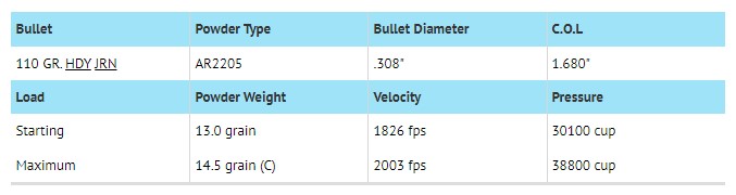

The old ADI reloading manual has the 30 M1 pistol loads for AR2205 in 7 inch barrel .
110 Grain bullet , AR2205
Starting load 13.0 Grains powder , 1,461 FPS , 30,100 cup pressure .
Max load , 14.5 Compressed Grains powder , 1,602 fps , 38,800 cup pressure .

ADI have data listed on the website for 110gn bullets on AR2205.
Screenshot 2023-03-21 182341.jpg (26.05 KiB) Viewed 10052 times
