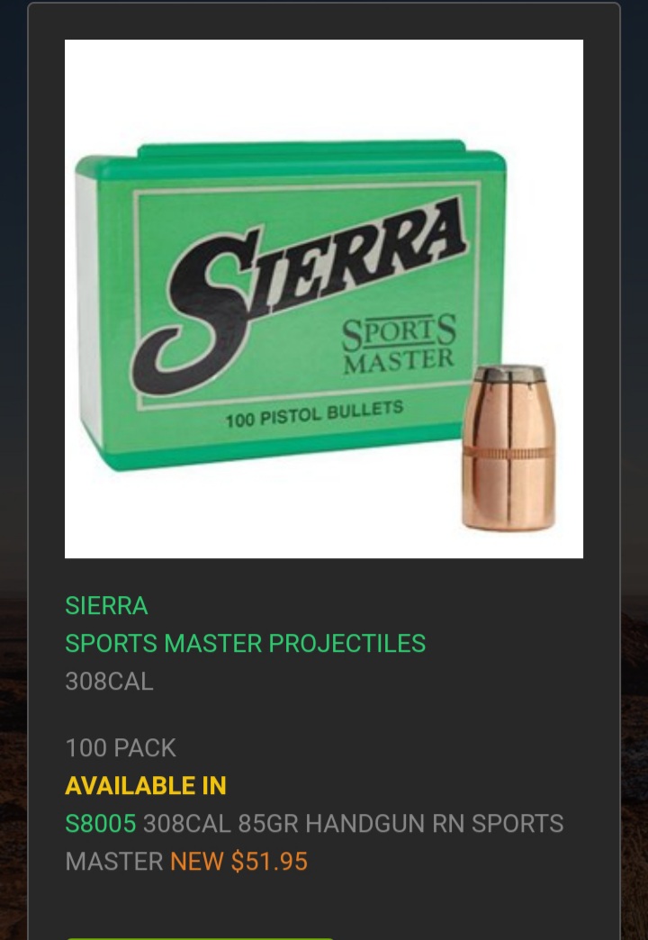

Post by bigpete » 16 Oct 2024, 9:48 am
Gday,I'm on the hunt for some of these if anyone has any to spare ? Cheers
Posts: 4181
Re: Looking For 30 cal pills
Post by bladeracer » 16 Oct 2024, 11:16 am
Projectile Warehouse is now part of Scoped Out. They show the 85gn RN in stock. I can't find a flat point so I think they may have used the wrong picture.
https://www.scopedout.com.au/Sierra-308-85-gr-Round-Nose-SportsMaster-100-Pack

Cheers for that. I find the new website irritating so hadn't looked.

Sierra 30 Cal .308 Diameter 85gr Round Nose, Hand gun use only, #8005
local shop has 3bxs for $47 each

Really !? I might pm you about that
