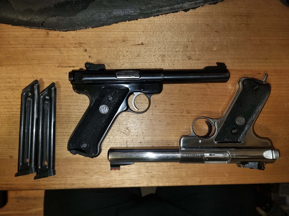

Very nice, Deye243!
I bought a pair of Mk2's off an old member here (thanks Tubs) last year and finally picked them up on Monday. The blued one appears to be entirely untouched. The stainless one is improved - has extended slide lock and mag release, and has grub screws for trigger reset and over-travel. Trigger on the blue one is 2.5lb, the stainless one is 5lb. My mate's Volq Scorpion is 1.7lb. I've shot a Standard match this morning and a 25m match on Wednesday with the blued one so far and Rose's brother shot a Standard match and a 25m match with the stainless one today. I'm hoping next week I'll find time to shoot both off the bench to see how good they each are. The stainless one also has fibre-optic sights which I'm not sure are allowed in ISSF matches.

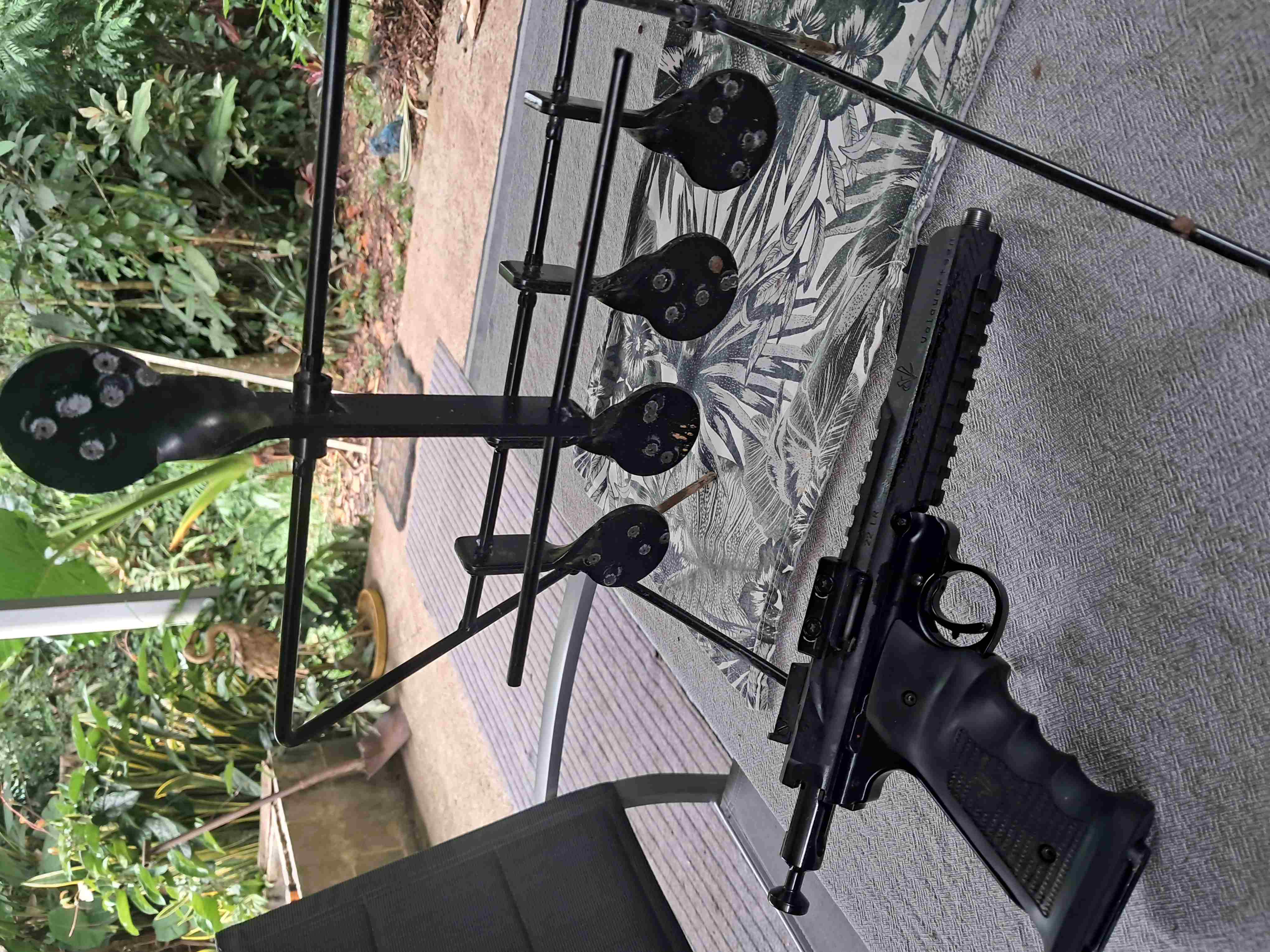

Post by fnq22 » 06 Mar 2026, 2:03 pm
*Interesting info and surprising to see just how much less velocity is produced from the high velocity stuff...big reduction through a pistol huh..!
my Black mamba has been out of action for a couple of months waiting for a new part but it finally came and I really missed just how much fun it is shooting that thing...I have some more steel stuff on order such as a dueling tree and have some animal cut-outs to make up a spinning target as well..... I love plinking at steel...particularly if it resets...
I tried the new 29 dollar spinner out this week and the Mamba doest miss at 15 yards..man it shoots well...thats with semi-auto quiets..*I always grab a couple of bricks when stock of it come in but I use cci standard or Blazer for matches..Quiets wont cycle the gun but semi auto quiets at 100 or so FPS faster do the trick nicely..
