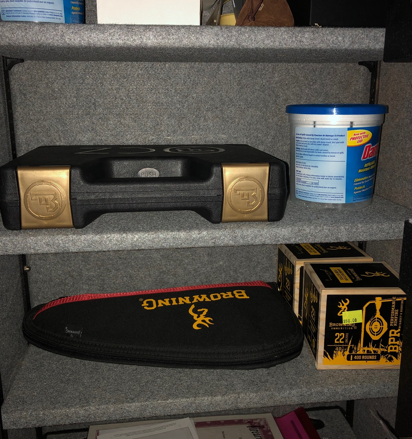

Post by Grumpy » 19 Nov 2018, 8:03 pm
My CZ & Browning Buckmark using the optional shelves. They rate this as a 6-8 gun safe, so I’m not sure a 4 gun safe would be wide enough.
http://lokawaysafe.com/products/gun-saf ... -safe.html
Ps: the ammo boxes are empty & just for reference.
Grumpy
Posts: 48

Post by Zappa » 19 Nov 2018, 8:18 pm
zhuk wrote: I also keep a printout of the safe storage regs pdf in my ammo cabinet, for reference..
And here I am thinking i was a bit over exuberant doing this as well. It's called CYA in case the inspection officer raises questions.
Grumpy wrote:My CZ & Browning Buckmark using the optional shelves. They rate this as a 6-8 gun safe, so I’m not sure a 4 gun safe would be wide enough.
hmm.. looking at the spec on the LOK2K is has the body at 14 gauge and door at 12 gauge. Isnt that 1.6mm and 2mm respectively ? :wtf:

Post by Grumpy » 19 Nov 2018, 8:54 pm
Compliant with W.A. regs.
