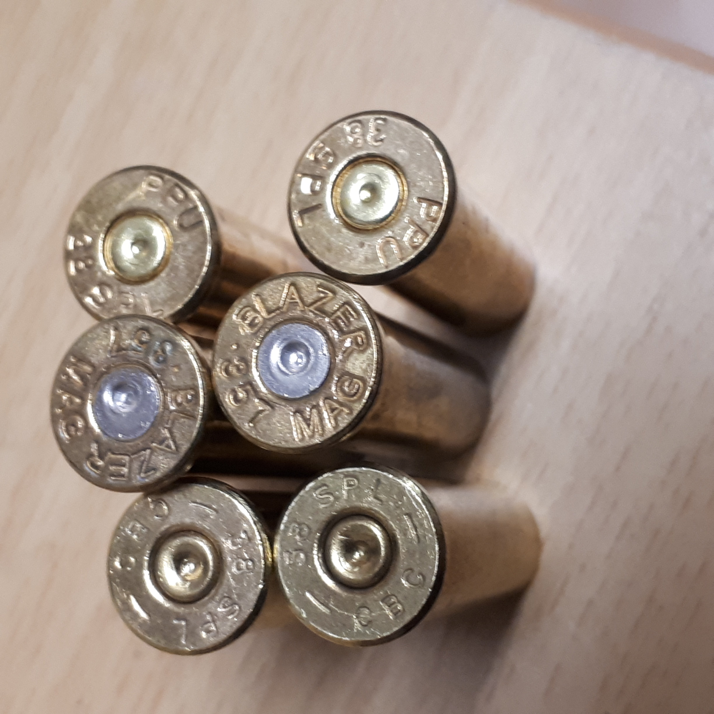

Hi, I recently acquired a S&W model 19 in .357. My first revolver, so I've been shooting.38 special ammo for the first couple of times at the range, just to get used to it. I recently tried some Blazer .357 158gn JHP on it. It shoot fine, but when I had a look at the cases the primers were flattened quite a bit. You can see it in the picture, compared to some .38 cases
38 and 357.jpg (1.37 MiB) Viewed 6375 times
Obviously .357 has a lot more power, but should I be getting flattened primers like that? Is that normal?

Primers are a very random indicator of pressures. It could just be a very soft cup.

357 Magnum primers often look like that in my experience.
I think I have some Blazer Brass 357 Mag, if I do I'll shoot some this weekend and see what I get.

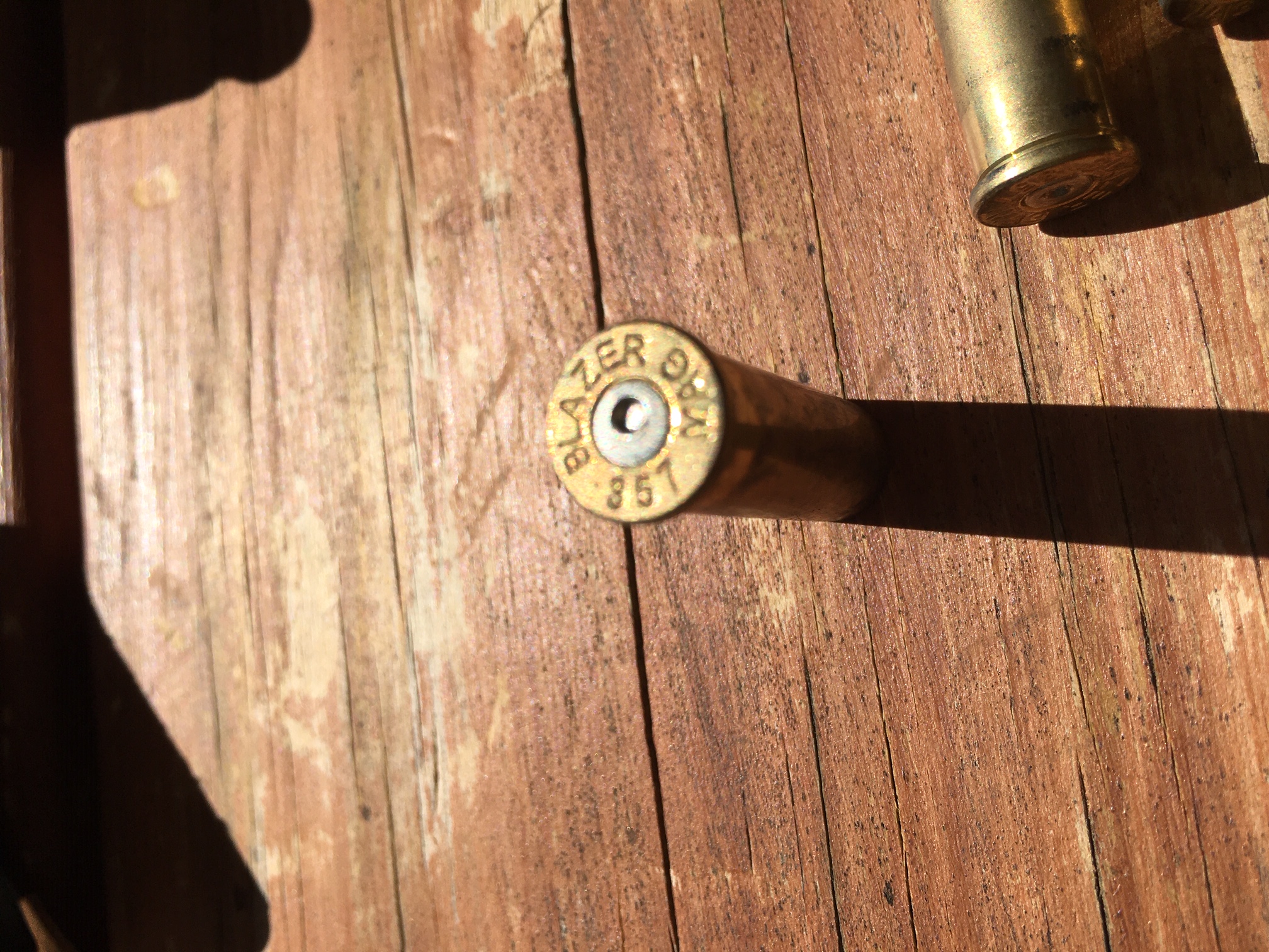

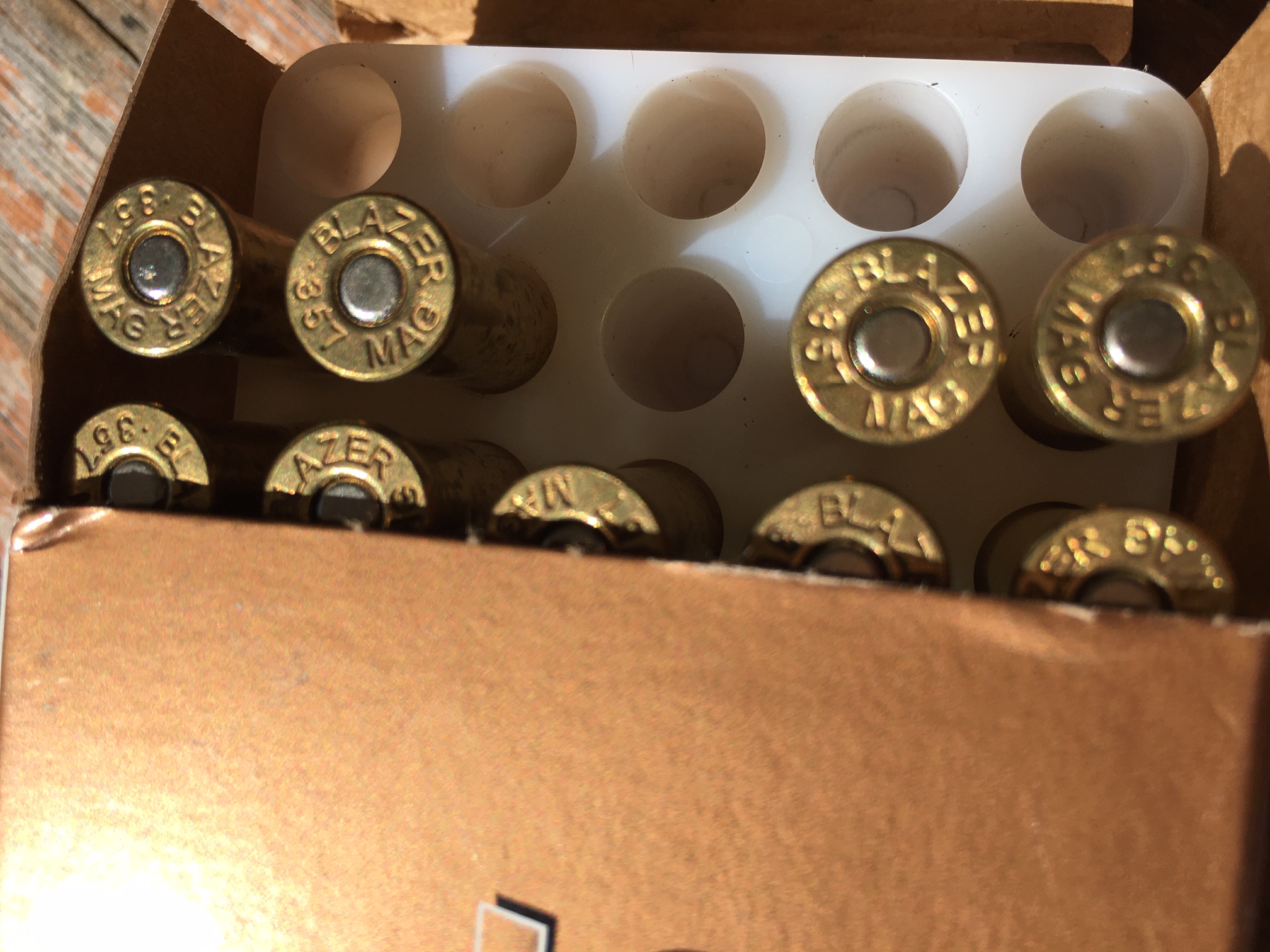

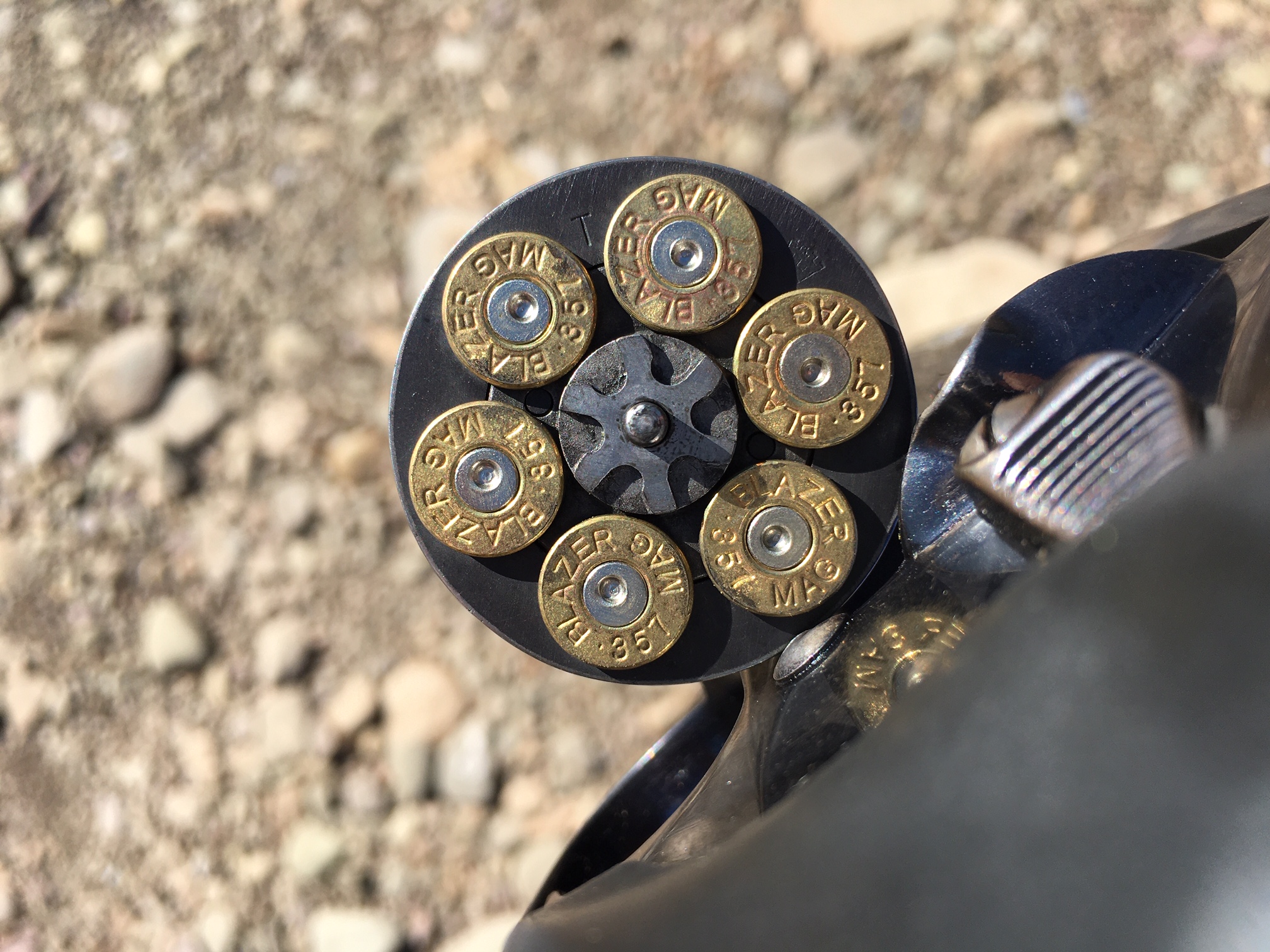

I looked in my arsenal and found a few newish boxes of Blazer Brass 158g JHP 357 Magnum so I took that up on the mountain today to shoot some and here are the results. Looks the same as yours. Nice early spring day, just had snow on Friday but today the temp shot up to about 14C or so with clear blue skies and sun. So time to get a fire going and make some lunch at the fire pit at the range.

Post by Gamerancher » 09 Mar 2020, 9:24 am
I think you will find it is just very soft primer cups.

wanneroo wrote:I looked in my arsenal and found a few newish boxes of Blazer Brass 158g JHP 357 Magnum so I took that up on the mountain today to shoot some and here are the results. Looks the same as yours. Nice early spring day, just had snow on Friday but today the temp shot up to about 14C or so with clear blue skies and sun. So time to get a fire going and make some lunch at the fire pit at the range.
Wow, thanks a lot Wanneroo! I'm guessing they are just soft primers after all. Also I'm very jealous of your snow. It was a 30C here today, which is pretty mild temperatures here in the Central Queensland autumn!

Post by wanneroo » 10 Mar 2020, 12:45 am
fenderstrat wrote:Wow, thanks a lot Wanneroo! I'm guessing they are just soft primers after all. Also I'm very jealous of your snow. It was a 30C here today, which is pretty mild temperatures here in the Central Queensland autumn!
Yep I just think it's soft primers and nothing really to worry about, hope that helped out. We are getting an early spring but probably good with the coronapanic going on, however often we can get some big snow storms in March and into April.

I haven't tried the Blazer .357 yet but the PPU .357 SJHP is the hottest factory ammunition that I've come across so far in that caliber.
Might be a better comparison to use with the PPU 38 Specials
