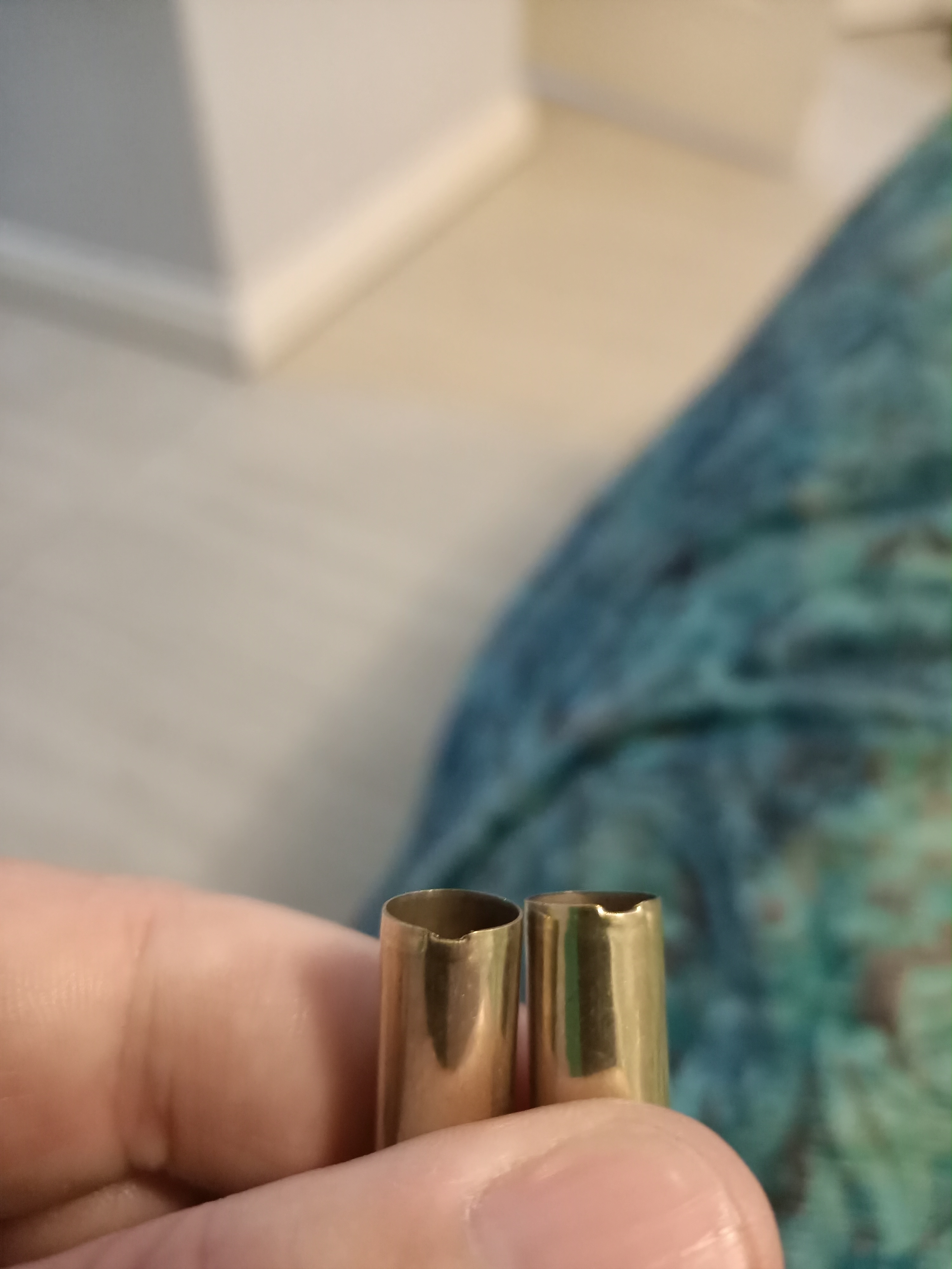

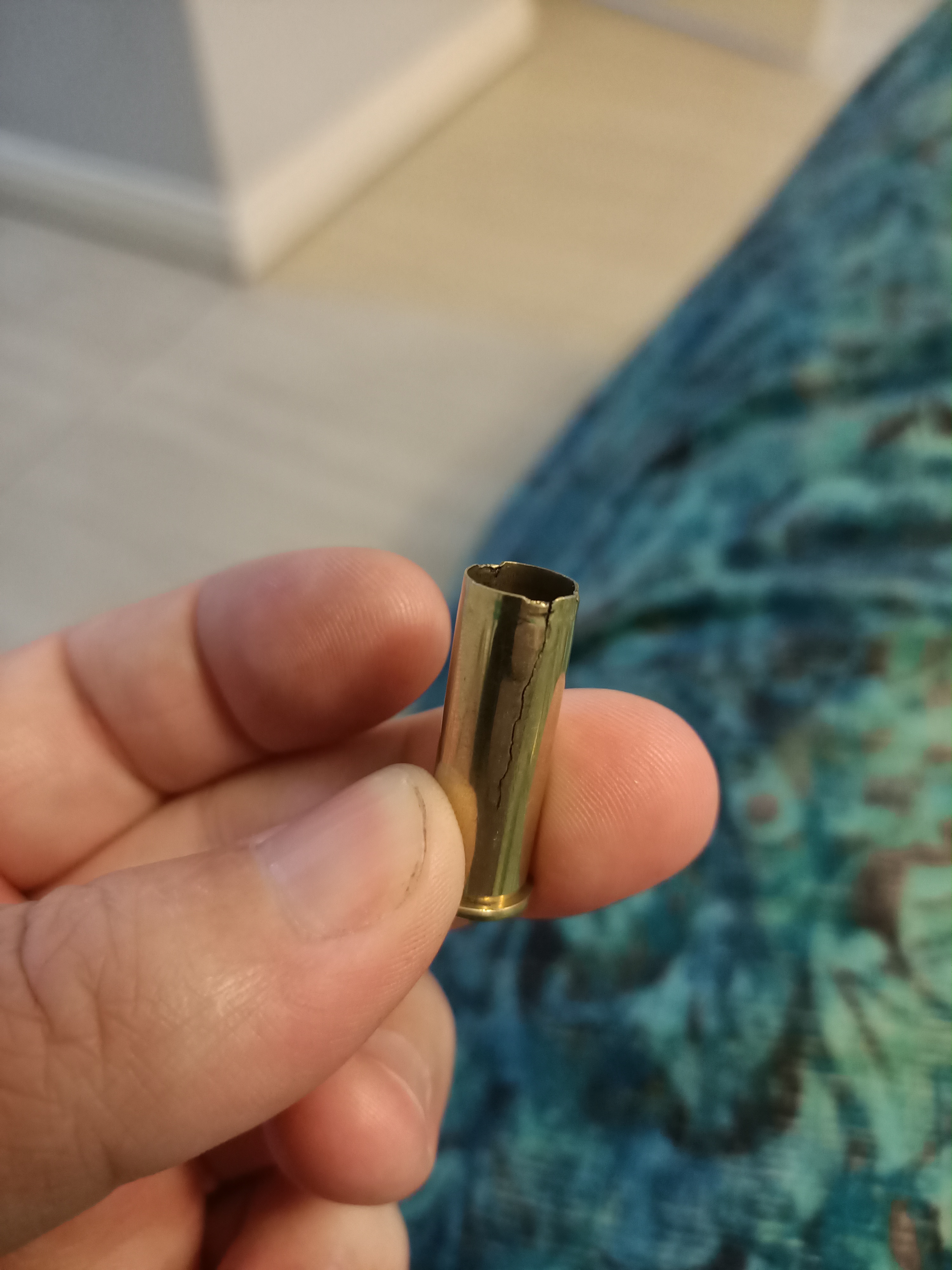

Hey guys, i was shooting my S/W 686 .357 last week and had some troubles with a few rounds. I reload my own .38 special and use those, i had one case split completely and a few more that showed dents to the tip. I read up that the dents can happen with semi's due to the ejector, but what is causing it with my revolver? Would they still be safe to reload, guessing the brass will go back to correct size while i'm reloading it but wanted to make sure. Anything i can do or focus on to stop the splits or the dents? I've attached two pictures to show what i mean.

The split casing
38 splitbend2.jpg (2.52 MiB) Viewed 5048 times

The dented casings
38 splitbend.jpg (1.6 MiB) Viewed 5048 times

In order to deform outwards there must be a cavity of some sort for the brass to expand into, splitting is generally caused by the brass expanding too far before reaching the chamber wall when the huge detonation pressure goes off inside it.
Old brass can split in a normal chamber if its been re-used too many times as the cycling makes it more brittle but that dent really does seem to indicate that there is a chamber problem.

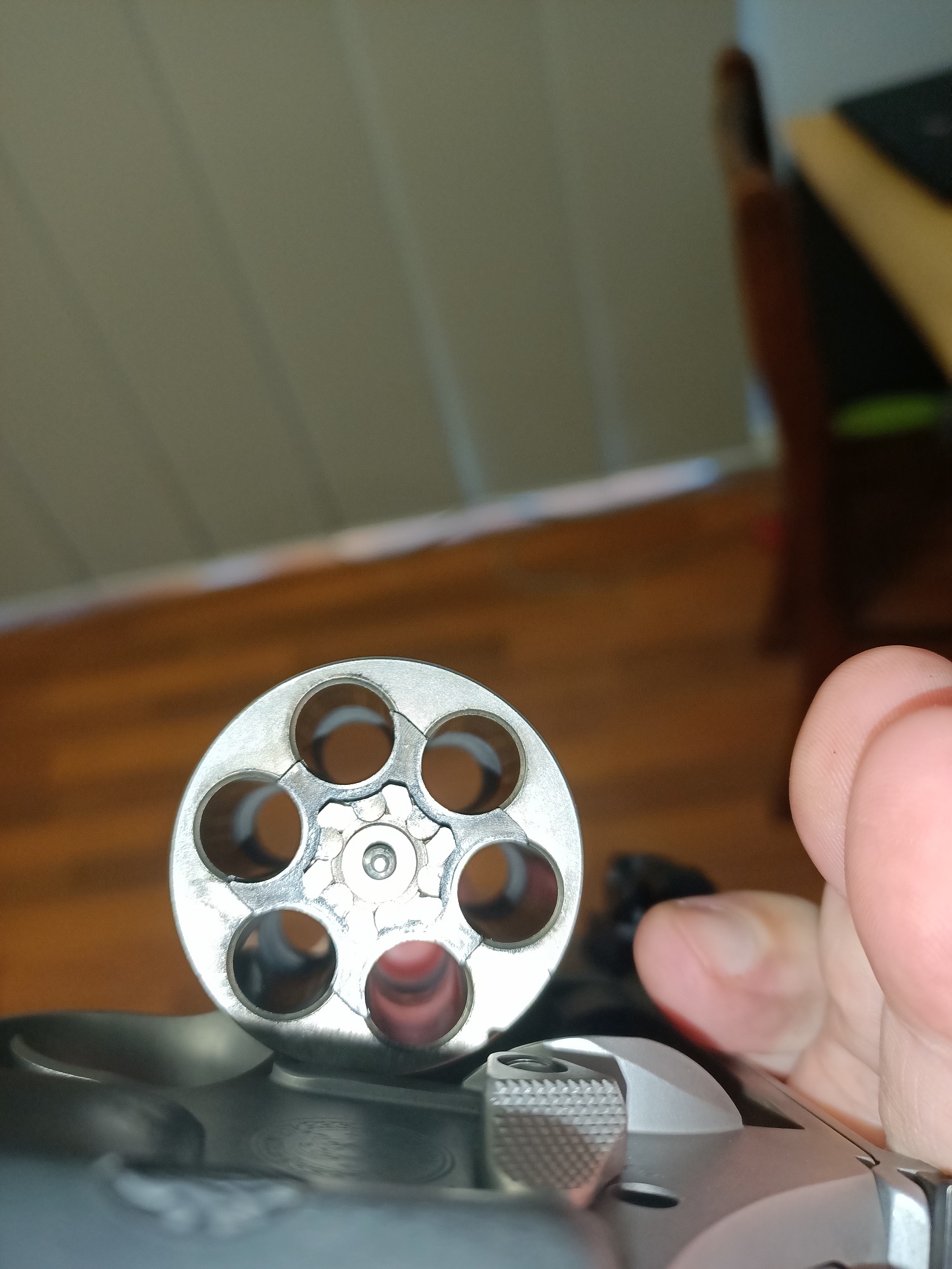

Never seen that before. Weird. Would love to see some good close up pics of the condition of the inside of the cylinders ( ubviously from front of cylinder)

Welcome to the forum. I have had dents exactly like yours as a result of insufficient case flare during reloading and also from too much flare causing the seating die to gouge the case mouth. The split case is a consequence of the dent from where it propagated. Have you carefully checked all your reloads for case mouth damage, it does not need much to cause the problem I see. Another possibility would be a carbon build up in one or more chambers, this should be easy to see with a torch and a magnifying glass. It is a common problem with constant use of 38spl in a 357mag, and one of my Pythons wouldn't accept 357 rounds after a few months of 38's and needed the chambers scrubbed with a stainless brush and carbon solvent. If all looks good with your ammo, and you can't see any defect in your cylinders, then a visit to a revolver experienced gunsmitth is your next step, Cheers.

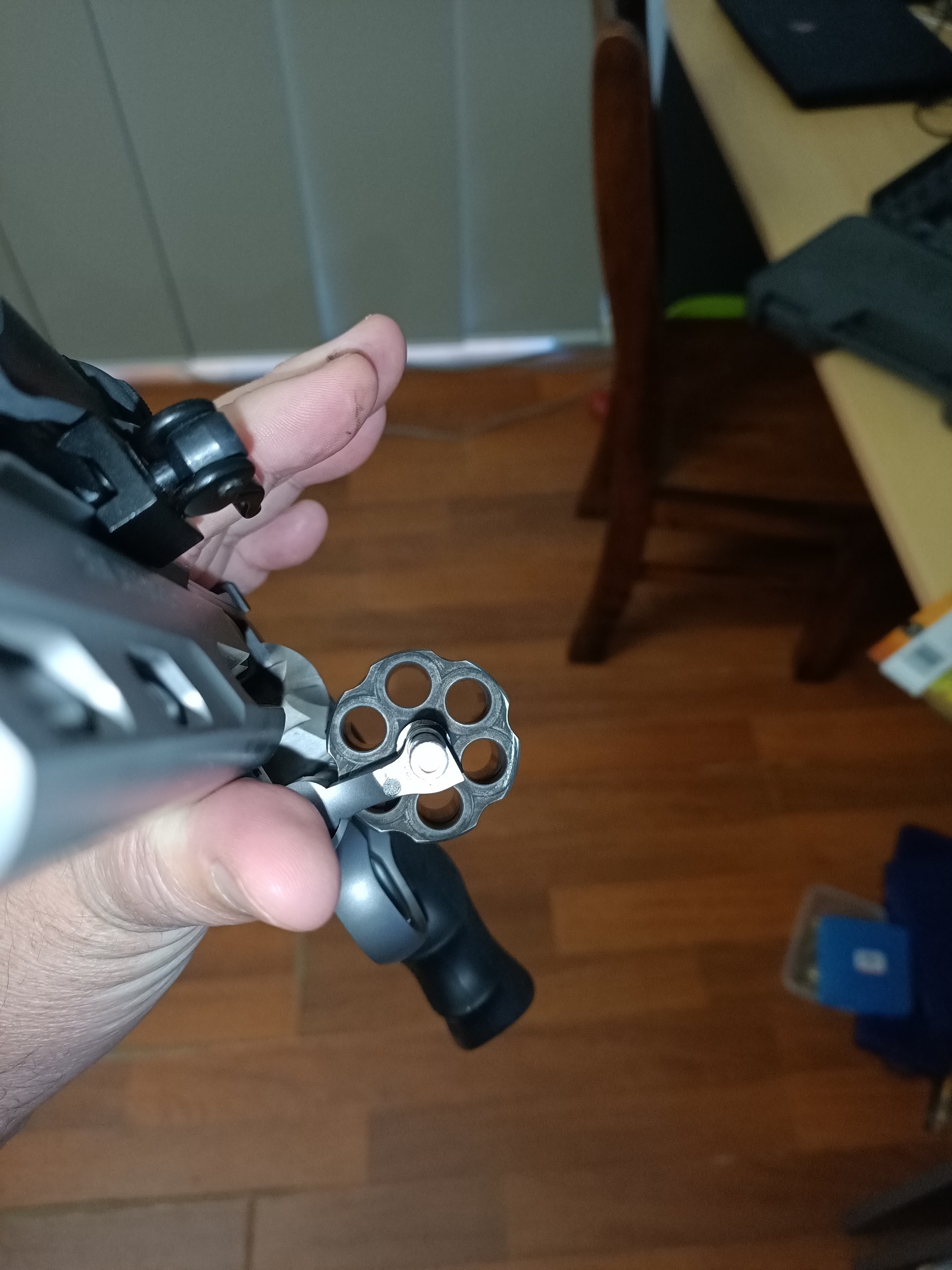

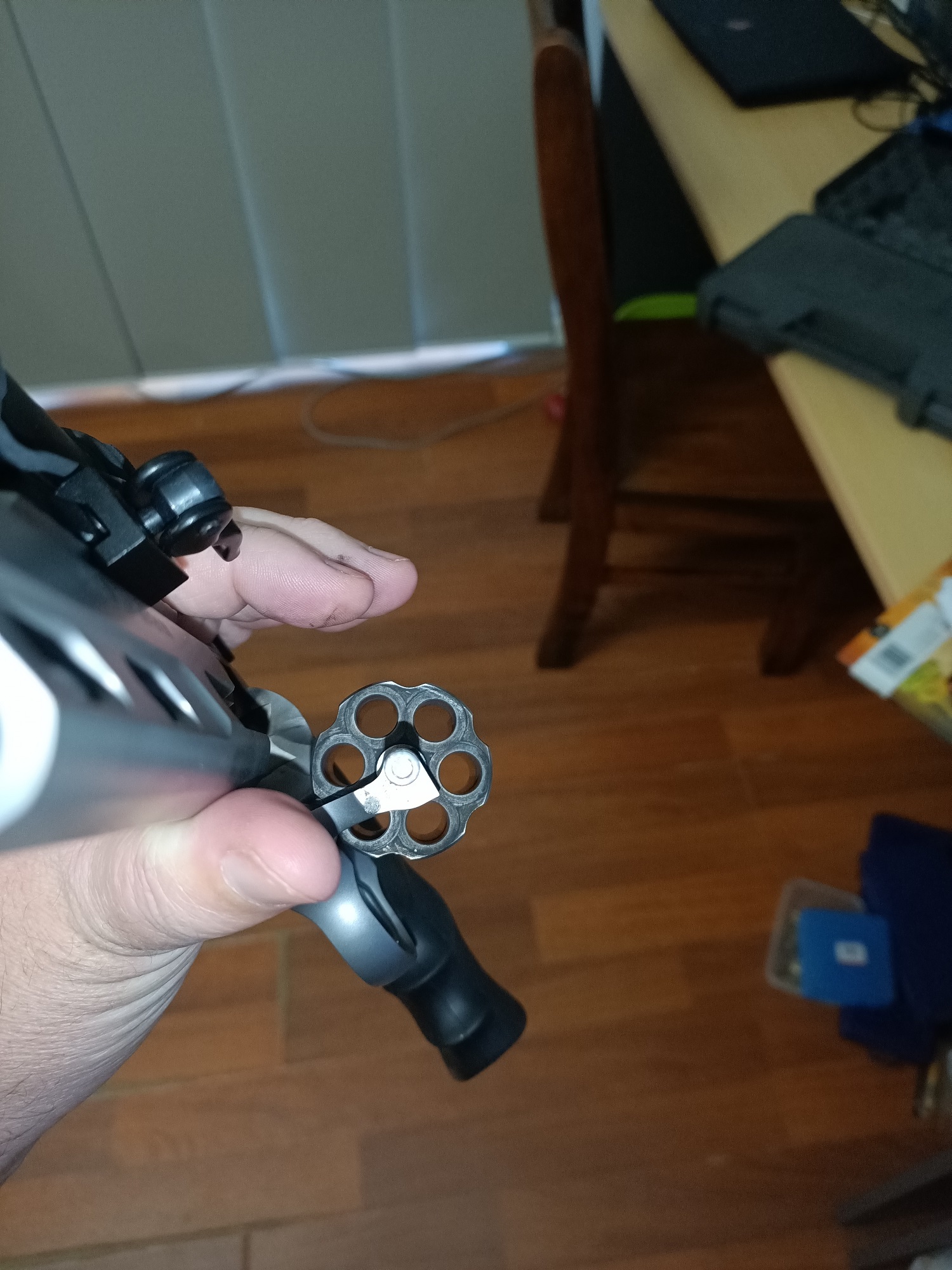

Attached some pictures of the cylinder. This is as was after shooting, haven't cleaned it yet. It's not very dirty, doesn't have any visible markers or damage, barrel looks great no dents/bumps/distortions. I'll answer a few of the questions best i can.
Seems to only be one chamber, it dented a single round on some cycle's, not all.

I would suggest the split like that is likely from old cases, not a major issue, it happens.

The dent is happening on the reloading press.
There is no way that you or the revolver could apply enough force to make that sort of deformation during insertion of the round into the cylinder or during cycling and firing.
