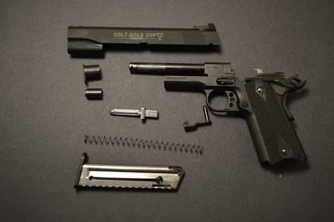

My Walther 22 is a 22 caliber clone of the Colt 1911. Colt has even licensed Walther to use/market the gun as a Colt. I've only had it out to the range once since I got it and yes it is a brand new gun. Only put about 200 to 300 rounds through it since the brother and I had taken about half a dozen guns with us. We had one failure to fire, ammo problem, one failure to extract, again ammo's fault. Two smokestacks, shooter induced I limp wristed the gun. One jam on loading, round only partially entered chamber, can't say what the cause was but it never reoccurred.

I can't agree with this statement, mine field strips just like the Colt Series 70 1911 and my Remington R1.

There is nothing 1911 about the way the Walther Colt 1911 is made.
The barrel is fixed on the frame, the trigger is not a 1911 style trigger etc. this has more in common with the walther PPQ m2 .22 than a 1911.
