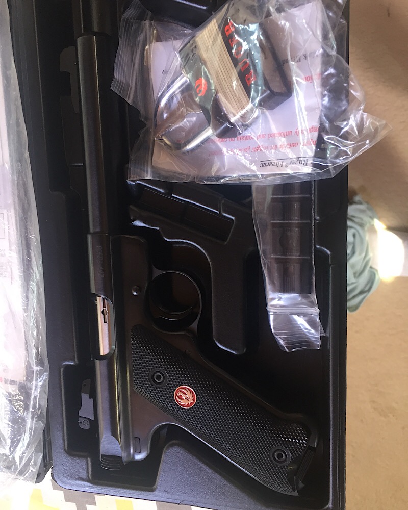

After an extended wait for my PTA to arrive i finally picked up my new chicken smasher / bullseye project a Ruger Mark III Target. Previously i have had Mark I and II and loved the accuracy for the price.
This is being built for rimfire silhouette match(chicken smashing) and bullseye if my club ever runs it again.
Stripped it down and gave it a clean and discovered for myself what every review had said, due to Commiefornia and lawyers it now has a loaded chamber indicator and a magazine disconnect. The latter caused several issues putting the gun back together including loss of skin!
Off to the range and found the trigger was terrible, have to be the worst trigger i have ever shot! It would break randomly and was mushy, the reset was all over the place and the trigger pull is heavy.

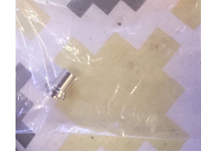

Got home and ordered a TandemKross bushing which eliminates the magaxine disconnect and a Volquartsen Acucurising kit.

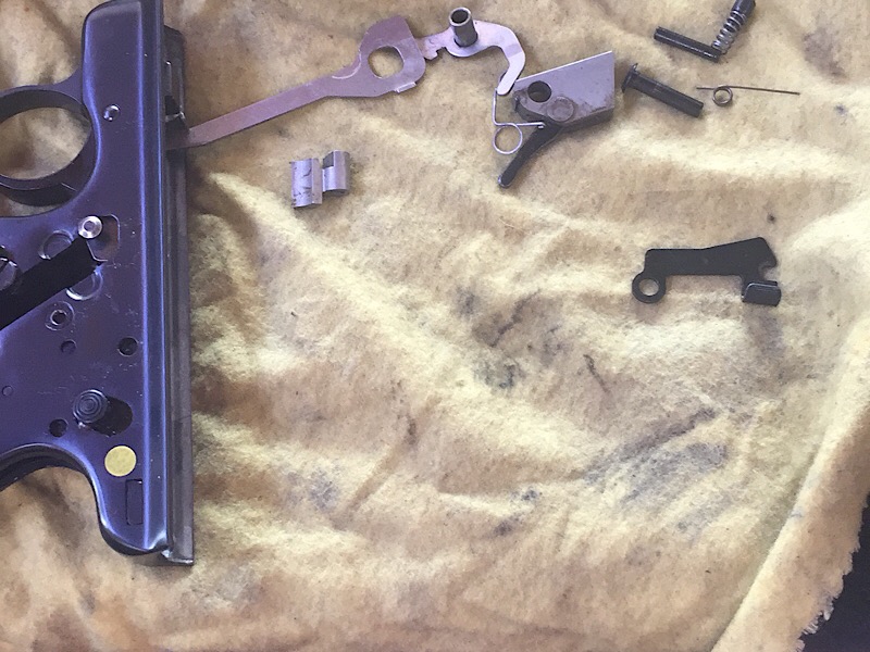

Today the bushing arrived but of course the VQ kit didnt.. given there is a rimfire silhouette match tomorrow night i stripped the pistol down and installed the bushing.
Ohhh wow what a difference the bushing makes, clean crisp break, nice reset, still a lot of pre travel but thats managable and the best part, no skin donated, so much easier not having go stuff around inserting and removing the magazine to get it together..

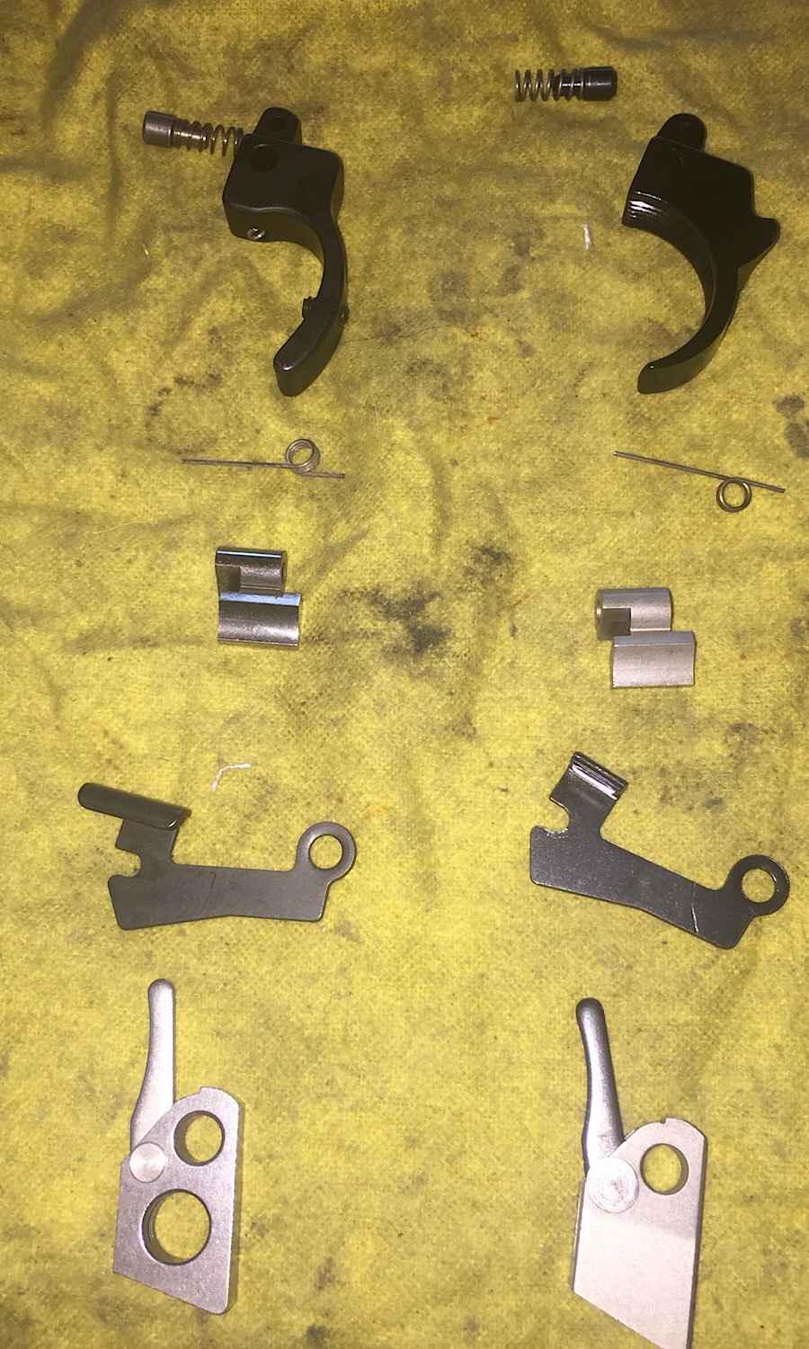

Today the Volquartsen accurizing kit arrived and the wife at the movies with her sister, decided with the help of a frosty ale to install this kit
Stripped down the ruger completely for the 3rd time in 4 days and with no loss of skin this time! The pic below shows the comparison between the VQ parts on the left to the original.
What amazed me was the level of polish the VQ parts have, so shiny and slippery it was difficult to grip onto the sear with the pliers
Pistol is back together in record time and tried the trigger and all i xan say is wow, a clean crisp break and once i adjusted the pre and over travel screws it is simply amazing. Video of the break

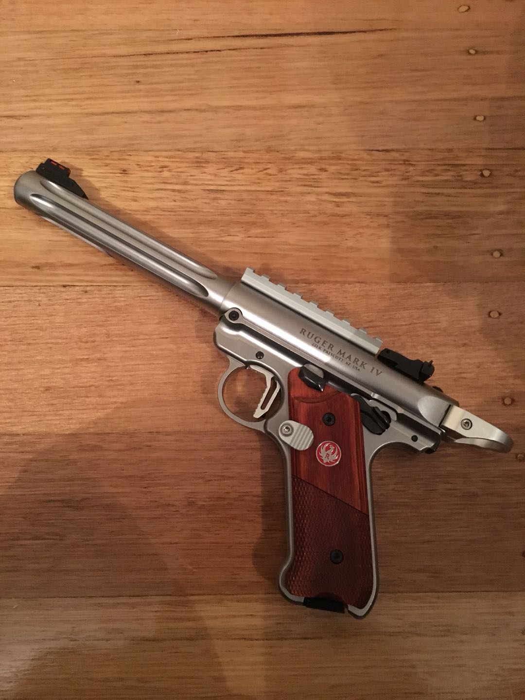

So after reading this post a few months ago. I was excited about my Ruger Mk IV. I ended up spending lots of money buy parts for my pistol. I have the Vorquartsen accuracy kit put in, I have the Tandemkross trigger and charge handle put in, also the extended magazine release and the rail for a red dot. Still waiting on the extended slide release. I sourced all my parts from Brownell.com.au and Tandemkross in the States.
Now the pistol is super nice, all after market parts are silver, certainly looks sexy. Pic will be tomorrow. The trigger now is super light, scarily light. My very first shot I pulled the trigger without intentionally. The trigger pull travel is incredibly short. Super happy with the trigger. The accuracy is too good. I fired about 200 rounds today without really trying, and most of them are in the centre black area from 25m. Sorry forgot to take a pic. One thing however is about 10-15% of the shots didn't go off due to light hammer or spring. Something I will have to look into. Once I get this fix, I will get a Vortex red dot to put on. At the end I think I will spend nearly $900 on parts. The pistol is surprisingly easy to dissemble and put everything back together.

Awesome work :) my trigger is around 500 grams and breaks like glass. I have shot probably 5000 rounds since making the change and it still brings a smile to my face.
I had an issue with the trigger screws coming undone as i didnt clean the parts properly and the loctite didnt take.
I have different grips depending on which match i am shooting. I have different sights as well i picked them up off the tandemkross site, 3 fibre optic upgrade. Also have a cheapy red dog when i want to beat brett1868 in rimfire silhouette matches.
We run NRA Bullseye at my club and the mkiii holds its own..
If you think the trigger is too light then put the factory spring on the plunger and that will bring it up a few grams.
I have the LCI replacement and the firing pin replacement from tandemkross on its way. Its like a drug i cant stop changing things.
