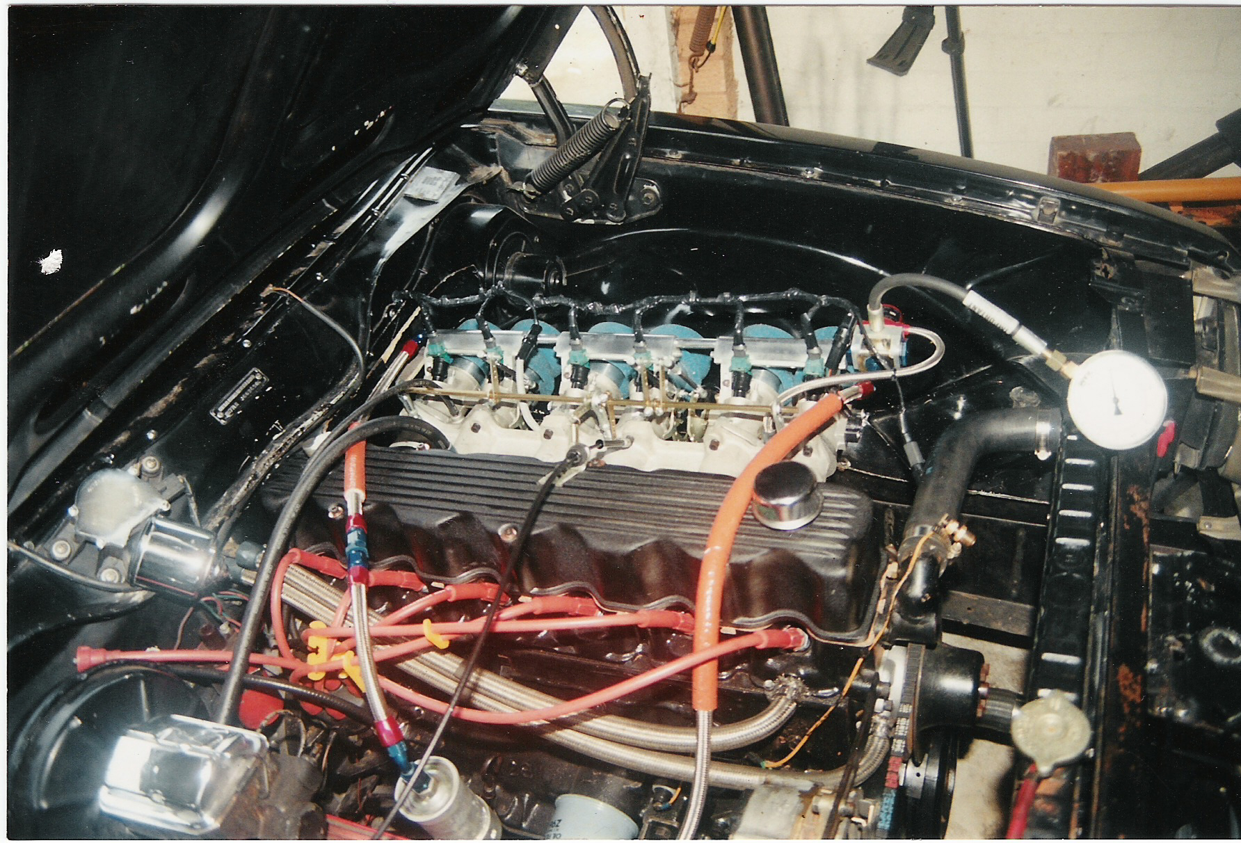

Post by Baronvonrort » 21 Nov 2016, 7:41 pm
I think supaduke has it ass about, closed loop is when it uses inputs from O2 sensor, I put a fuel injected 265 Hemi in a UC Torana over 20 years ago, just weld a nut into the collector the O2 sensor needs to be hot before it will work
