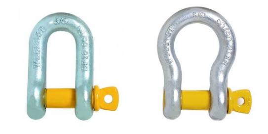

images (1).jpg (11.52 KiB) Viewed 13818 times

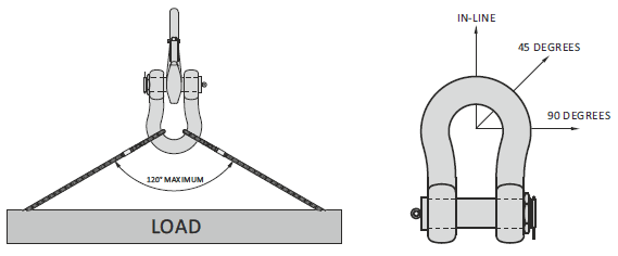

A D Shackle is designed for a single straight line pull.
A Bow shackle is designed for use when you need 2 legs attached to the Bow shackle pulling at an angle to the load on the hook.
A bow shackle is fine to use for both applications but D Shackles shouldn't be side loaded.

Bow shackles also have a larger clearance in its inner and outer diameter. So you can fit a larger hook or chain in it. On the flip side it also does not fit within as small an area, which in certain circumstances would require a D shackle. D's have a slight strength advantage when pulling in a straight line over a bow, but are much weaker when pulled on an angle.

There's nothing wrong with D shackles as long as it's for their intended use, dead straight pulls.
As soon as their is any side loading their WLL is massively reduced.
D shackles have an advantage of being smaller, so are good for limited space where only straight pulls are required. That's part of the reason they're still around.
As it relates to trailers and four wheel drive recoveries you should go with bow shackles as there will always be angles involved.
