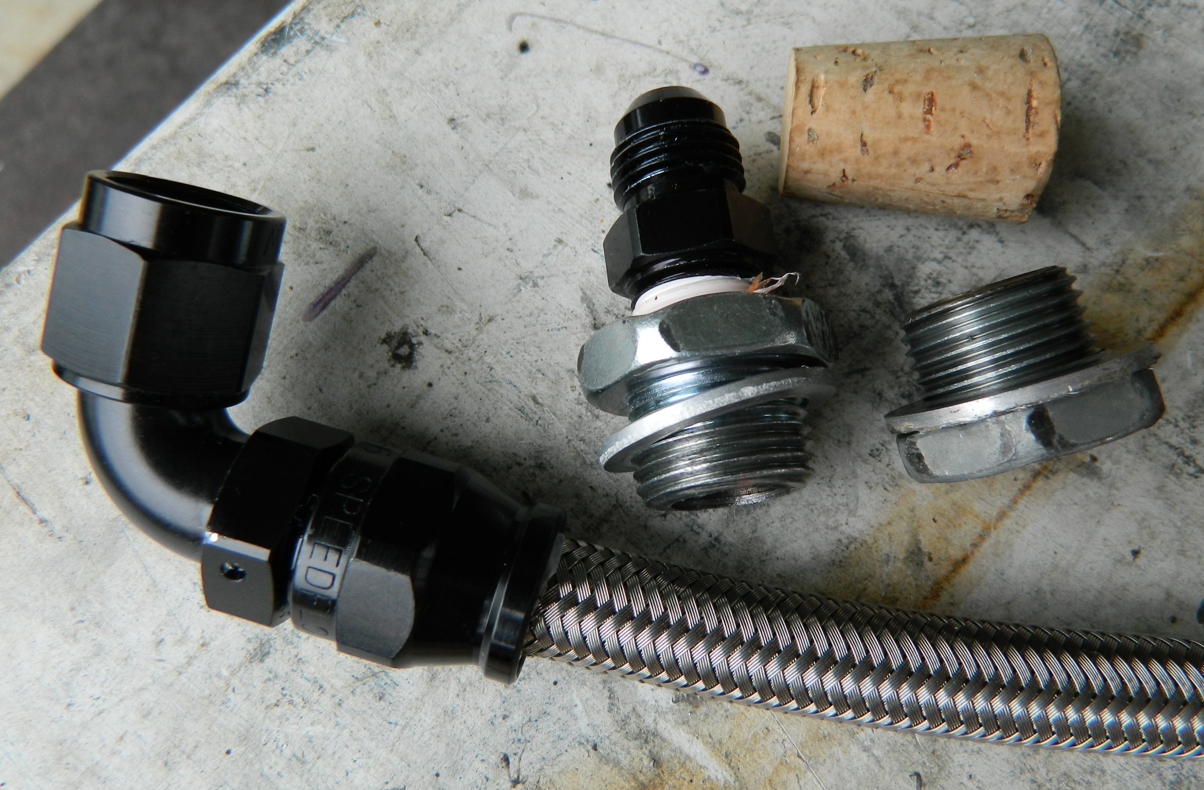

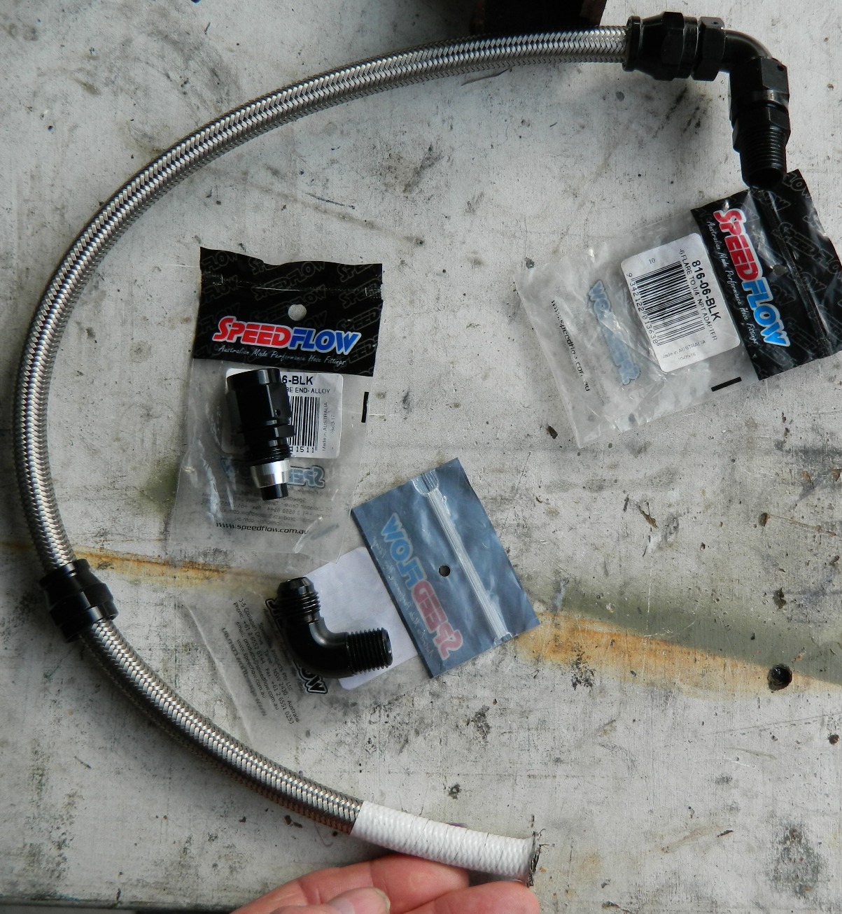

Here is the external braided hose and various fitting (another option, is to use Banjo Fittings on each end).
So I purchased two new filler plugs and washers, and then drilled and tapped them for 1/4" NPT (Note the Cork Plug, for temporary plugging, of the filler plug hole/s).
I then removed the original Filler plugs and replaced them with the new modified plugs.
Once both new modified plugs were in place, I then attached the braided hose to the top (G/box) plug and measured it for the correct length.
I then removed the hose and cut it (with an Angle Grinder with a 1mm thick cutting disc), to the correct length
I then cleaned out any abrasives and other ground up crap, from inside the newly cut braided hose (ask me How, if you want to know), and attached the end fittings to the hose.
I then attached the hose and fittings, to the new filler plugs.

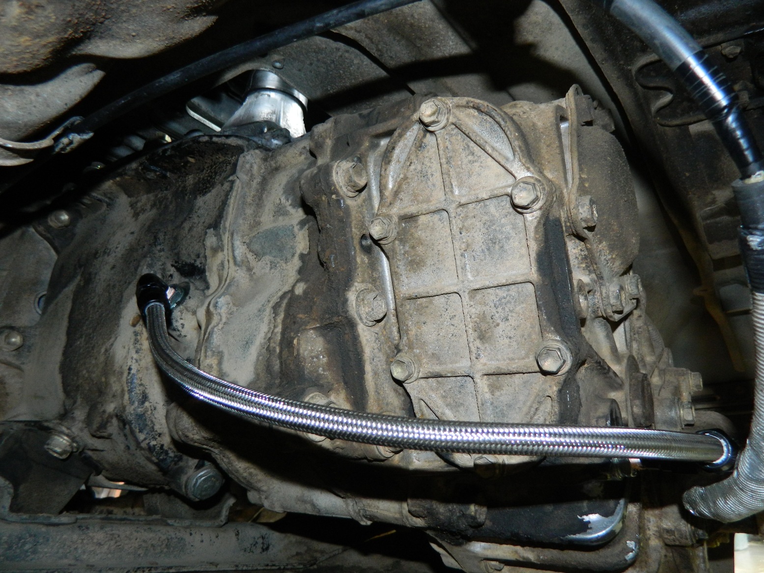

Here is a couple of images of the hose and new filler plugs in place. Please note that I have already degreased all the leaked oil, off the G/box etc.
Please note that and luckily, the G/box Filler plug is physically higher on the vehicle, than the T/case Filler plug.
Also, what we are doing here, is installing a Drain and Transfer Hose.
This only works because gravity allows the oil to flow down hill, from the G/box Filler plug hole, back to the T/Case Filler plug hole.
So remember, the hose always has to have a down hill angle/fall to it!
I then took the Battle Cruiser for a run and got back under it and checked for any oil leaks.
All looks to be OK so Homer is a happy lad.

Bladeracer, the inner PTFE tube is the heat resistant type (Black) and the S/S braid, is for extra strength and assurance ("Do it once, do it properly").
Daddybang, there is a transmission etc bash plate, from just behind the T/case forward 700mm (you can see part of it in the first image).
So it should be OK.......?
