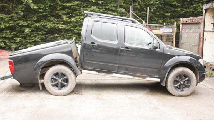

Post by RealNick » 19 Jan 2018, 2:09 pm
Doing these ones? :lol:

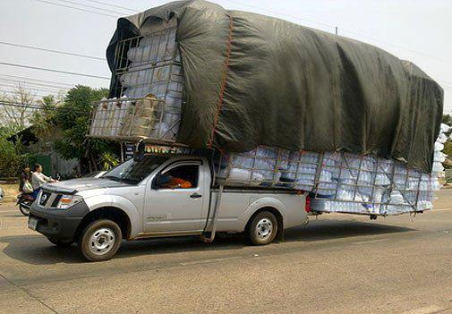

Post by RealNick » 19 Jan 2018, 2:12 pm
Wait, we have a new winner :lol:
