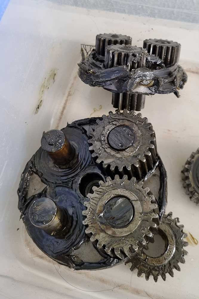

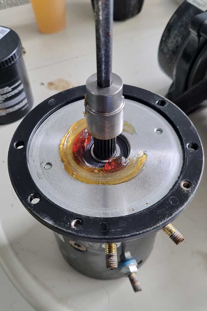

Re: Bushranger Covert winch
Post by Lorgar » 30 Aug 2024, 6:52 pm
Here you go, Wes.
The good end, and the nasty end :lol:
Lorgar
