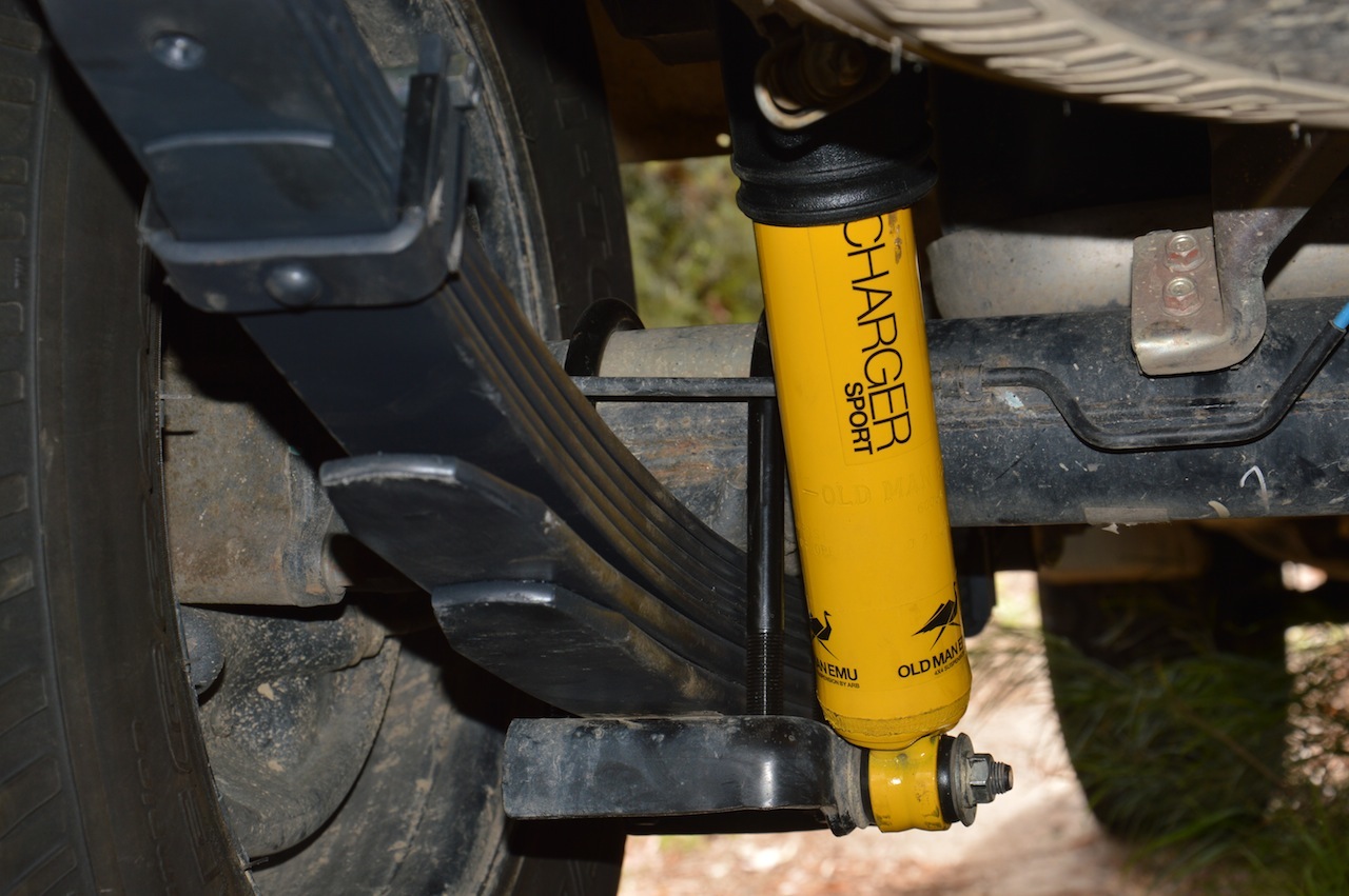

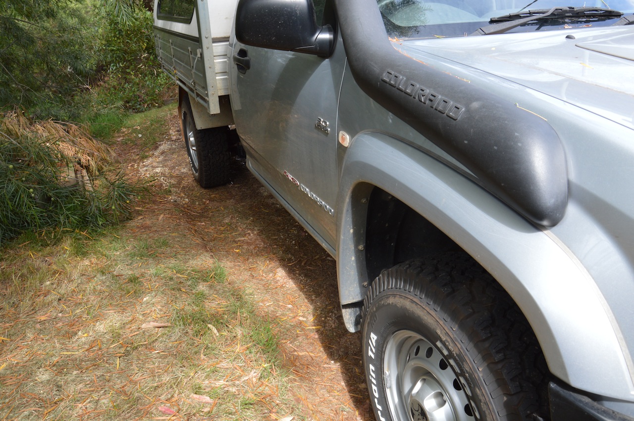

Post by North East » 17 Nov 2014, 2:45 pm
Suspension lift done, 2" lift, OME Nitro Charger shock absorbers, new rear spring packs, U bolts and bushes….$2295.00. Have to go to Albury-Wodonga tomorrow for a wheel alignment. It certainly feels different.

Post by North East » 18 Nov 2014, 12:35 pm
It's been an expensive few weeks.
5 BF Goodrich All Terrain tyres fitted, balanced….$1675.00
ARB, Old Man Emu suspension system, fitted….$2295.00
Wheel alignment….$75.00
TOTAL….$4045.00
The joys of running a 4WD, the fourth one I've owned.

Post by Turkle » 18 Nov 2014, 8:34 pm
Always in the bright colours... Anyone else not like the super bright suspension or brake calipers not sticking out on cars?
Marlin XS7 - 7mm-08
Winchester 1902 - .22
Turkle
Posts: 101
Re: Suspension lift-Holden Colorado
Post by North East » 18 Nov 2014, 8:48 pm
Turkle wrote:Always in the bright colours... Anyone else not like the super bright suspension or brake calipers not sticking out on cars?
They will not be yellow for long.
....that will do me
North East
Posts: 684
Post by Turkle » 19 Nov 2014, 12:22 pm
That's true... :)
