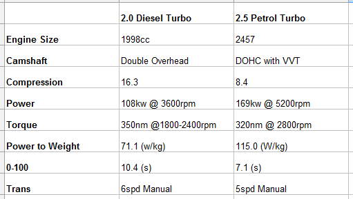

I've been mulling over getting a 2009 - 2012 Forester for a while now and think I'm pretty decided on it. Now just down to petrol or diesel. Both turbo.
Point of the car is for a comfortable, quality daily drive with a little off-road ability under the belt for some camping. I know the Forster isn't a "proper" 4WD and won't be doing anything extreme with it but for moderate trails I think it's the right mix.
Back to the engine... I've test driven the 2.5l turbo petty on the road and it's perfect for that. Plenty of pickup, comfy and all the rest. The 2.0l turbo diesel doesn't press you back into your seat but that's expected.
These are the figures for the engines/gearbox.
What I'm trying to work out is if it's worth going the diesel for the extra low down it gives that could come in handy off road, but obviously no one will let you test drive their car down a rough track to find out so I'm stuck with using my imagination at the moment.
To sum up the benefit of the diesel, with the extra torque lower in the rev range and the 6spd gearbox it's going to be better for challenging uphill take-offs, or if taking off against something pressed to the wheels like if you crept up to a small log to climb over.
Right?
The petrol is so much better on the road which is the majority of where I'll be, so I'm trying to work out if it's worth the trade off and how much better it is in the off-road regard with a diesel.
:unknown: :)

ANother benefit of a diesel is longevity, but that won't really come into it as a daily driver as you'll likely upgrade before you see the benefit.
Both our cars are diesel but in you situation i'd go the petrol. For the "soft road" work you're likely to do, the extra torque isn't going to be that much use. If you plan on a lot of hilly terrain at low speed or will be towing something (pretty light at that sized engine) then the torque might help.
My wife's Peugeot is a 2L diesel and driven right (or wrong) it can definitely press you back into the seat. Not all diesel engines are pussy cats.

Gwion wrote:For the "soft road" work you're likely to do, the extra torque isn't going to be that much use. If you plan on a lot of hilly terrain at low speed or will be towing something (pretty light at that sized engine) then the torque might help.
+1 for this.
It's not a serious 4X4 as you said and the terrain you're tackling won't have anything in it that would really benefit. If it's a modest enough log/bump/hill that you're doing it in a Forester petrol will do it.
I'd take the petrol for the better road experience from what you've described.

I have a petrol forester and absolutely love it! With diesel boxer engines, you don't see many of them around and there have been some bad reviews going around regarding some "particle trap" in the "engine??" that make the engine stall at red lights.
I don't have any complaints with mine, does everything I want it to do and I use it on forestry tracks no dramas

I have a 2003 Forester X - 2.5L N/A Manual.
If you're going to be towing anything, get the diesel.
If you're going to be going on long range trips, get the diesel.
If you want speed/handling, get the petrol.
I wish i had the diesel. I tow things maybe once a month and i go on long trips regularly. The fuel consumption of the turbo petrol models is very high, the diesel models is actually pretty good. My N/A 2.5 isn't bad either.
Your call, get the car that fits your needs best.

NuZo wrote:The fuel consumption of the turbo petrol models is very high, the diesel models is actually pretty good.
Depends on how you drive really.
The turbo's fully spooled in the Subaru's around 3,500 - 4,000 rpm I think, which is about where you'd change gear in 'normal' driving.
But yeah, if you're constantly pushing it up to 5,500 - 6000 all the time for the 'push you into the seat thrill' style of driving it really drinks it fast.
For towing or hauling a lot of weight around turbo diesel definitely the best option, hands down.

Back to the original question for Chacka, the guys voting for petrol make sense but I wouldn't write off the diesel just yet. At least go and test drive one.
As is the way with diesels power drops off at the top of the rev range which you'll immediately notice compared to a petrol. You have to shift a earlier and a bit more often. Man do they pull in the low range though! Getting up to 60-70 km/h is definitely not slow. Going a petrol for monster power at the redline isn't really that useful as you can't drive on the road like that. The diesel has plenty in the normal driving range where it counts.

Seemed to be plenty of grunt in the 6cyl subaru I test drove as mentioned above, but without an actual throttle cable.. bleh. There were different modes in various models from memory, maybe one of the full sports tunings would have behaved better.

headspace wrote:I'm not sure who makes the diesel engine in the Subaru though, as far as I know they have never been involved in diesels.
I thought they made their own, but they're a recent foray for them. I think it was about 2008 they added diesel engine options to a few of their line-ups?
In general Subaru seem to make a pretty good engine, and the diesel should be no different. A few years to see how they last over the long haul will tell.
