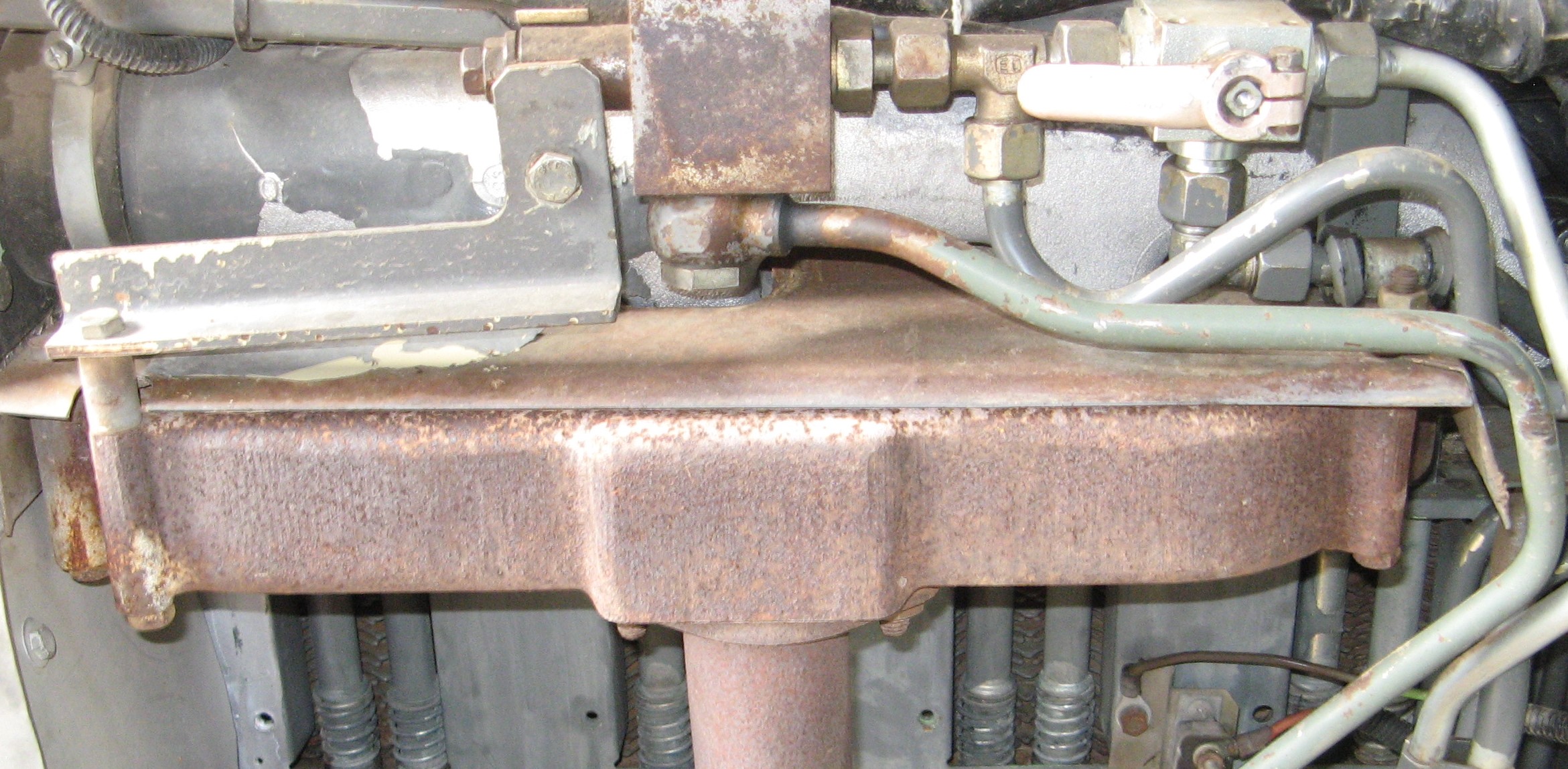

Post by NTSOG » 10 Jan 2022, 1:31 pm
G'day bladeracer,
The tractor does have an oil cooler inside the cooling shroud on the right side of the engine. It seems to be doing its job as is the hydraulic oil heat exchanger boosted by the motor-cycle blower fan I installed behind it. The maximum specified exhaust temperature is 650C according to a bloke on a US tractor site who actually has the installation manual for this engine. [Also 230C on No. 1cyl. Head temp., 140C oil in pan.] He didn't specify the exact location on the exhaust manifold, but I will install the sensor as close as I can to the No.4 cylinder exhaust outlet - I understand that there is a significant drop in temperature further away from the cylinder. If you look at the attached photo of the manifold on the left side of the engine, I aim to fit the sensor just at or before the curve of the manifold at No. 4 cylinder before the vertical mounting bolt. I'm not going to disassemble any of the complex hydraulic piping to get improved access - better for a mug amateur mechanic to leave old seals and joints alone!
Gamerancher: "... the heat in the cab was incredible." After a couple of hours of work the old girl does get pretty hot. I don't have an air conditioner in the cab, but simply open all windows and prop the doors open - and sweat - a lot
Jim

Post by bladeracer » 10 Jan 2022, 2:51 pm
NTSOG wrote:G'day bladeracer,
Jim

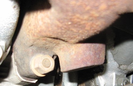

How does the manual say to measure the temp there? If that's where they measure it there should be a boss or something for mounting. CHT is usually done aftermarket with a sensor washer on the spark plug or glow plug. But if they have a sensor port or boss built in you'd likely get different readings from mounting the sensor elsewhere. I would log the temperatures over time and under different conditions and determine your own "do not exceed" requirements from that.
Re: Installing a Pyrometer: where to place on exhaust manifo
Post by NTSOG » 10 Jan 2022, 4:58 pm
G'day,
As you suggested there is a cylindrical shaped 'boss' under the manifold closely adjacent No.4 cylinder and protruding downwards and slightly rearwards: it is clearly visible in the attached photo. As can be seen the boss is very close to the cylinder but also the cabin bulkhead. Accessing it would require considerable disassembly of adjacent piping and removal of the manifold itself which is beyond me. While I have access to AGCO's Fendt parts book and the user manual, nothing is discussed about temperatures. As I said a US bloke gave me the temperatures as he has an installation manual for the F4L 913 engine. Where I will have to install the pyrometer sensor is about 3+" out from the cylinder. Each cylinder is tapped [14mm dia.] and about 59 mm deep [right side] for insertion of a bi-metal temperature probe which feeds to the analog gauge on the dashboard, though only one is installed - on No.4.
I think you're correct: the factory specification of 650C maximum EGT can only be a [very high] guide for me as the pyrometer I will install will be 3+" away from the cylinder and temperatures drop as gases pass along the exhaust tube. As you say I will have to "log the temperatures over time and under different conditions and determine [my] own "do not exceed" requirements from that."
Many thinks for your interest and advice,
Jim
