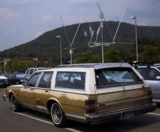

Post by SendIt » 13 Nov 2017, 12:35 pm
I'll jump into the fire here too.
About mounting a UHF antenna in the middle of the roof...
Someone find me a picture of someone, anyone, who's actually done it.

Here you go

I'm going to say no.
We're talking about mounting a UHF radio antenna here.
Not accessorizing your car to match your tin foil hat.
