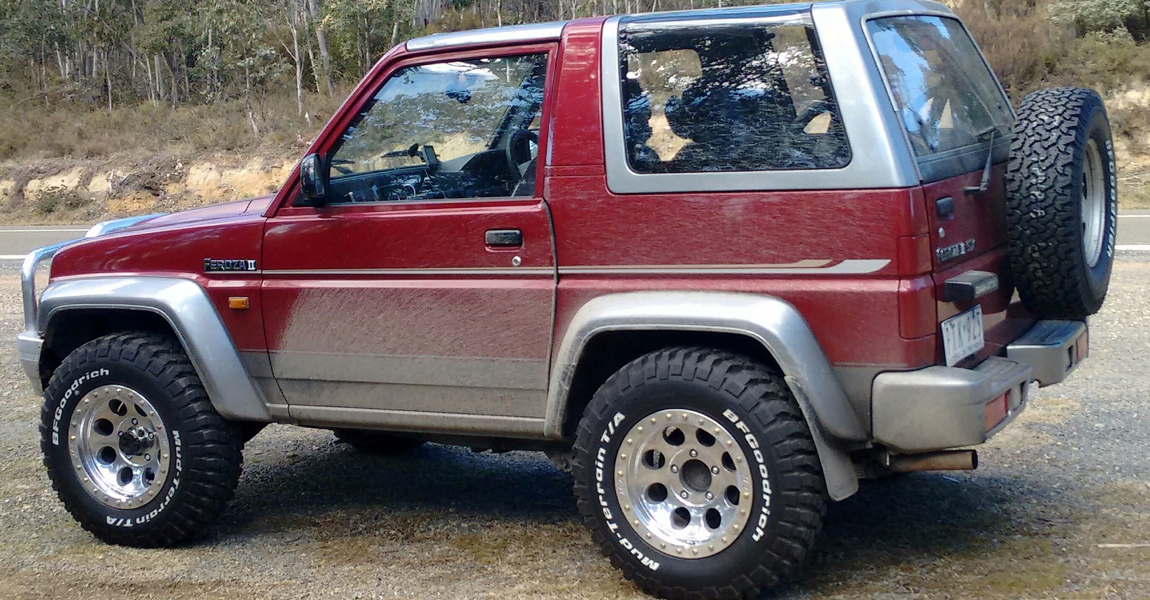

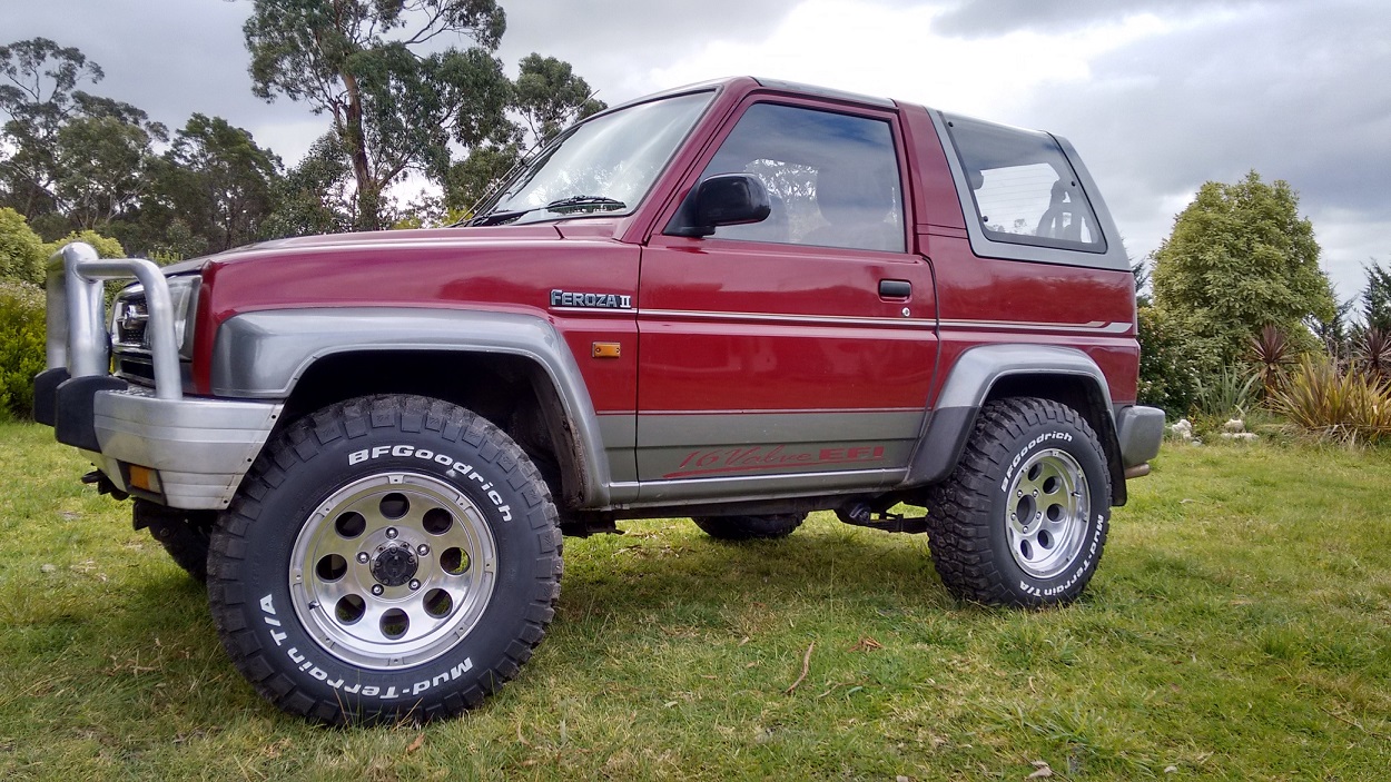

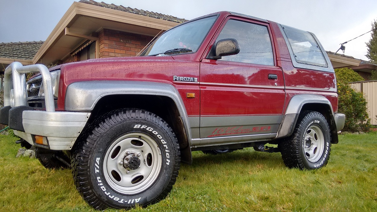

Added a 50mm Tough Dog lift and cranked up the Sway-Away torsion bars. I've opted for a combo of fully practical and fully sic. Stock rims and MT classic locks. The skinnier AT's are obviously better on road but for general off road they would have done the job no worries.
However when the AUD was over the USD I ordered some Mickey Thompsons from Summit cheap. 16"x8" Classic Locks.
The BFG Muddies shred off road but feel a less attached on road. Surprisingly quiet on the highway and the larger dia has acted like an overdrive gear ratio.
I like the look and stance these rims and tyres give this 'hairdresser' wagon more than anything :)

First snow trip so had to show off the bling and mud boots. Front mud flaps wouldn't hurt.

KWhorenet wrote:Awesome looking rig mate. I always thought those SWB mini trucks were great in the bush with decent tyres fitted. A little rough but will go places a patrol or land cruiser won't.
Yeah not the plushness of a heavier bigger platform but nimble and able. Suspension works smoother with a bit of a load in it. Fun factor of 10 and if I have a catastrophic mishap I can repair or replace for about $500 - $3000. Fits enough gear in the back and Rottweiler in the front. Tows a tinny or loaded 7x5 trailer no worries. Have also towed grass harrows in Low 3rd before I got a tractor.
Sort of like having an off-road buggy with rego and it's not a zook :lol:
Last trip on Stockton dunes I didn't let the tyres down before Lavis Lane entry point :problem: just got past an old Patrol and VWank dual cab who tried the same on the chopped up soft s**t. pricks f***ed my line & momentum. They all thought it was funny that I got a bit crossed up to miss them & went splat. While they were getting snatched by a Cruiser we let the tyres down and drove off. :drinks:
