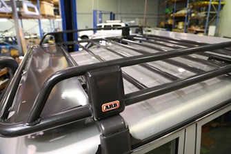

Hi guys,
Got a roof rack that needs the side rails chopped to keep the overall height down for city stuff.
Hopefully can make out what I'm talking about from these pics off the net.
What I'd like to do is chop the side rails and grind them down to make smooth tubes around.
The question is, how are they likely joined? What I'm hoping is the bottom tube that is the base of the rack is solid, and the top bars have a scallop taken out and sit on the tube.
Hoping it's not the case that the bottom tube of the rack has holes in it, and the side rails drop into those holes and are welded.
Basically so if we cut the side off we don't create holes in the base of the rack.
Hard to word this, hopefully you guys follow..... How do you think it's likely made?
Wes

Cut a corner of the top rack after the support and about 20 mm up from base and have a look it looks to me like its a solid tube on the base use a thin grinder wheel something like this
http://www.ebay.com.au/itm/50-x-5-125MM ... SwnOJWEyYw
watch where your sparks are going and cover anypaint work carboard will do DONT try to cut through the weld Grind down to it

At a guess id say the top rail is notched to match the profile of the bottom rail, rarely is the bottom tube drilled, it weakens it too much.

I'm voting on the top being notched, it's the way most tubes are joined because it's faster and probably stronger.

Chronos wrote:At a guess id say the top rail is notched to match the profile of the bottom rail, rarely is the bottom tube drilled, it weakens it too much.
I agree, that is how we'd have done it when I worked in a shop as a welder. A lot less labor involved.

Being a Boilermaker/Pressure Vessel/Maintenance welder (qualified) in all these fields for 40 + years I would 99.999% guarantee that the upright sides are simply scalloped, and fitted up in a jig and mig welded (probably) by automated mig gun/s.
I have dealt with this brand many times in the field and in a maintenance sense,, and again can guarantee that they mass produce in the simplest possible way, and the most cost effective way so as to maximize their profits at the end of each and every day.

Have to agree with Gwion on this it will be stuffed if you cut it.
The 2 risers and top bar give that rack a heap of strength cutting them off will weaken it significantly, the second moment of area calculation is base times height cubed over 12, since height is cubed any change here will make a great change to stiffness and taking it away will significantly reduce its carrying capacity.
Might be better to work out a quick release system to remove it when not in use.
I also concur with the above mentioned.
At the very least,, take the R/side upper rail off and put it on the L/side, underneath at approx 60 / 80 degrees (just winged enough to clear opening doors) and put the L/side onto the R/side.
You won't end up with the same strength/carry capacity, but it will still be functional.
Care needs to be taken, eg bracing the whole thing while cutting and rewelding,,, to prevent distortion etc.

From what I've seen of these roof racks, the base section is assembled and then the sides are notched to mate with the base section and welded to the base!
They are then sand blasted and Powder Coated!
It must still be strong across the body between the mounts though?
Fair enough strength of the overhanging areas would go down but if you don't put anything heavy on their and only on the central area it must still be pretty strong?
