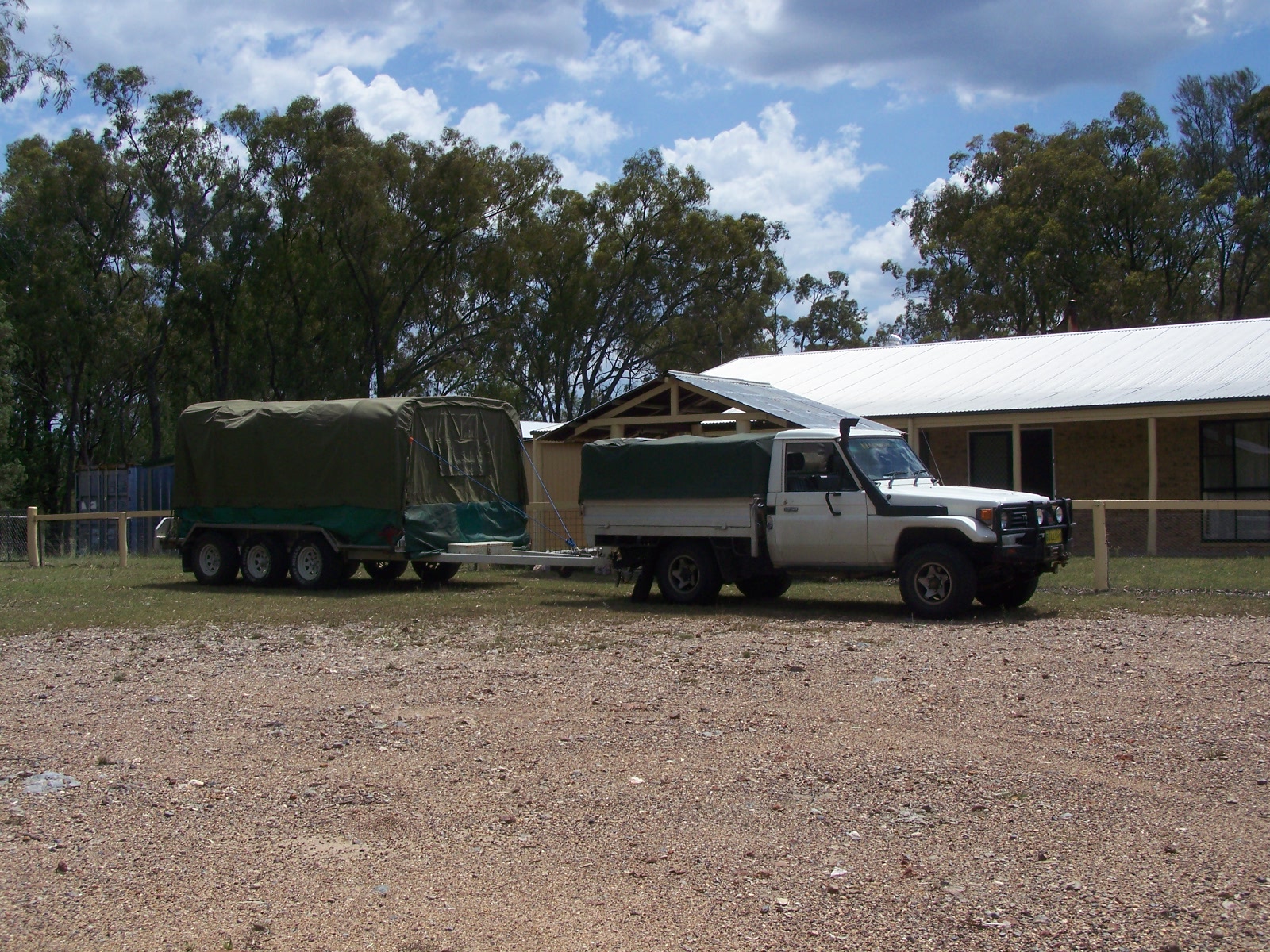

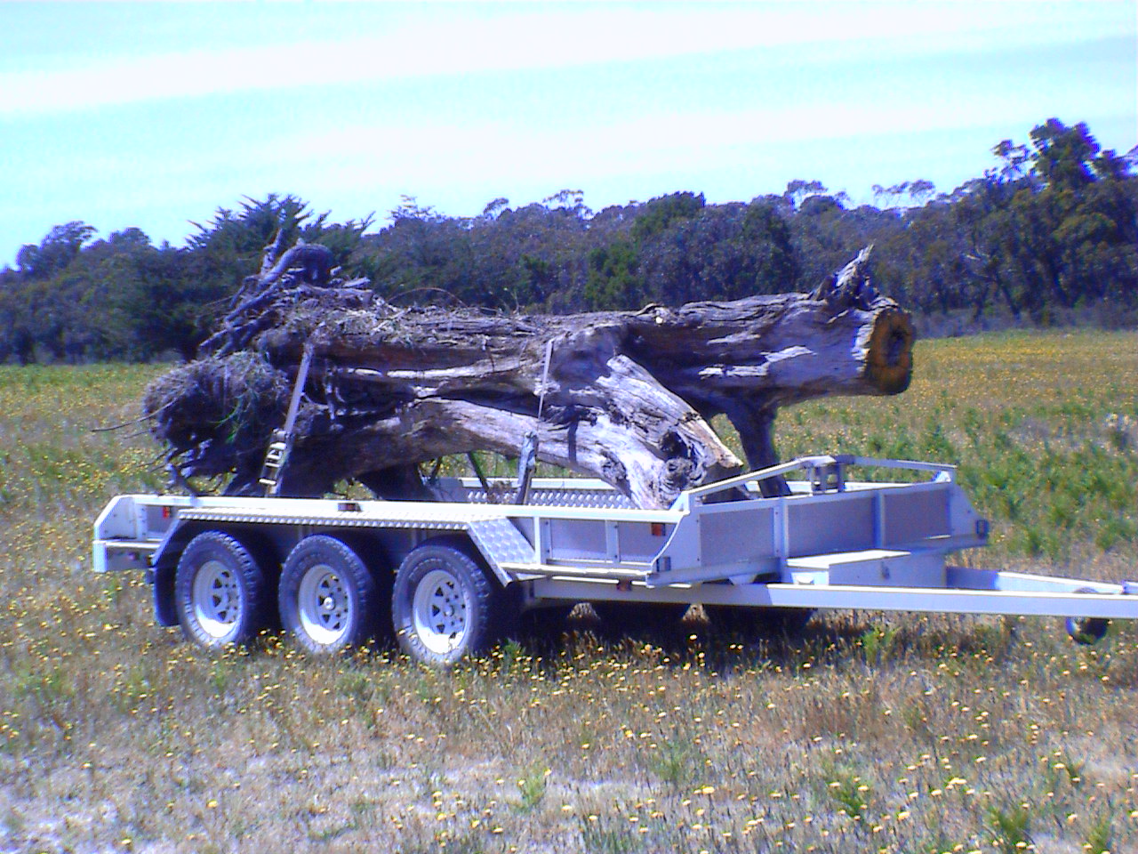

Heres a trailer you might be interested in that I built.

Re: Tell me about trailers and towing
Post by Die Judicii » 11 Jul 2016, 9:13 pm
Same trailer also takes the full sized army troop carrier tarp and hoops.
Absolutely magic for camping in, or as was the case when this pic was taken, shifting house.
It was choc a bloc full right up to the top with furniture, just after a 3rd 1,500 klm trip.

I know for a fact that my triaxle (photos in this thread) costs more than double to register in Qld compared to the Sth Aus rego of the same trailer. :thumbsdown:
