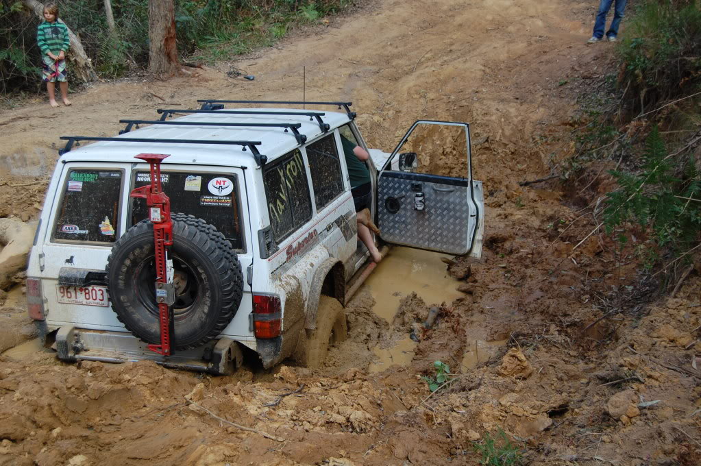

A high lift jack can double as a winch if you're desperate, that's all I have.
I put more energy and effort into avoiding getting stuck in the first place but failing that, 95% of the time all I need is a shovel.

on_one_wheel wrote:A high lift jack can double as a winch if you're desperate, that's all I have.
Sometimes between point A to point B there is an obstacle that can't be *avoided* and you have to get stuck then unstuck to get there. Hi-Lift can be used as a make shift winch but any serious recovery needs the right gear if you want to get through safely.

There's lots of 12 000lb winches on the market, something to remember is that most steel bullbars are only rated to around
9 500lb.
I think winches are great, most people lug one around on the front of their bus for years, addind weight to your bullbar which in turn puts extra stress on tour chassis on rough roads and come time to use it .... when you're REALY stuck you realize that that lump of junk has sat there for 5 years in the elements without use or maintenance and is now frozen solid.
Keep em serviced folks.
There's 2 types of four wheel drivers, those who put every effort into completely avoiding trouble and heros looking for a challenge.
Look at that idiot in the picture. .. perfectly good road around the mud hole, no he'll just lob straight into it.
