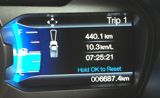

Post by brett1868 » 14 Sep 2016, 12:18 am
I've recently bought a Ford Ranger XLT, the standard tyres in the wet are crap so I'm also considering something better along the Mud / All Terrain route. Is there an intermediate type tyre? Something between factory fitment and full on mud bashing like a "Moist Soil" tyre :D . I'm looking for better grip in the wet and good enough for soft sand with the occasional rain soaked dirt track.
Suggestions so far have been very helpful as I'm in a similar situation as chacka
My fuel economy has been awesome so far :clap:
Mix of peak hour gridlock and commuting into Sydney CBD
