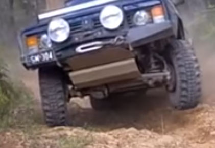

First and foremost, doing it WAY too fast.
One thing aside form that which leaps out at me, it looks to me like he's possibly running road pressures in the tyres.
Watch the tyres as he reaches the tops, bounces and settles, they hardly bulge at all when he comes down on them.
This is a screenshot where he is almost at a complete stop, and the left wheel is on a bit of pointed terrain. Look at the sidewalls, they're almost dead straight.
I run my A/T's at 40psi on the road and they bulge more than that when all four wheels are on the flat and the truck is empty(ish). He's got two in the air and is on a point and even then they're not giving anything.
I guess he's running something similar? More? Who knows.
If I was going through an area with anything like that I'd have dropped the tyres to 25psi and would have done that hill at 1/3rd the speed. Low-range 1st for sure.
Just wrong everything going on in that film.

Post by Lorgar » 04 Nov 2016, 3:24 pm
Oldbloke wrote:Not convinced in this case that lower tyre pressure would help much.
Not as the speed he was going, no. He'd have been bouncing around regardless.
At about the 35 second mark both front wheels are up in the air and it looks like (a bit obscured, hard to tell) that his rear right wheel comes off the ground for an instant too. Nothing is going to save you when you've only got 1 wheel contacting the ground.
As per OPs requests for peoples read on the situation, it appears to me from the video he is running excessively high pressures for the situation.
We all agree that needed to be done far slower, and more appropriate tyre pressure would have only helped in ascending the hill safely.

I know this track. It's Deep Creek #4, Walhalla Area. We've done this track a few times.
Lorgar wrote:One thing aside form that which leaps out at me, it looks to me like he's possibly running road pressures in the tyres.
That section was really steep. We ran 16psi up there. Front tyres in vid have no weight on them so look higher pressure. I can tell by the tread, he has Symex tyres. People who bother to buy Symex know about pressures. That track also needed momentum, low first wasn't enough. I was in second/third (moist conditions).
For whoever said the track doesn't look overly challenging, video never shows steepness. The best way to gauge steepness is looking for how soft and bouncy the front end is. If it looks like it's bouncing on a pillow, the track is steep. The video gives a false perception.
There were a couple of things wrong. You could hear him trying to restart the engine after a stall, and he allowed the car to roll back while trying to restart it. Also, the spotter should have let him know the danger. Clearly, his back right dropped into a hole causing the roll backward.

Post by Lorgar » 12 Aug 2017, 9:54 pm
Flash wrote:That section was really steep. We ran 16psi up there. Front tyres in vid have no weight on them so look higher pressure. I can tell by the tread, he has Symex tyres. People who bother to buy Symex know about pressures. That track also needed momentum, low first wasn't enough. I was in second/third (moist conditions).
The front tyres most certainly had weight on them when they came slamming down after the front end was off the ground. I did reference that specifically in my reply/opinion.
