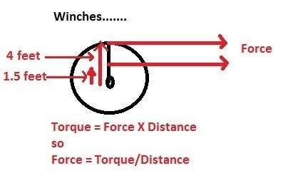

Post by brett1868 » 06 Dec 2016, 12:16 pm
Nothing to do with clamping, the mechanical advantage decreases as the drum diameter increases.
Distance is radius to cable layer and you know from everyday experience it takes more force to torque a bolt with a short wrench than with a long one. So just reverse that - same torque pulls harder on a short radius arm than a long one. Changing the radius from 48 inches to 18 inches almost triples the pull , 48/18 = 22/3
