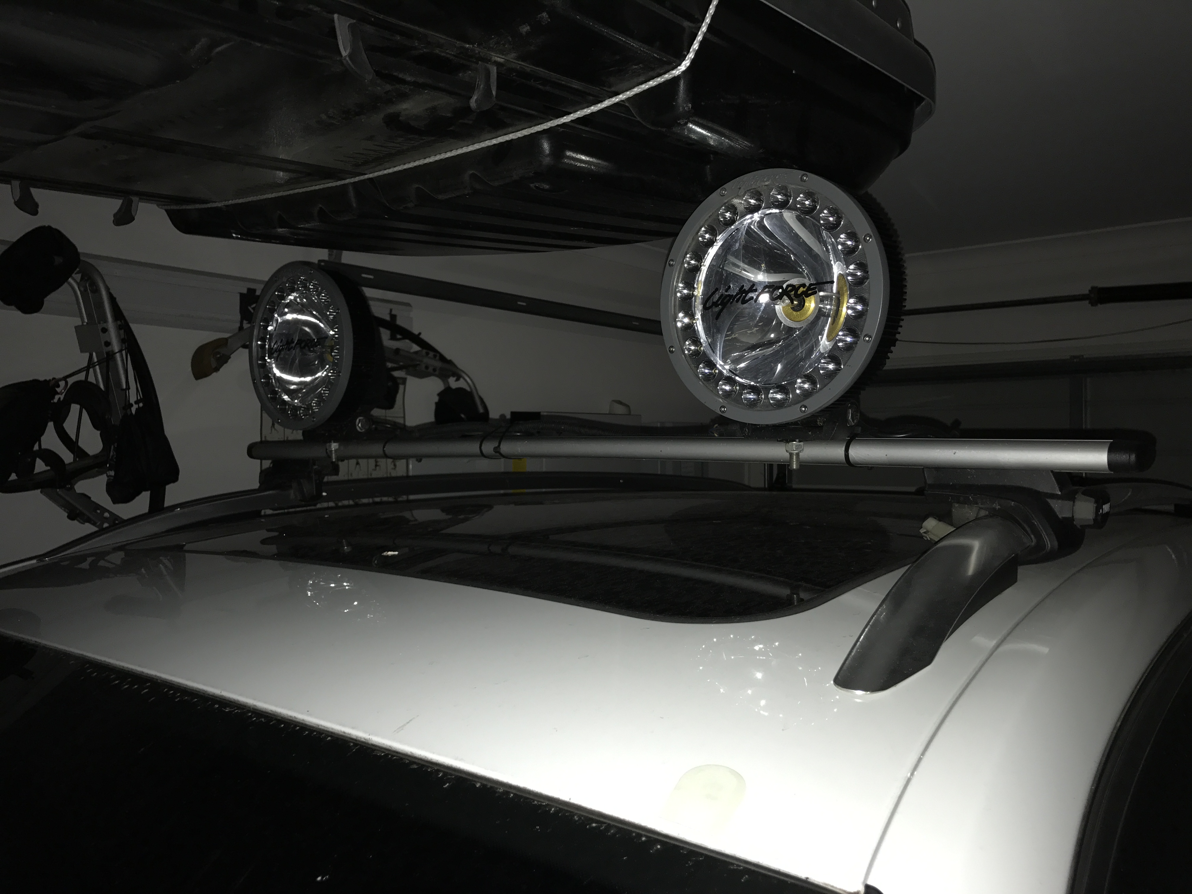

I have no issues with 2 x Lightforce HTX on a roof rack on my Touareg.

Here they are.
They are a combo light with a pencil HID beam and the LED equivalent to a light bar.
