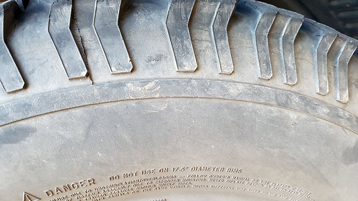

Ok here's my actual tires.
(You have to click to see the first one in full, I did it too big or something)
You can see the wear indicator, plenty of tread above it. The level of tread is consistent across and around the tire.
Sidewall is in good condition.
Rubber all round is in good condition as far as I can tell. Not cracked or brittle anywhere, feels like normal flexible "soft" rubber like any other tire.
She's right, right?

Keep on truckin' mate, tyre bloke is trying to con you. When you do wear them out, find another place to buy tyres.

I don't think thats your indicator just quietly, i reckon if you look around you'll find a wider one about 1cm wide, regardless you've got heaps left, wear them down to about the 2mm then you can start looking at new ones :)

If it was said that there is only 2-3 thousand kms of life left on the tyres I would have asked why that statement was made...??
Tread wear indicator location is marked with a small triangle on the edge of the tread / sidewall but the tread depth looks okay.
Damage to the actual tread somewhere..??
Perished perhaps..??
Tyres do have an expiry date. The date of manufacture is stamped on the sidewall and is usually a week of the year and year prefix like 0308 meaning the third week in the year 2008.
Other than that, don't know. I would have asked for an explanation.

I double checked, it definitely is the indicator on my tires.
Skinnier than most on these one I guess.

Looks perfectly fine to me.
Plenty of tread, no sign of cracking or rot.
If the tires do in fact look like that all around, I certainly wouldn't be replacing them yet.
