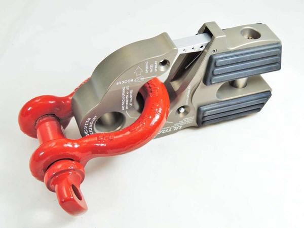

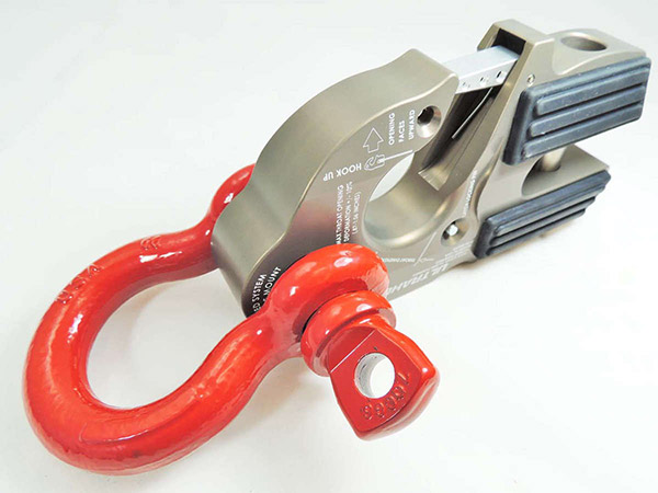

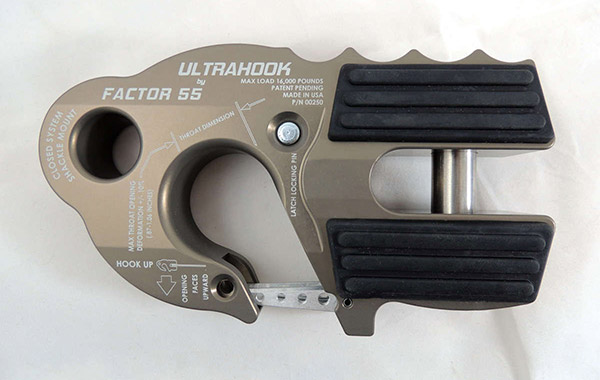

Hmm, I was going to make a suggestion then I saw the price of the thing :lol:
Anyway, here it is.... Ultrahook by Factor 55.
Works as a regular hook with safety latch and has a shackle mount hole so best of both worlds.
I hadn't looked at the price until now though... $350 :|
