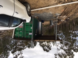

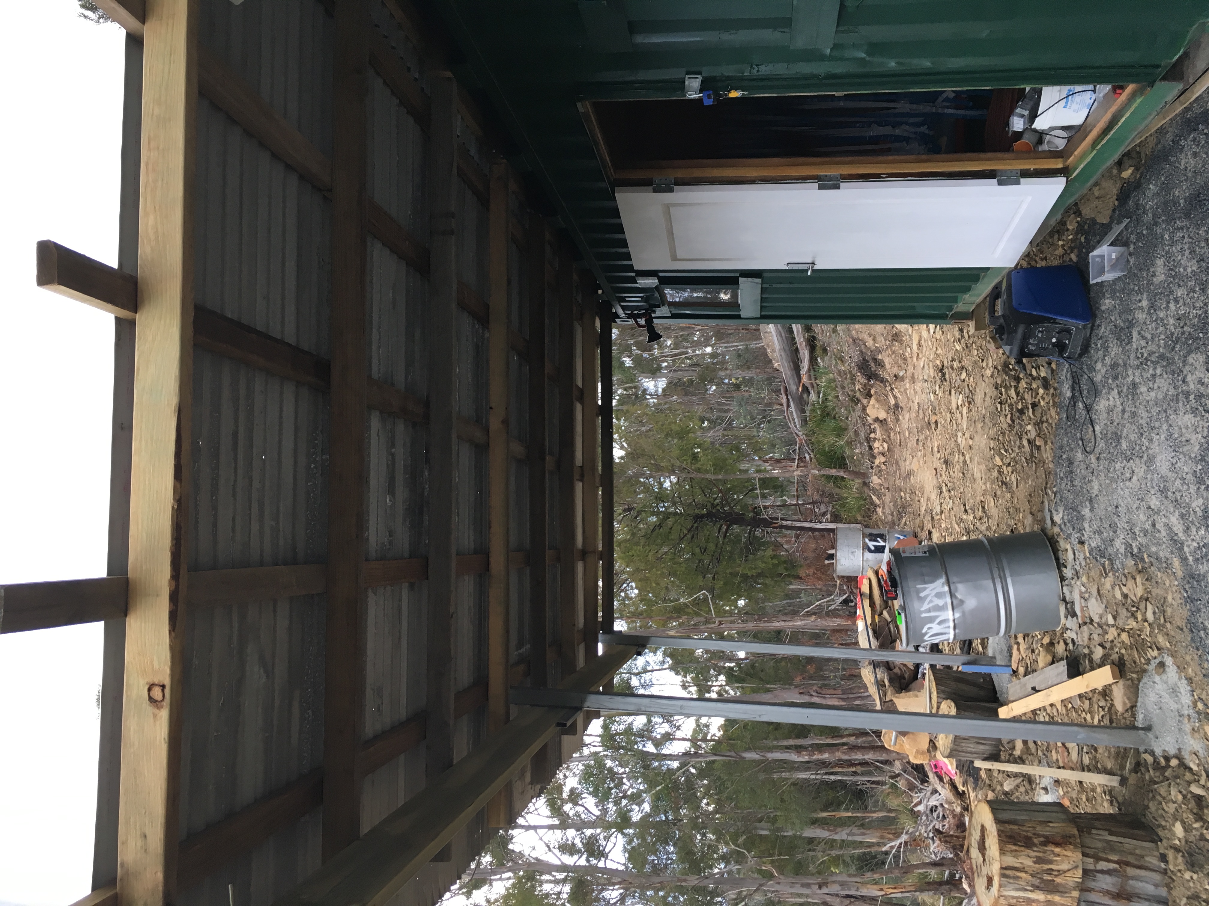

Post by TassieTiger » 21 Sep 2019, 9:45 pm
Worked from 6-6 on this bloody thing today...getting there.
Picked up a couple rabbits at about 5...one was the unlickirst rabbit this side of Bugs - headshot him at about 85m in gale force winds. I’m not even sure I aimed...lol.
One day, I’m going to clean a rabbit and not cover the back legs in fur...ffs it s**ts me. Anyway. This place is still 3-4 months away from really being set up with flush toilet and fresh water, after that, I’ll open it up to the occasional weekend punter (must be a member) from Enough Gun.
There are rabbits, wallaby, roo, goats, occasional bambi and entire grounds are under a crop protection licence, so bit of opportunity for the stalker.
Anyways - couple pics of the build progressing...thanks to those with previous suggestions and Stix with his previous building advice.
