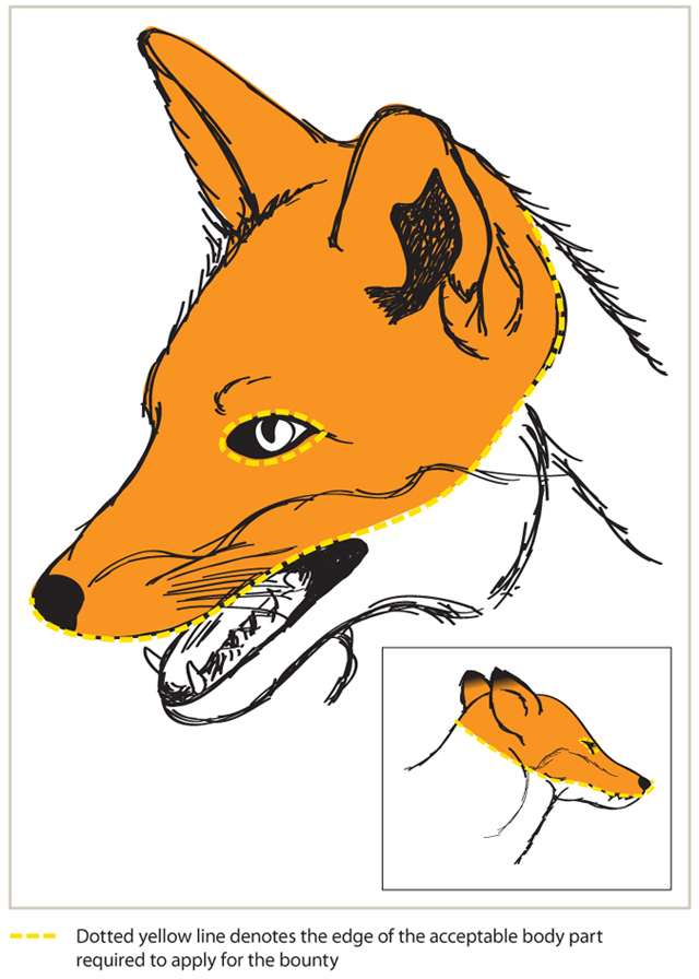

I'm in the same situation as the OP. But sometimes away a few weeks and the fridge is not available. (SWMBO would cut my balls out if I used the van freezer :shock: )
It was recently suggested to keep scalps in a bucket with salt, what do the more experienced think?

This could be a solution for me. Yes, I'll be traveling around. And after a few days of salt staple them to a small board for a week or so?
Problem is the dam things stink so much. I only need to preserve a few i might whistle in to get the $10. Just want a simple convenient solution. I have plenty of coarse salt.

Mate, its only for the scalps.

I was wondering what you were on about. I was clear in my first post. Lol. Changed it to bold yesterday. Said it twice I think?
I'm going to take a very small bucket and some salt. Staple gun and a small board about 300mm square.
3 or 4 days of salt then on the board for a few days. Should do the trick. And keep SWMBO happy. Not sure how much hunting I will do but want to be prepared this trip.
