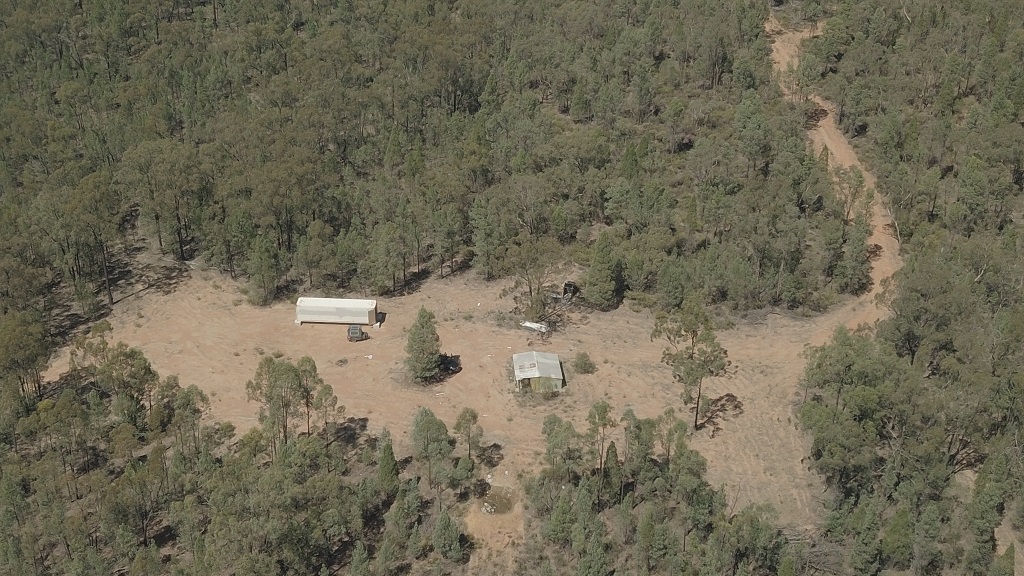

I'm in the middle of a cabin (Container) build at moment, one that is going to be taken to site when finished and placed onto small stumps with a 5 m verandah.
We have built a large outdoor fire pit approx. 5m away from the cabin / container - the container is lined and fully insulated.
What are ppls thoughts on using the outdoor fire - to somehow heat the cabin ??
The thinking is that if I scrounged some old 3' exhaust pipe, and placed an open end of it into / under the huge outdoor fire pit and then snaked that pipe (welded)under the ground a few inches, then came up, just under the floor of the container - back and forth a few times, before exhausting it downwind as to try and get it to draw - would this heat the container ?
Any other ideas on how we might best utilise an otherwise wasted heat source whilst we sleep ?
