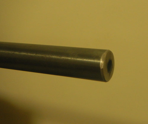

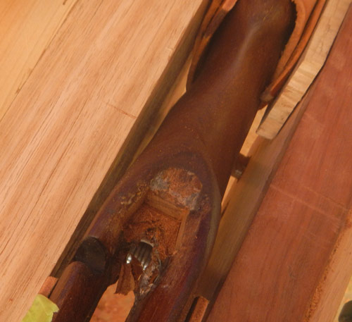

When i first borrowed the rifle off a friend it was suffering somewhat from some very crude modifuckations. Someone had previously taken a hacksaw and lopped off the end of the barrel, including the front sight. I guess that mad the rear sight useless or it got in the way of a scope so the very roughly bashed that off as well. Then, they decided that the crew at Sportco didn't know what they were doing and that the rifle needed an rear action screw instead of just the single barrel lug screw that originally held the steel and timber together. In the process of drilling and taping the rear of the rear (expanding the hole that originally took one of the trigger group screws), they completely screwed up the timber in that area of the stock.
First thing i did was to bed the rifle, which meant i had to inlet a block of blackwood into the stock to rebuild some solid timber around the rear of the trigger group. I also installed a carbon fiber pillar there. Whilst doing this, the crappy screw the farm yard gunsmith had used gave out and i had to re-tap the hole and fit another screw, choosing a high tensile job this time 'round. I got it shooting quite nicely, even with the hacksawed off muzzle/crown, so i refinished the stock with my own little home made potion and sent the barreled action off to a gunsmith near Hobart to be re crowned; he also fixed the trigger which was sort of floating at the rear due to farm yard gunsmithing or 'modifuckations' (Rolf Hey, highly recommend him for quick turn around, good pricing and top notch work!).

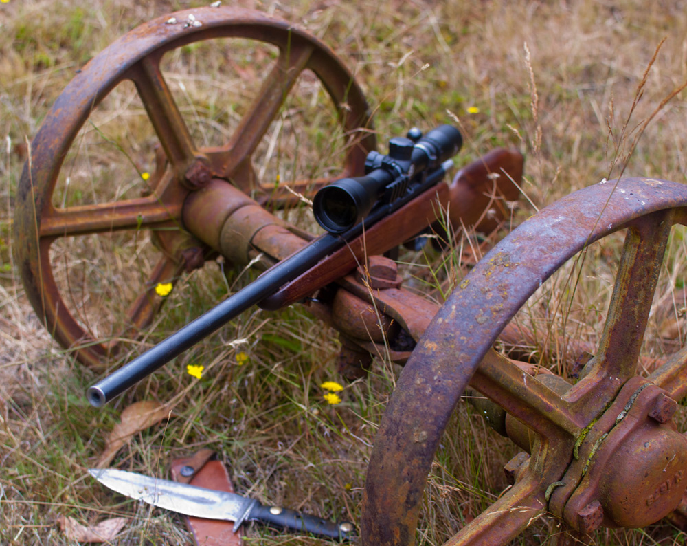

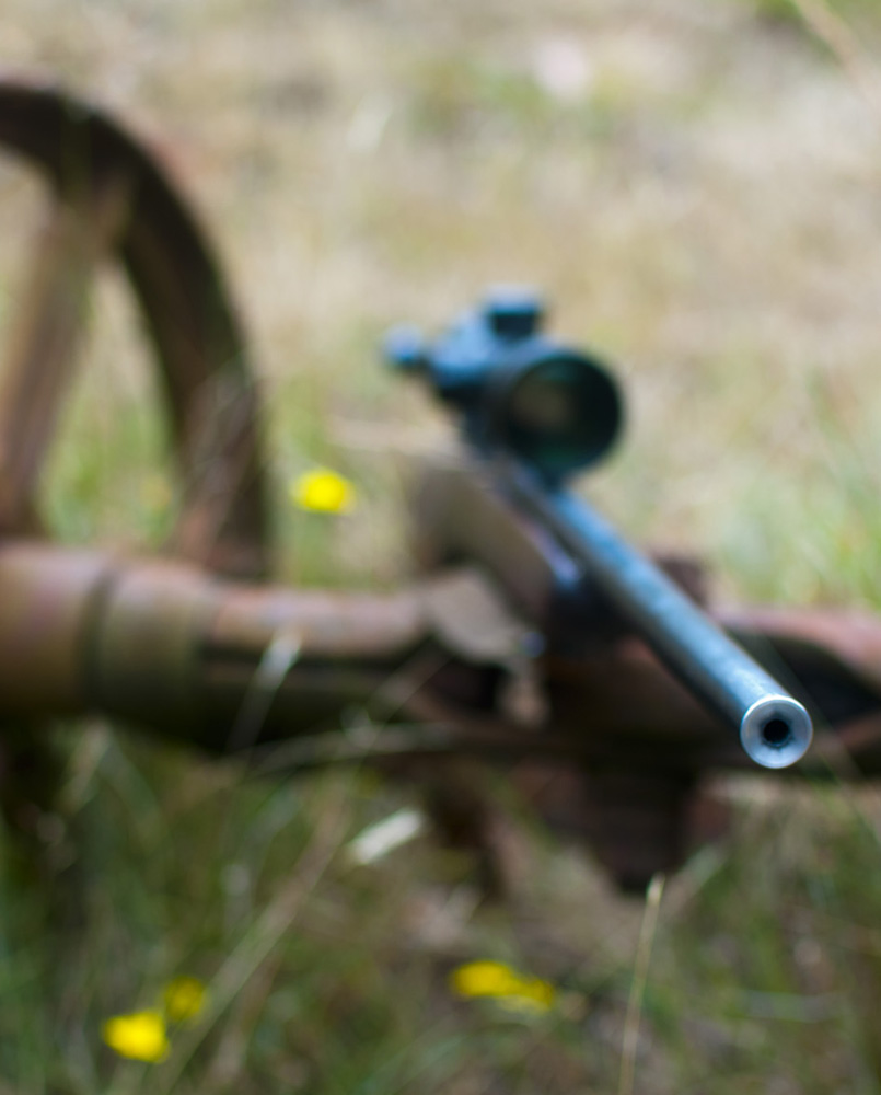

Sporti with scope mounted...
Sportco 62A 22LR 01.jpg (372.16 KiB) Viewed 10051 times
Rolf Hey crown job...
Sportco 62A 22LR 04.jpg (135.83 KiB) Viewed 10051 times

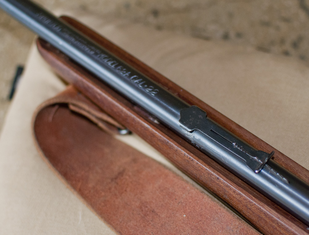

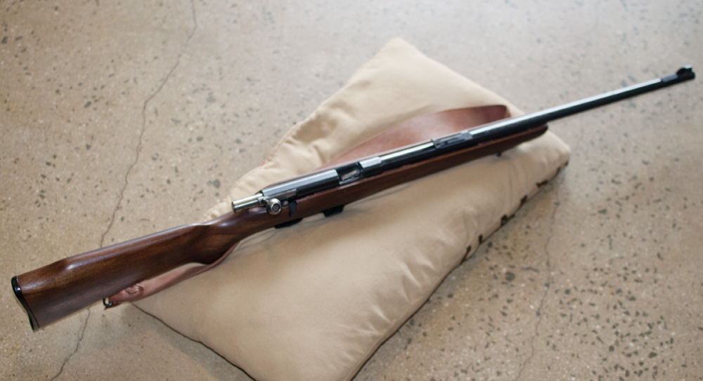

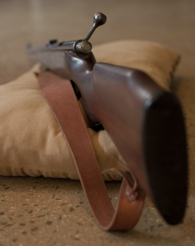

Iron sights fitted... now it looks somewhat more like it originally would have.
Sportco 01.jpg (155.76 KiB) Viewed 10051 times
The old girl... nice and simple.
Spotco 03.jpg (195.88 KiB) Viewed 10051 times
Leaf sights... how do i adjust for windage???
Spotco 04.jpg (233.05 KiB) Viewed 10051 times

Nice job on the old Sportco, Gwion, to adjust windage you will need to tap the rear sight either left or right to get to your zero, I take that it is in a dovetail on the barrel, don't hit it too hard as it won't need to move too far

Strikey wrote:Nice job on the old Sportco, Gwion, to adjust windage you will need to tap the rear sight either left or right to get to your zero, I take that it is in a dovetail on the barrel, don't hit it too hard as it won't need to move too far
Thanks again, mate. Will let you know how it goes.

That looks suspiciously like a lithgow mod 12 rear sight. but looks like the correct front sight.

Hey Dean.... My thoughts exactly. I just asked Rolf to fit whatever he had lying around that would work. If the rifle was in more original condition I might have made more effort to source the correct sights.

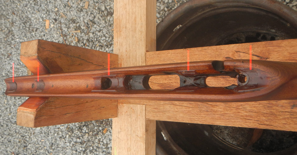

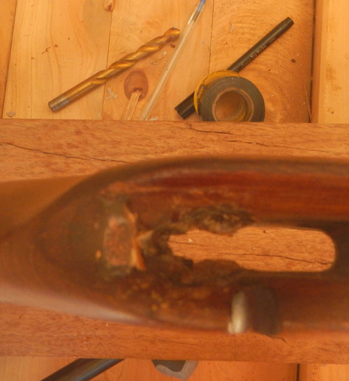

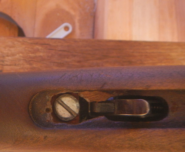

Here are some pics of the state the rifle was in when i got it and some of my efforts to fix it.
Farm yard gunsmiths.......
This is where the "extra" action screw was supposed to be doing it's job....
So i put this....
In here....
To give some solid material for the screw....
And bedded it.
Re: Sportco 62A .22lr
Post by Gwion » 19 Sep 2016, 10:18 am
PS: before anyone says it.... it really didn't like a floating barrel at all, so i pressure point bedded it after experimenting with business cards to find the right points and thickness of bedding. ;)

Sighted it in @ 25m(ish). Took a bit of doing because i started adjusting the wrong way to being with. With a bit more practice i should do alright with it.

The way I remembered for adjusting windage was to imagine the sights aimed directly at the target and the rifle moving. So if you are shooting to the right the rifle needs to move left. Hence the front sight goes right.
Or you move the sights towards the bullet hole relative to the target. Shooting right, drift it right.
Funny one of those simple things that can take a little bit to initially get your head around.
