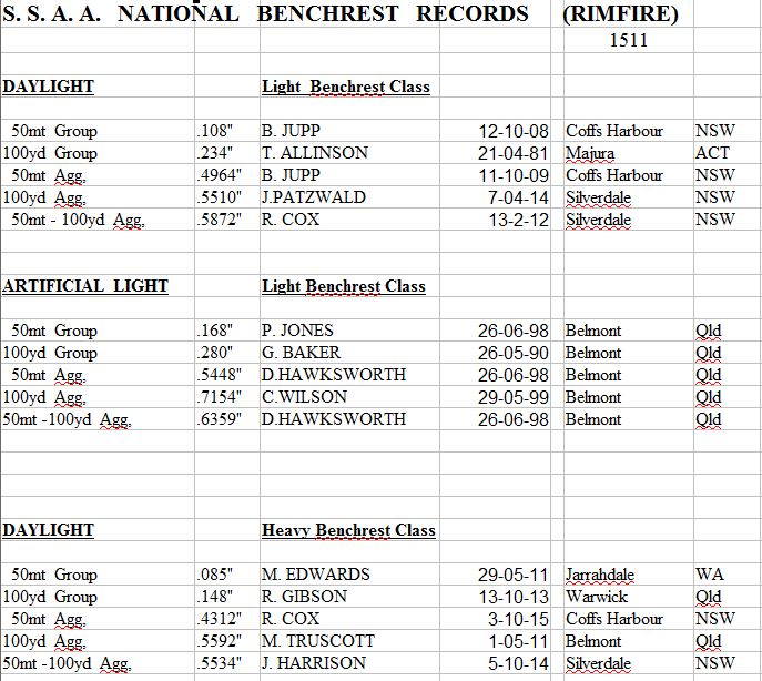

It just occurred to me to see what the practical limits might be for .22LR competition.
I don't know if I'm reading it right but it looks like the SSAA National Rimfire Benchrest records are:
Daylight:
0.108" 50m group (B Jupp 2008)
0.234" 100yd group (T Allinson 1981)
Artificial Light:
0.168" 50m group (P Jones 1998)
0.280" 100yd group (G Baker 1990)
http://www.benchrestbulletin.net/drupal/node/243
That seems to me that no Aussie has managed to shoot smaller than 0.234" at 100yds with a .22LR in the last 35 years, no matter how much money they spend in the attempt.
SSAA Rimfire Benchrest records.JPG (117.21 KiB) Viewed 8443 times

What is the 50mt Agg. stat in those records? Is that an average over 10*5 groups or something? I must also remind you that if firing 10 shots, the groupings do approach 2 inches because it keeps drifting around. And lets not forget that I get very tight groups with the range rifle without much difficulty using eley match ammo. My first mag is often really good with half inch using CCI subsonics but I can't exactly practice at a range at $20 each time just to shoot 10 rounds lol.
