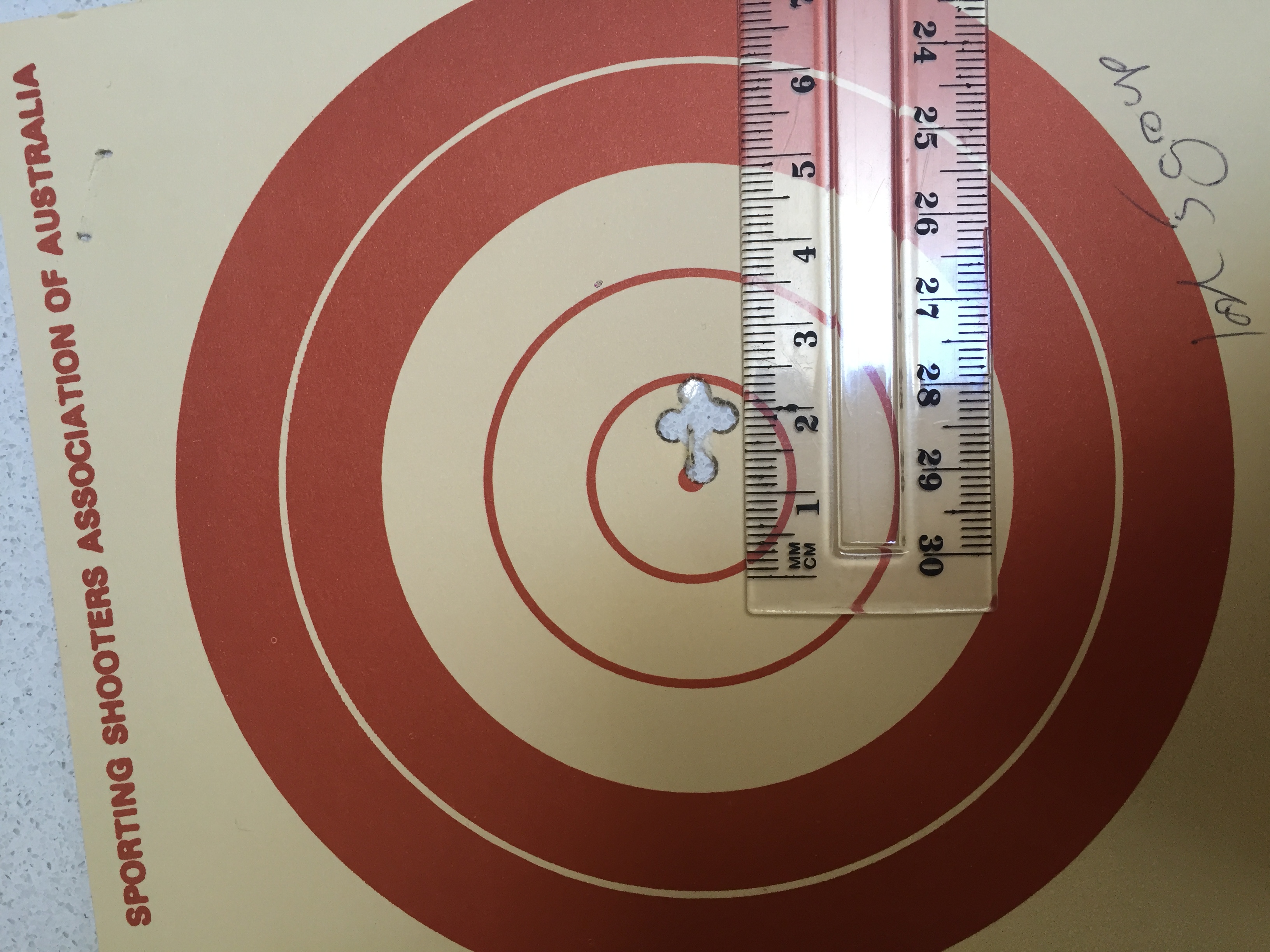

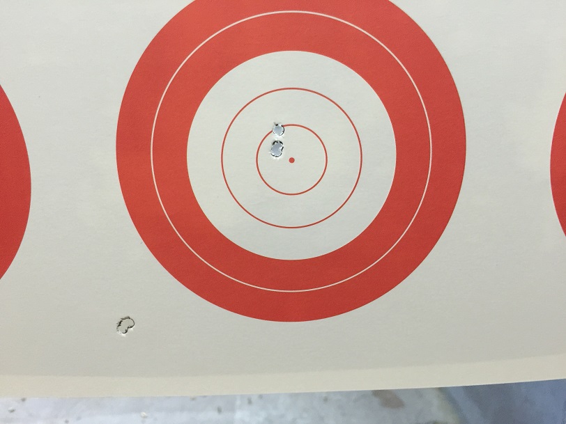

So Sunday was my first day out with the little .17 Hornet, arrived at Belmont nice and early.
I won't bother anyone with the particular barrel break in method I used as each to their own :)
Was a beautiful day for shooting with the wind picking up closer to midday causing some fliers but overall some really good groups once my hands had thawed ( RO said it was 4 degrees )
After break in and some initial sighting in I only had fifteen cartridges left to see how she would shoot at 100m, the wind really blows the tiny .17 pills around and picking the wind was tricky.
My best group of the day at 100m left me wishing I had another three boxes!

Great group John, brain shot on bunnies for sure. Told you they were a sweet little shooter, what ammo we're you using? I was using the 20gr Hornady VMAX Superformance and I've got some 25gr projectiles to load once I get some time. Love the low noise and lack of recoil on this round, perfect for dispatching small game.

Groups look good. I have not fired any factory ammo out of my rifle and chose to reload from day dot. 10.1 gr of 2205, federal SR primer. Approx 3600fps. Easy sub .75"@100m. Am just finishing off the last of 1 k VMax projectiles. My dies for making .172 projectiles have arrived and with a little work I will start making the jackets in the next month or so. I can then compare my home swaged projectiles to factory pills. My jackets are " recycled" .22 LR cases so probably will not be as consistent as the new factory jackets but it will be fun to compare. Hoping I can keep it under an inch.
Please keep us informed as to how the accuracy goes over the long term. I have not noticed any loss of accuracy yet.

Initially sighted in with a box of 15.5gr NTX but the 20gn VMAX really tightened up the groups!
I've got both 20 and 25gn ready to reload, noticed today Hornady have just released a 25 gr HP @ 3375fps imagine it would be pretty effective on bunnies and foxes out to 200m?

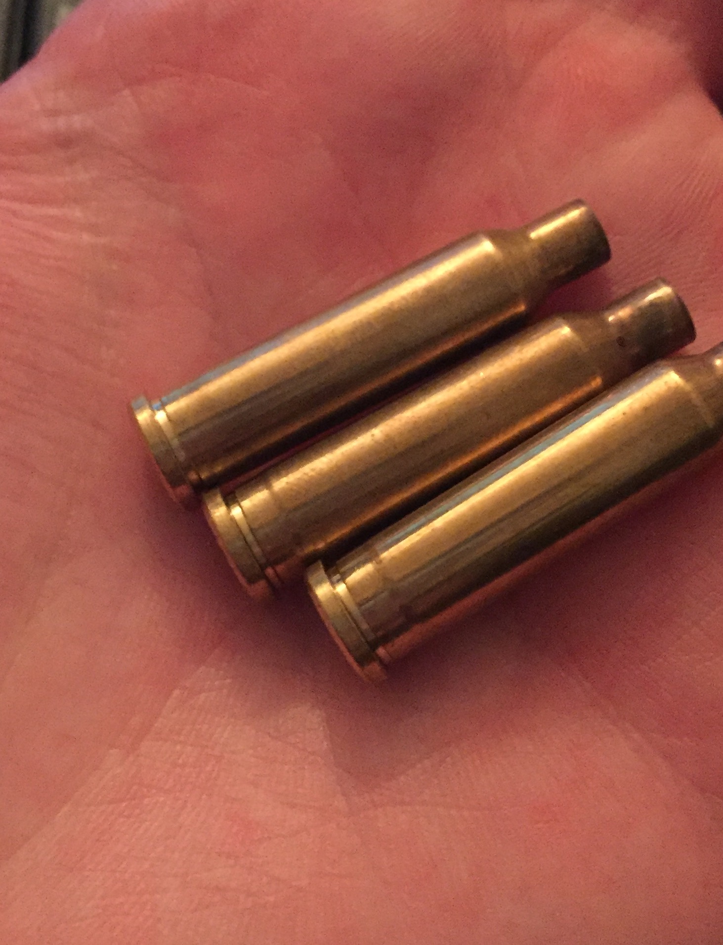

I noticed on the majority of my cartridges after firing an unusual ring towards the case head, any ideas?
I was hoping to use the spent cases for my first foray into hand loading.

I may be corrected but the ring is where the web inside the case thins out and the case just expands to fit the chamber. Fairly normal. Unless pressures are mild.

Oldbloke is spot on about the ring . Nothing to worry about so long as it is not excessive. That is the point where you get case-head separations when things go wrong. Just shows that your chamber is a bit bigger than the cases were sized. Don't go to town with full length resizing to get rid of it though. That will lead to premature case failure at that point.

A couple of my previous Hornets did the same. No biggy. Normal. I did not FL size either. Just neck. Again as mentioned just keep an eye on case seperation.

After sorting through the spent cases exactly 25 don't have the ring which I'm assuming is the first box of ammo I put through the rifle ( 15.5gr NTX )

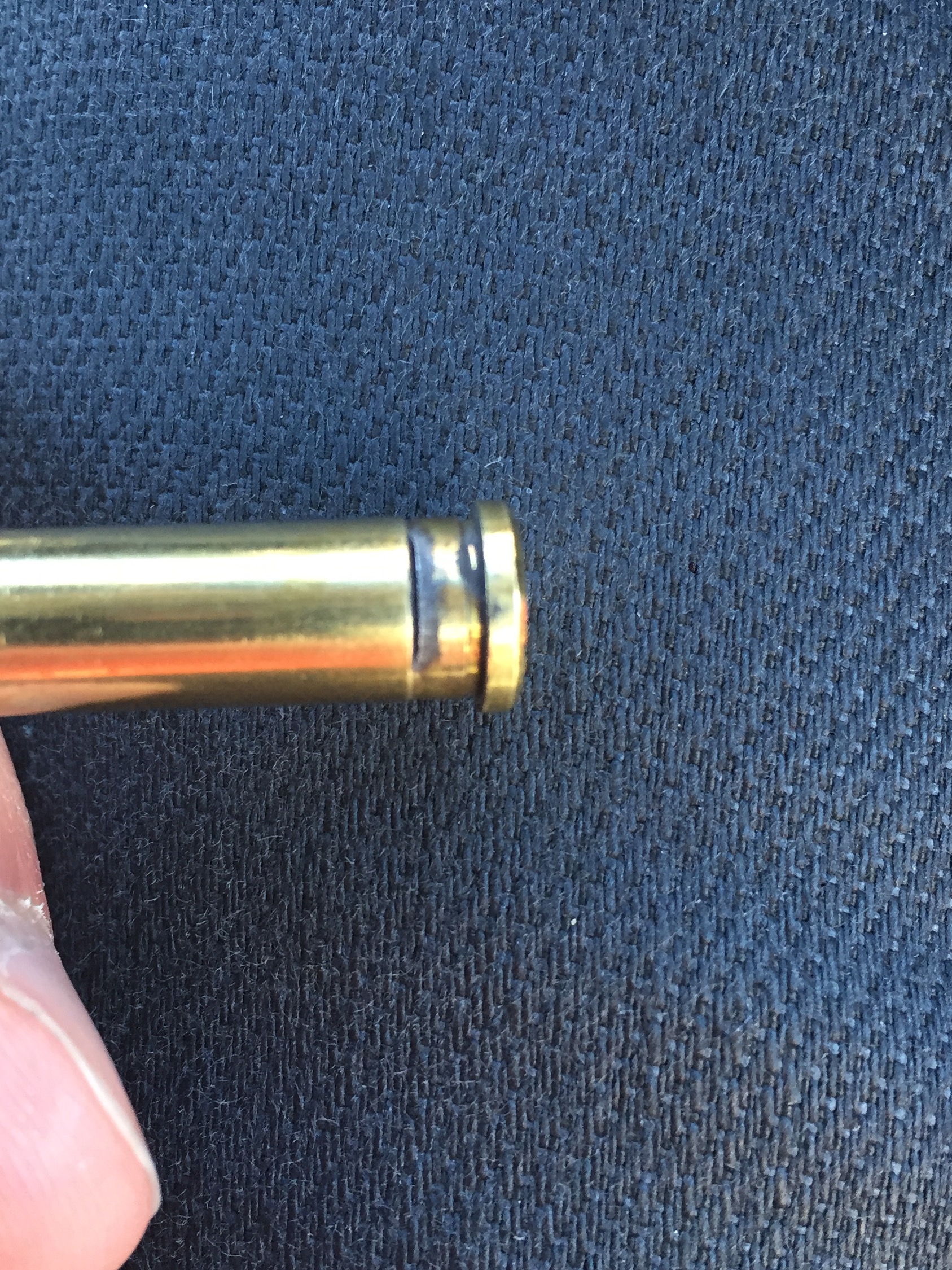

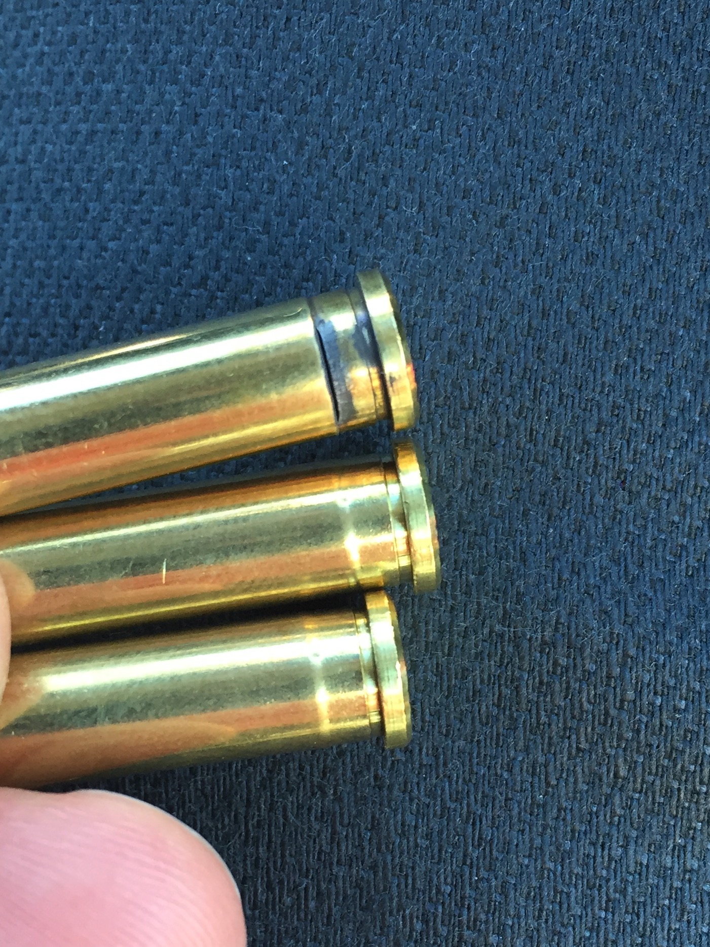

So today I had a case head separation at the range
Three boxes of Hornady Superformance 20gn
two boxes of the same batch number have brass colored primers and one box had silver colored primers with a different batch number.
My mate has a savage chambered for the 17 Hornet so we organized a little competition between us :D
Every round with the brass colored primers had the ring around the case head after firing as I have posted above however halfway through a box and bang...face full of hot gas!!
Same rounds fired in the Savage exactly same result visible ring around the head, compared to rounds with silver color primer no visible deformity either after being fired in both rifles.
The batch number of the affected rounds is 3151646
I took my spent cartridges and the remaining rounds left back to my LGS I purchased them from they are going to notify the distributer but didn't seem at all concerned .

I just purchased another 527 varmint in .223
It was an ex demo that was literally half price so i couldn't resist.
Shot her last weekend and no problems.
Magazine feeds smoothly all five shots, after barrel break in the groups tightened up considerably and everything smoothed up a bit more.
Considering the recoil is more than the 17 Hornet that i'm used to shooting a few flyers were definitely my fault and i found i need a better rear bag.
