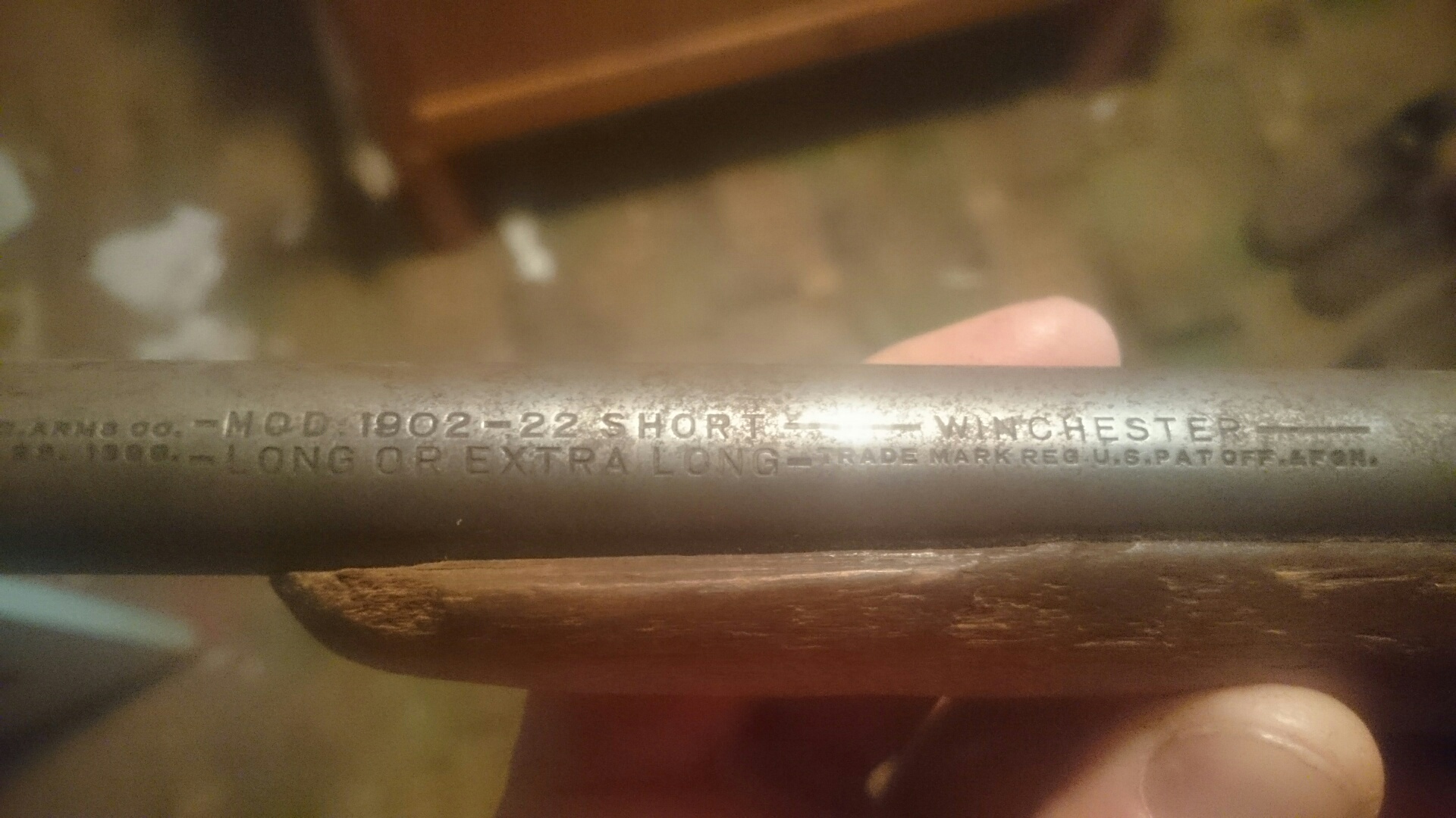

I have come across a Winchester model 1902. It is stamped with 22 SHORT LONG OR EXTRA LONG.
Is this rifle suitable for shooting 22LR?

Gday roofarmer
A mate has a 1904 that he uses lr in and it's stamped the same as the one in the photo. :drinks:

Post by No1Mk3 » 29 May 2018, 5:56 pm
G'day Roo farmer,
The Extra Long is NOT the same as the current LR cartridge, it is an obsolete black powder round from the turn of the last century that was actually more powerful than the 22LR, from which you can gather that 22LR is perfectly safe in your 1902.Play around with cartridges of course 22's being what they are, but I find subbies seem to work best in my 1902, either Winchester or RWS Field Line, enjoy!

Post by No1Mk3 » 29 May 2018, 6:00 pm
Just an addendum, I wouldn't use Stingers in my early rifles like the 1902 and 1904, Lithgows etc.
