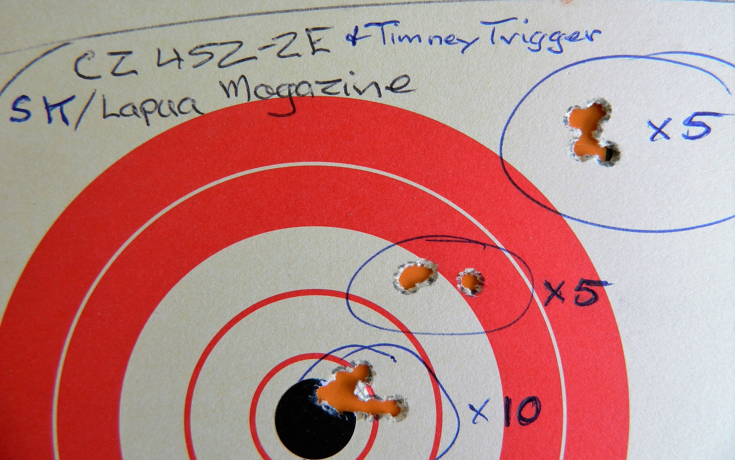

Post by Homer » 07 Jun 2018, 6:34 pm
G'Day Fella's,
MJW380, here are a couple of groups I shot with my CZ 452, with SK Magaizine ammo.
CZ 452-2E .22LR.JPG (1.87 MiB) Viewed 10220 times
Hope that helps
D'oh!
Homer
Homer

Post by MJW380 » 08 Jun 2018, 9:54 pm
Hey Homer, is that an Atlasworx trigger guard? What’s it like?
MJW380
Posts: 92
Re: What ammo works in your CZ 452?
Post by Homer » 09 Jun 2018, 6:36 pm
I can't remember MJW380 but iirc it was made by a bloke in Queensland.
