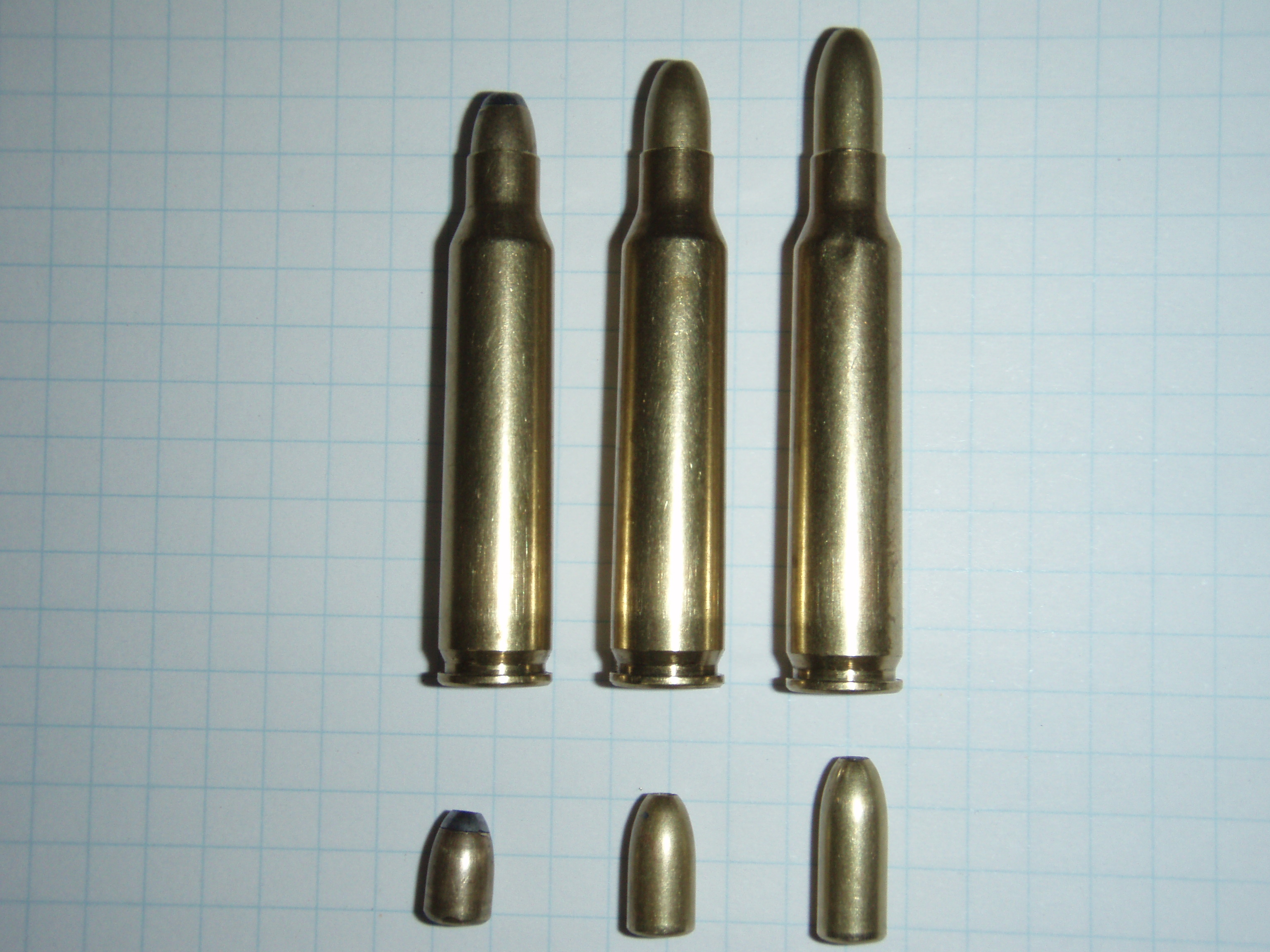

We are not comparing the 223 to a 22 mag just saying that you can load a 223 down to 22 mag velocities at a cheaper cost than feeding a 22 mag.

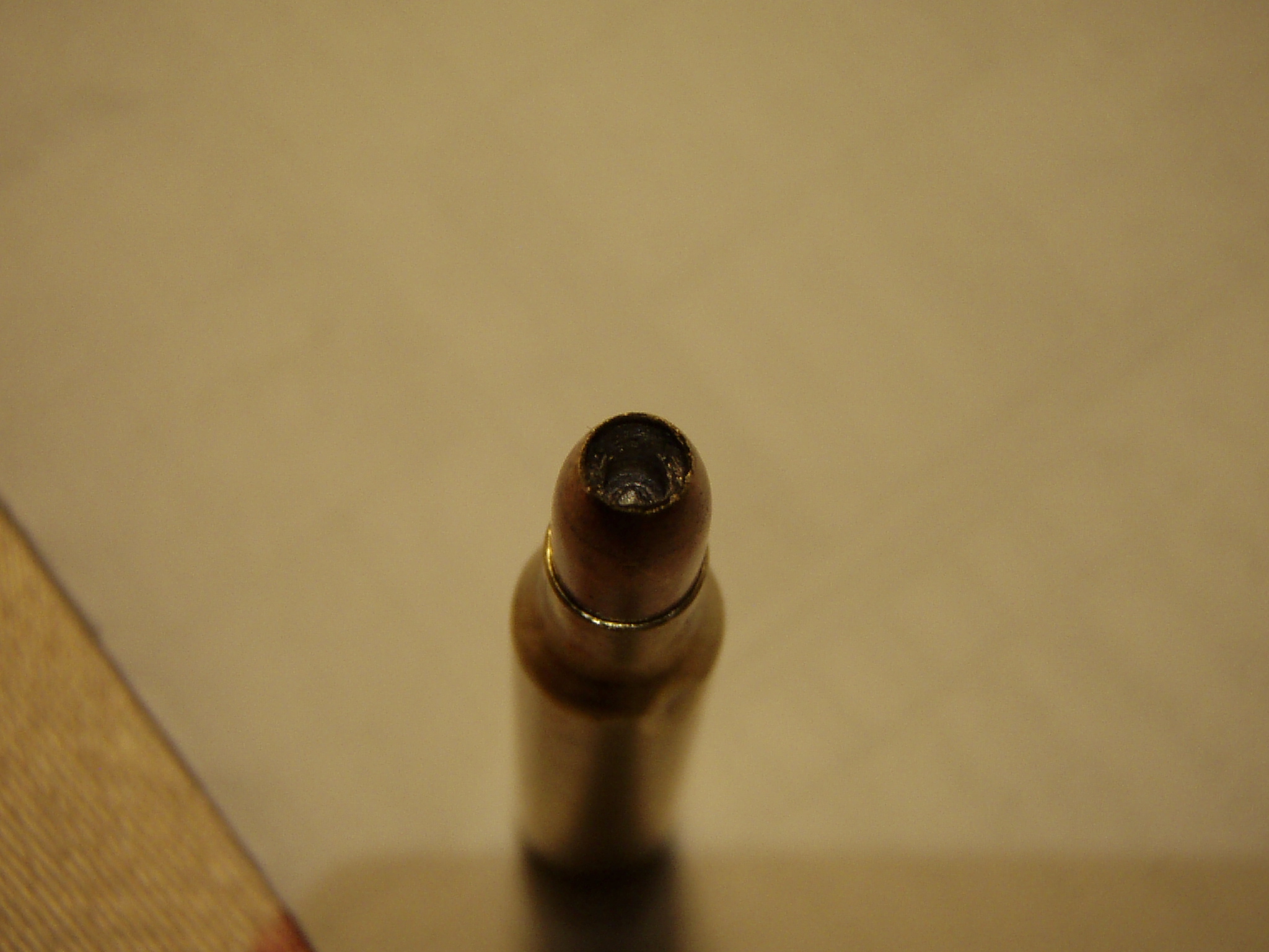

I have finally got my .224", 40gn RNFB projectile right and it is a cracker. I made it a hollow point core in a open tip jacket. It just disintegrates even at low velocity <2000f/s. I tried it with a full load of TB at 8.4gn but it did not like it and 8gn was far better. Turns out the drop from 50 - 100m is minimal once I zeroed it properly for that projectile. Very cheap to run.
Bill
30 SPRN, 40 and 55gn round nosed
40 gn with a deep hollow point in the core
