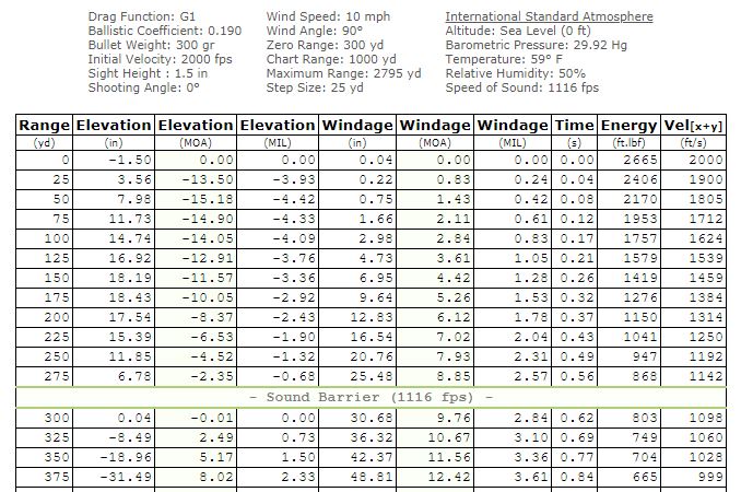

Yes, I ran the numbers for a 115BC 40gn at 1080fps and a 190BC 300gn at 2000fps. The .458" bullet has four-times the frontal area of the .223" bullet, and dumps 900fps by 300yds compared to the .22LR only dropping 365fps.
At 300yds in a 10mph wind the 40gn is deflected about 12.5MoA, and the 300gn about 10MoA. Drop some velocity or BC with a flat-nosed bullet and the wind deflection would be even closer, but I'm sure there are .22LR bullets that can improve the ballistics as well. I think they're within the ballpark for practicing. Even the trajectory is within 200mm or so at midrange.
Yeah but windage knocks the lighter pill around a helluva lot more
Do you mean more than what the software indicates? We're talking 900mm for the 300gn and 1125mm for the 40gn at 300yds. That seems close enough to me that velocity and bullet choice could push either one ahead of the other.
I think you are right Blade - I stand corrected. That’s crazy!
