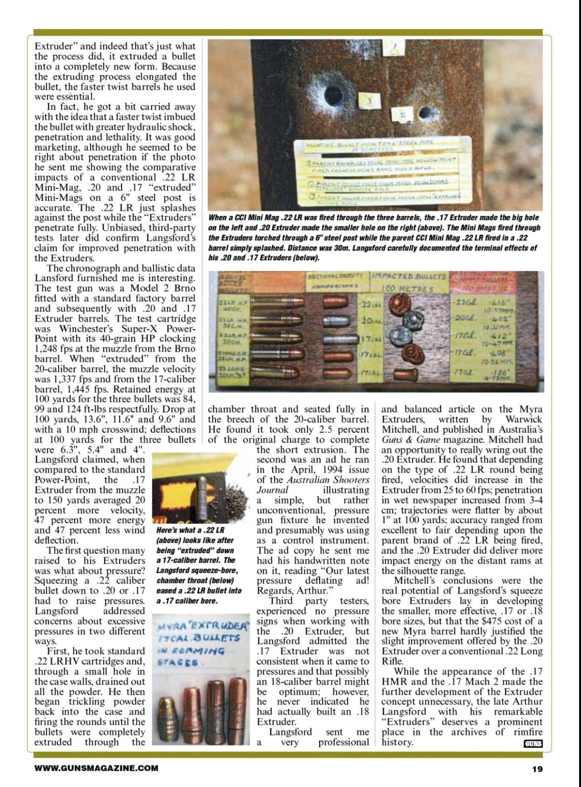

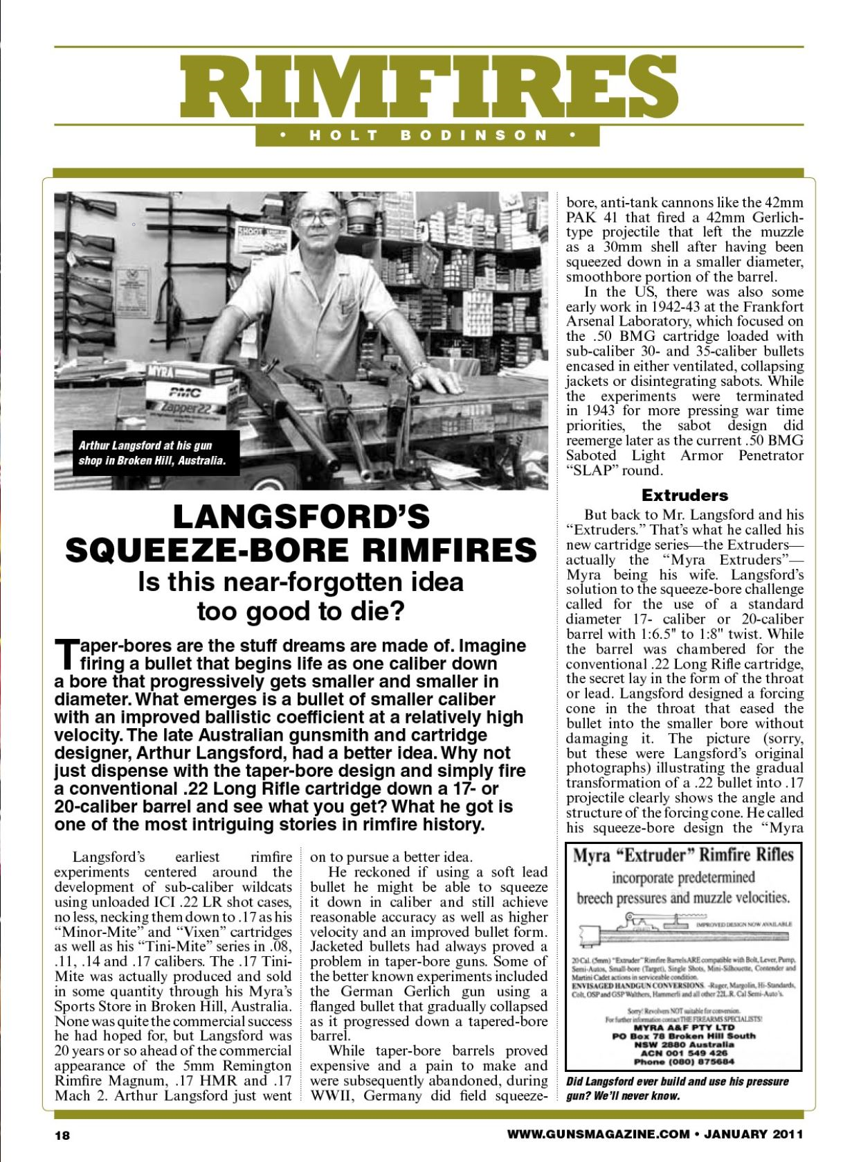

Post by marksman » 24 Jan 2019, 9:25 am
here is the same as No1_49er has posted but with pictures from pg 18
http://fmgpublications.ipaperus.com/FMG ... ?page=18#/
I really like the idea of it and want one as well :drinks:

Re: Myra Extruder
Post by bladeracer » 24 Jan 2019, 12:33 pm
marksman wrote:here is the same as No1_49er has posted but with pictures from pg 18
Langsford squeeze bore rimfire 1.png (1.56 MiB) Viewed 7043 times
Langsford squeeze bore rimfire 2b.png (1.9 MiB) Viewed 7043 times
