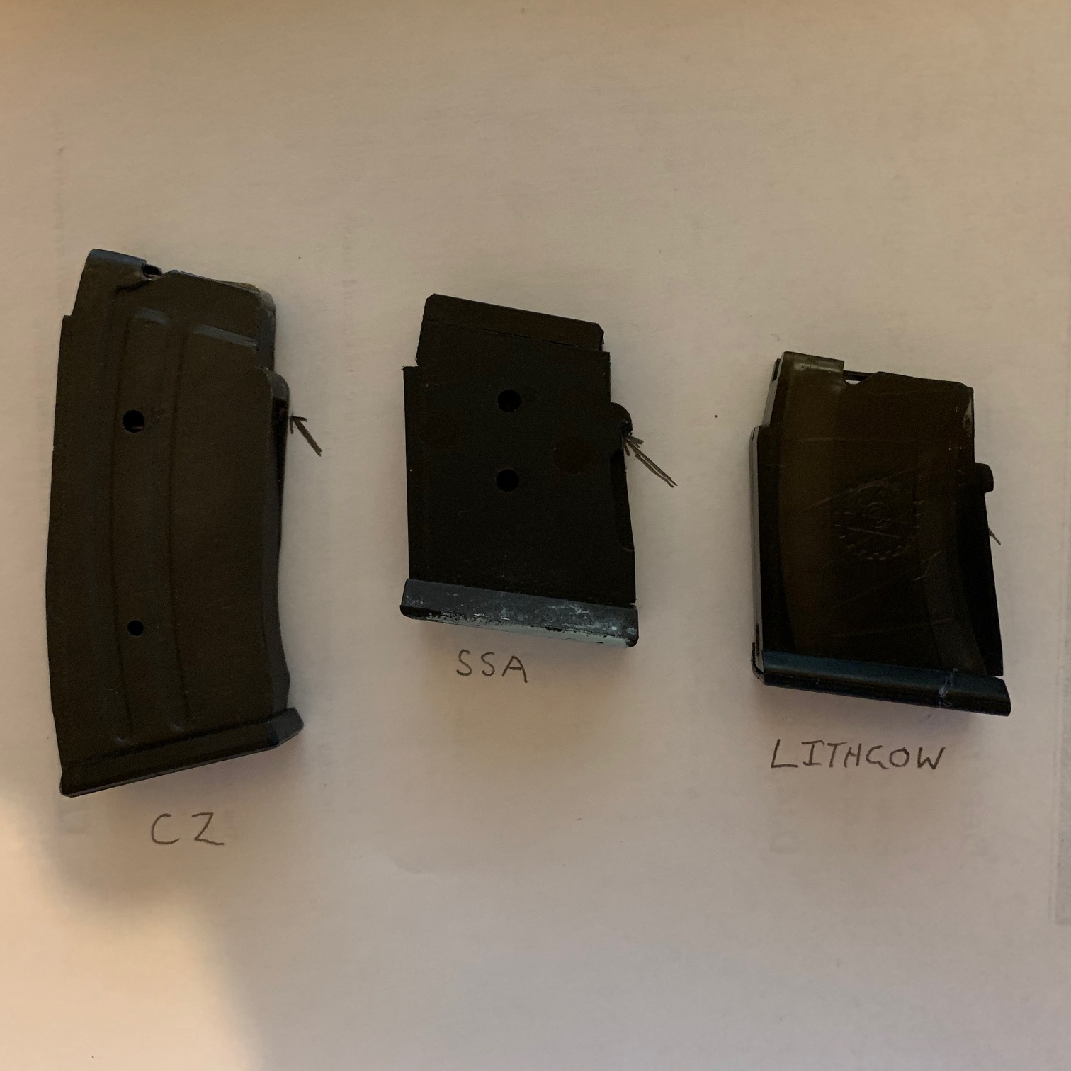

Third and fourth paragraph in OP. Then read what Wylie27 had to say about altering the front mag lug. I made that alteration slowly-slowly, and the CZ mag now "clicks" into place positively, even with the bolt closed.
Re: Cz 22lr magazine not fitting in cz 455, can a gunsmith f
Post by bcr83 » 26 May 2020, 7:58 am
in2anity wrote:https://enoughgun.com/forum/viewtopic.php?f=2&t=6527
Are you able to share what the mag body looks like? Is it the same as the 15 round ? My one won't even slot in with the bolt open.
Edit: I've gone through all the posts and I've worked out what needs to do. I guess the only question is the shoulder of the mag body looks different than the 10rd, it also doesn't go in with the bolt open either. Did yours go in with the bolt open??

Post by bcr83 » 26 May 2020, 8:03 am
This is the pic of the 15rd

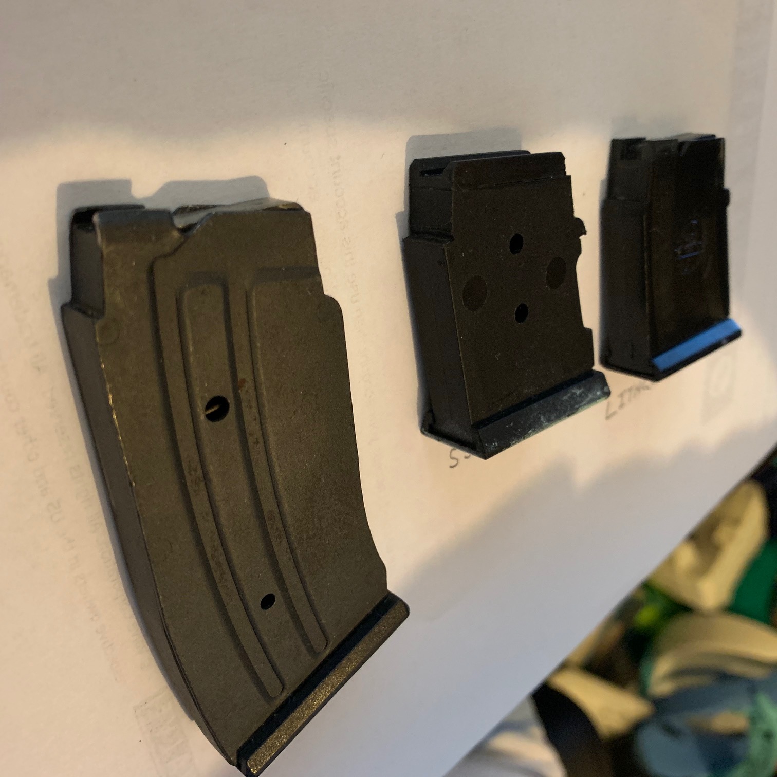

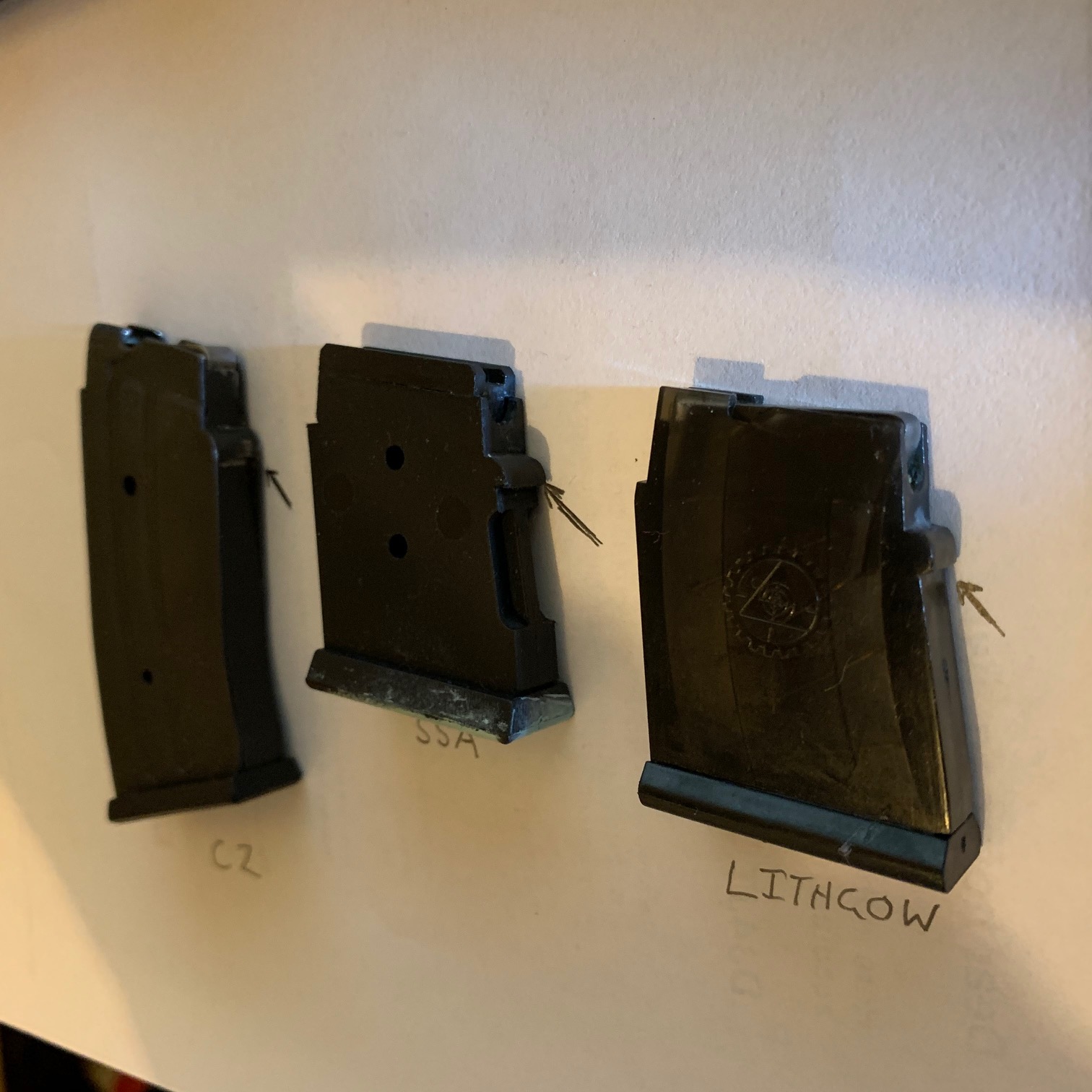

Post by in2anity » 26 May 2020, 9:03 am
bcr83 wrote:Are you able to share what the mag body looks like? Is it the same as the 15 round ? My one won't even slot in with the bolt open.
Some pressure saw the original CZ magazine go in with the bolt open.
Slight relieving of UNDERSIDE of the front lug on the CZ 10-shot mag ONLY.

Post by bcr83 » 26 May 2020, 9:42 am
Thanks heaps mate for posting this, looks like my 15rd is thinner but uses the shoulder area to fill the mag well. Might take a file to it and see...

Post by in2anity » 26 May 2020, 11:20 am
Welcome bud. At the risk of stating the obvious, if you're taking material off the top, then you don't want to also be taking it from underneath? One axis at a time, and go real iteratively, testing constantly.
