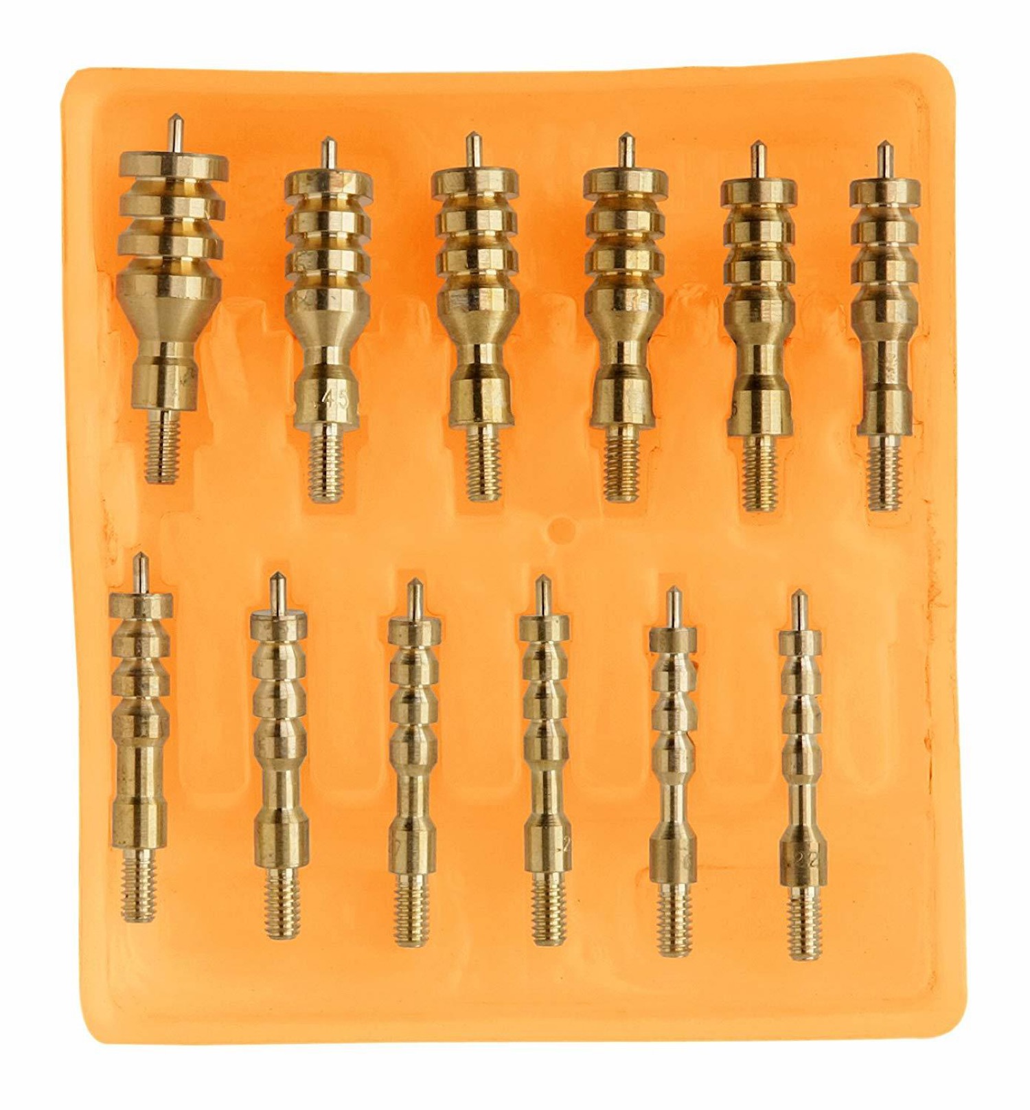

Post by JimTom » 29 Sep 2020, 2:46 pm
Mate these are the jags I am talking about.

The size will be determined by thickness to some extent, thicker material will need to be cut smaller, and the style of jag.
I bought thousands of pre-cut patches on Ebay years ago, and rolls of four-by-two. I just checked and both are roughly 15-thou thickness (about 0.4mm). I use roughly 32mm-squares for the .22's, or folded in half to double them up for bigger stuff. My rolls are actually marked at 45mm, not two-inches, but I ignore the lines anyway. Just cut 32mm strips then cut those into thirds.
The cylindrical jags will jam with thicker patch material, or too-large a patch, but the slotted jags can handle more material.
