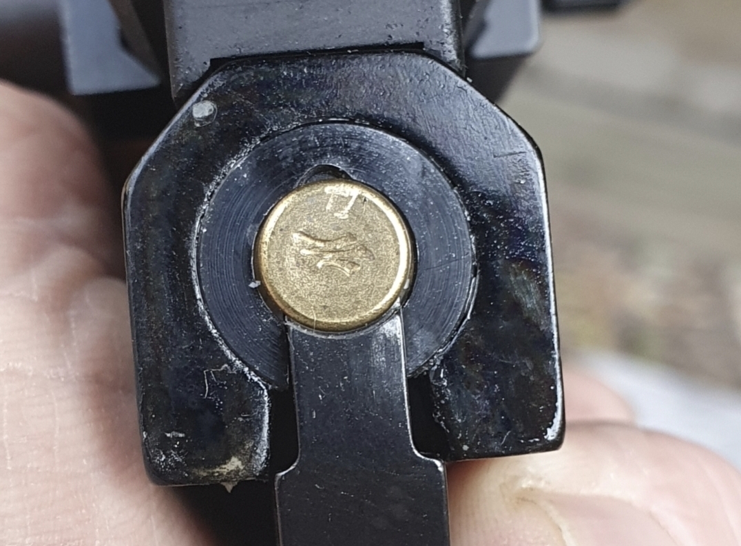

Just got my first 22 a Chiappa Little Badger in 22lr. Primer strikes are very very light and seem to be off centre from where the notch is. Some rounds won't shoot and some will but seem to be kinda "slow burn" or quieter than another rifle. At the moment it takes about 5 tries just to shoot one bullet.

More importantly is the evidence in the photo you posted. That rifle has been dry-fired extensively , resulting in a monster crater at the edge of the chamber. Without additional photos, it appears that the round is not fully home in the chamber.
Might be hard to argue with the vendor though, because the damage was not observed at point of sale, at which point you could have rejected the rifle as being used (abused).

I;only just looked closely at the photo. Assuming that mark is where the firing pin is, that would need to be a lifetime of dry firing, not just a few times in a shop. Or it’s incredibly soft but that is definitely a fault.

No1_49er wrote:More importantly is the evidence in the photo you posted. That rifle has been dry-fired extensively , resulting in a monster crater at the edge of the chamber. Without additional photos, it appears that the round is not fully home in the chamber.
That crater as you call it is how the rifle comes, it's a feature to protect the firing pin.
The issue it seems with the OP little badger is the firing pin seem out of alignment with the indent.
My firing pin lines up perfectly in the centre of the indent and I have never had a miss fire with any ammo.
Take it back to the dealer for a replacement.

dreysi wrote:Just got my first 22 a Chiappa Little Badger in 22lr. Primer strikes are very very light and seem to be off centre from where the notch is.
The mark on that brass is clearly not in the right place or shape and there's no marking on the chamber that would suggest that's getting hit so I'd suspect a defective or broken firing pin.
Are you able to get a close-up picture of the firing pin tip? It would be interesting to compare with somebody that has a working model.
I've seen intermittent firing on a rimfire with a firing pin that was broken in two so only worked when the front half happened to be aligned correctly, the rest of the time it wasn't protruding properly so made light or no strikes. Maybe a strip down and removal of the pin would be worthwhile if you can't warranty swap it.

But, if that is a feature to protect the firing pin, why the heck is the pin aligned in such a way as to strike outside the area of the rim? And on a slant! The impact mark is not at 12o/c but about 12:30, almost 1o/c. Definitely not right.
Seems to be a firing-pin problem in that it cannot, for whatever reason, travel fully forward in its "race-way" or is being impeded by something such as fouling or machining "dags". Only a strip and close inspection will reveal.

Ended up taking it back to Shooters delight, telling them 4 types of ammo tested had the same sad result. The guy was great and said he'd give it to the supplier do just have to wait now.
Have inspected the firing pin but could not see that it was broken however,,, it wouod change angle so could be broken. I was very careful not to dry fire and instructed anyone who handled it no no no dry fire.
I'll hold my toungue until supplier gets back to the store. At the moment i own a brick, and would be frustrated having to hope and pray for every shot. Also some ammo just won't fire at all, this makes ke nervous because it still gets pounded a little. Anyway I'll just have to be patient.
Of note was that some "successful" times the rifle would fire it seemed some rounds sort of fizzled and sounded quieter than same ty0e of rounds fired from dad's 22.
I was not able to photograph the firing pin prior to handing it back.

So just to close the case for anyone interested and for future reference. The supplier could not fix it so i have a brand new one. Shooter's delight and the supplier had the issue resolved within 2 weeks of me taking it in, good service.
Didn't ask the reason as they were super busy wjen i took it in and didn't want to bother (although the guy did ask if there was anything else). Thanks to those that contributed and helped out in this thread.
